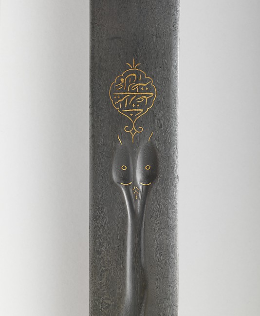

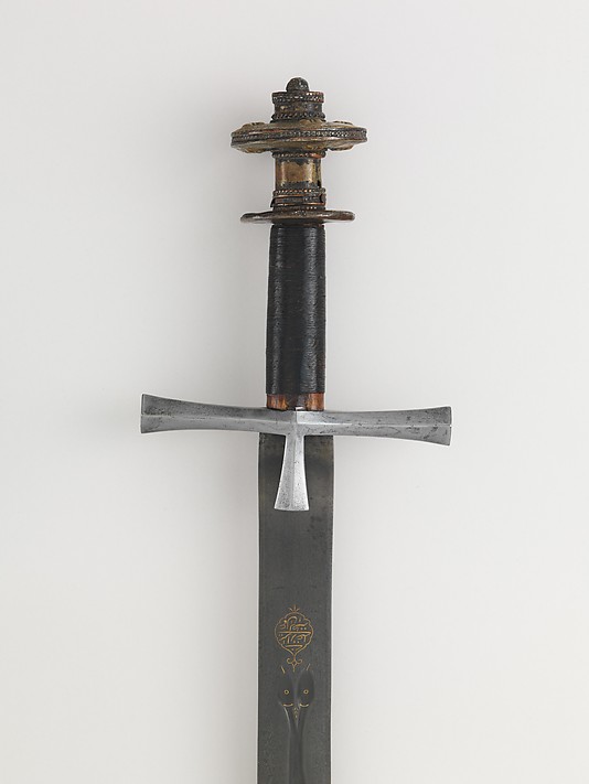

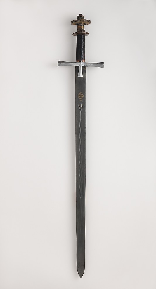

I think this could make for an interesting topic. To start it off, a sword from the MET. I'd seen poor quality images of this piece before but it seems since I last looked very clear images have been made available online. I am attaching them here.
The blade is wootz with the fuller taking the form of snakes with the heads terminating hear the guard. Anyone have any idea as to the age of the blade?
The hilt is also quite unusual in form with two discs in the pommel.
These seem to be a fairly rare kaskara subtype. I would love to find one myself someday!

While the hilt and double pommel discs are interesting to be sure, I am more fascinated by the superb quality of the wootz blade.
For me it is even more proof that wootz can be found even in the least likely places in the Islamic world.
Thanks so much for these pics Iain.

Orez Perski shows a similar blade, figures 101a & b as 18th century...personally though I am not convinced this is that old of a blade though.
The sword appears to be fully museum conserved too...kinda would have liked to know the scabbard fittings as the pommel is real interesting.

I checked through my notes on this one. According to Nickel, likely collected after the Siege of Omdurman and acquired by the MET along with several other very good swords.
It seems to be 19th century Qajar revival. The cartouche reads Ali of Shiraz the maker, on the opposite side the name and title of Sultan Nasir ad Din Shah Qajar (1848-1896).

Those dates and the Qajar attribution help explain both the type of wootz, and the snake motif....both more common on Qajar era pieces.

An item such as this sword blade seems perhaps most likely to have arrived into the Sudan as a diplomatic gift. Perhaps it is also within the realm of possibility that some Sudanese would have journeyed to Persia in the 19th century due to the shared religious connect of both areas being Shi'a.

Hi Iain,
Could we say that this particular sword is indeed not a kaskara? While the blade is magnificent, it has a tapered profile and is narrower than the traditional form. Kaskarae as we know them use either trade, or local cast or forged blades not wootz. The only attribute that would point to kaskara is the cross guard, certainly not the double pommel.

I would consider this a variant form, and the hilt elements reflect good degree of similarity to kaskaras from Darfur regions (Reed, 1987). The blade itself is certainly an anomaly, but the term kaskara itself is a derivative term not used for these broadswords locally as they are termed sa'if as I understand.
