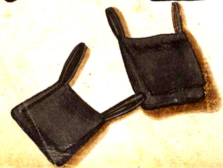

2. arquebusier's girdle side bag holding the ammunition, mainly the powder and some cloth to wipe off the gun or, wadded, act as a wad to keep the usual sub-caliber (!) balls from rolling out of the barrel, and the cleaning tools
3. girdle leather side bags for powder for arquebusiers, by Jörg Kölderer, ca. 1497-1502, from the 'Maximilian Armories' books

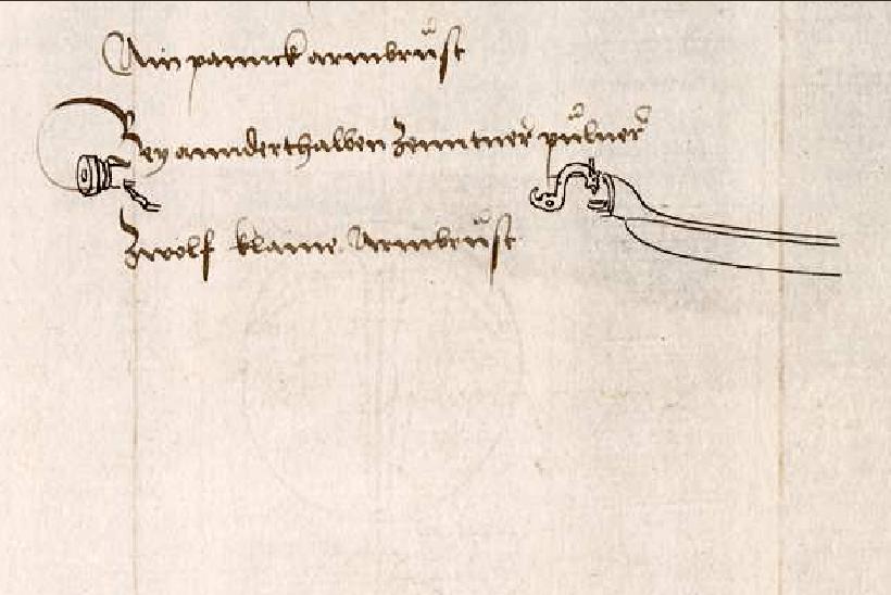

As the tinderlocks are not clearly shown in the painting of the Battle near Orsza, I posted some good illustrations here:
- by Diebold Schilling, from his Berne Chronicle, 1483: not very exact, either, as the top of the serpentine holding the piece of tinder is not shown at all
- by Jörg Kölderer, from his illustrated Maximilian Armories Inventories, ca. 1502-07: very exact details!

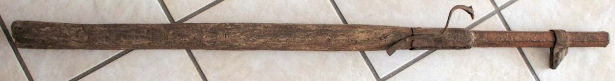

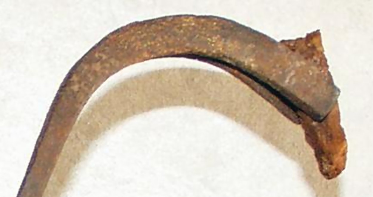

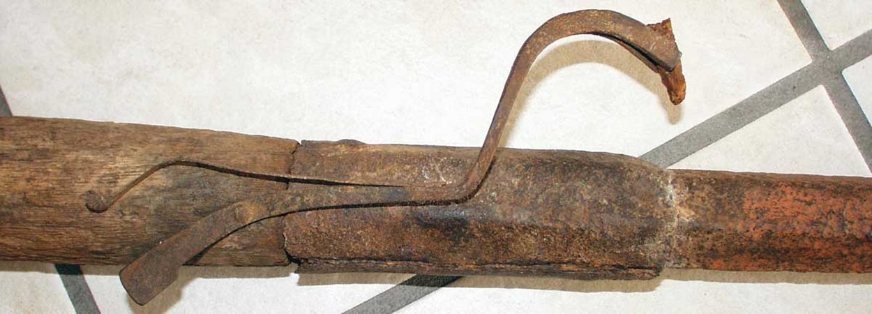

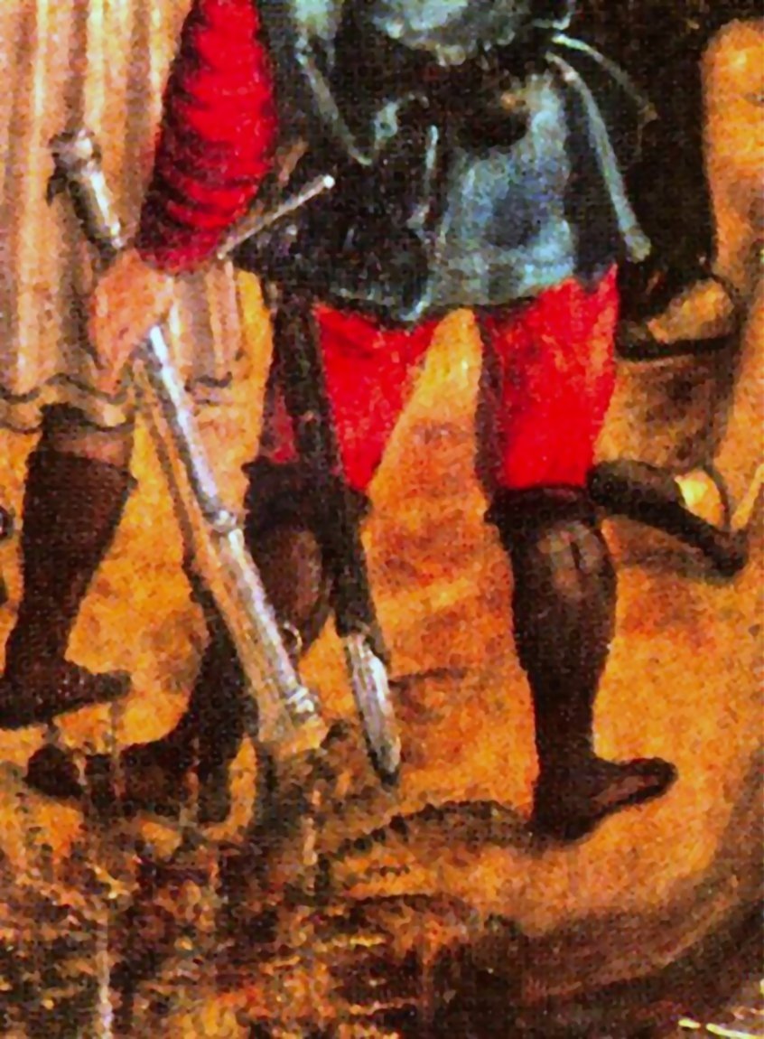

And a detail with a piece of old tinder in the serpentine, of the oldest known complete long gun in existence, ca. 1400-10 (!!!), in my collection.
The watercolor is dated 1411, from the famous Cod.Vind.3069 (Vienna Library).
Michael
