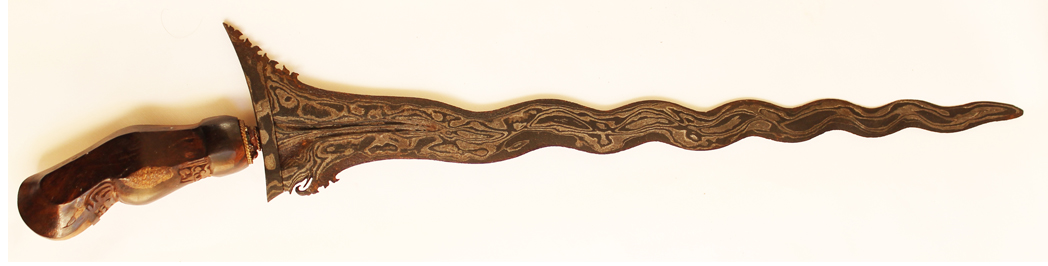

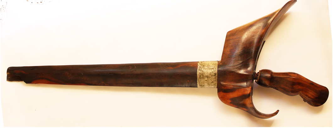

This 13-luk keris just arrived from a dealer in Singapore. The Pendok (Hey! I'm learning a new language) got damaged in transit or during packing but I do like the blade.
After reading the previous post on an interesting keris from auk I wonder if I will ever know anything about this field. Well, my excuse around the house is that, at my age I need to get the brain learning new things.

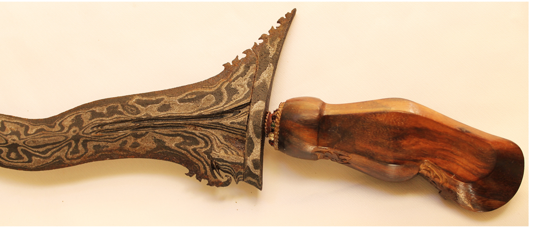

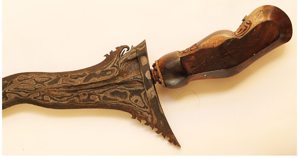

So here it is. I am told it is a "keris Jawa Timur Luk 13 Pelet", 19th century. I can see it has 13, or 11 depending on how one counts, waves but beyond that I am in darkness. The pamor was said to be in the melon's skin variation (kulit semangko)
It is covered with a fragrant oil & came with two small containers of oil, which I presume has traditional significance but know no further. Except not to lick the blade.
So, gentlemen, what might your comments be?
Whatever it is, I am pleased with it.

Congratulations for your new keris. I agree with most of what you've already said, except that from your photos the blade appear like modern blade to me (last 20 c. or even early 21 c.)-- please keep in mind this is just my personal opinion. I like the blade for what it is. The fittings could have been better but I wouldn't change anything except the hilt ring which is Jogja/Central Java style (only if I got a chance/I wouldn't pursue a replacement).
For now I think you have better chances buying from your local market

It is not the pendok (metal over sheath) which got damaged but the gandar (wooden stem). From the pictures the hilt appears of low quality (wood species and carvings).
Best regards
