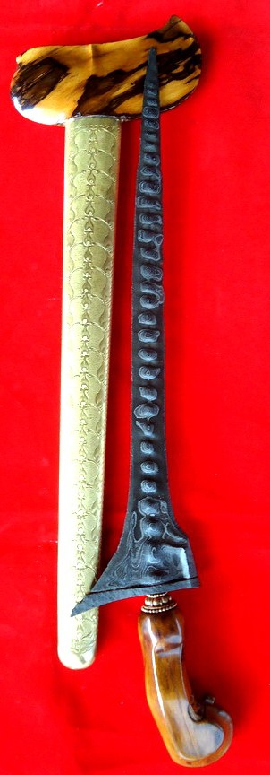

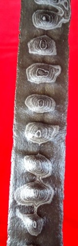

I stumbled upon a pamor called kembang pete. I believe the pete here refers to pete beans, known in English under various names (sator bean, stinky bean, bitter bean, etc.). Personally I find them delicious and that is probably why this pamor immediately intrigued me.

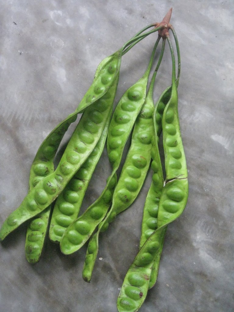

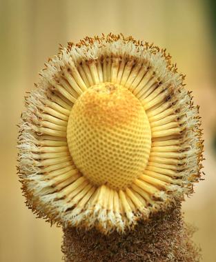

If you compare the below photo of the beans still in their pod, I think it looks very similar to the pattern depicted on the keris' blade. However, kembang means flower, which suggests the pattern should resemble the flowers instead of the beans (flowers also pictured below). Is it possible that kembang here actually does refer to the beans, and not the flowers? Or is that wishful thinking on my part?
Also, I'd love to know what this pamor represents. What are the societal implications? Was it popular, rare, used by a specific sort of people? I'd like to know as much as possible about this pamor, so if anyone has knowledge to share it would be greatly appreciated.

Yuuzan, may I enquire who provided you with this name for this pamor?

I just stumbled across it when looking for pictures of what kembang pala looks like. It could, of course, be a name made up by a seller for fun and extra appeal (although I really hope this isn't the case). I included the links to the two pages that feature this pamor below.

A VERY INTERESTING KERIS, I KNOW VERY LITTLE ABOUT KERIS BUT DO LIKE THEM. THIS IS DIFFERENT THAN I HAVE SEEN IS IT A OLD PARMOUR DONE A BIT DIFFERENT OR SOMETHING NEW I DON'T KNOW.
I DO LIKE IT. THE KERIS BLADE IN GENERAL HAS A ROUGH BLADE TEXTURE THAT WOULD NOT GO IN AND OUT SMOOTHLY WHEN STABBING.
DAGGERS FROM MOST OTHER CULTURES AND COUNTRYS HAVE SMOOTH BLADES. YOUR EXAMPLE WOULD BE A BUMPY RIDE GOING IN AND OUT. OUCH!
THE STINKY BEAN IDEA IS FUN TOO REGARDLESS OF IF ITS TRUE OR NOT.
