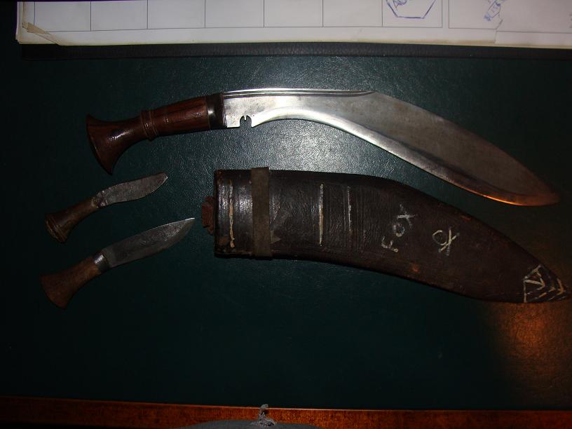

Top to Bottom WWII Kukri;
Mk2 WWII full tang kukri (carry over from WWI)
8TH GR kukri, stick tang
IA kukri, stick tang
IA kukri, stick tang (style used in WWI)
Mk3, full tang
