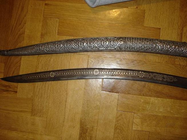

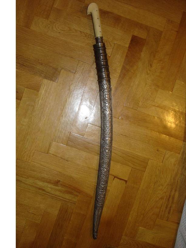

Hi.I acquired this yataghan recently. silver scabbard, walrus hilt and both sides silver inlay. length 83 cm. Has 1215 ( 1799) as date. can anybody translate the Arabic inscriptions please?
regards

Impressive. The silver work is in great shape.

Hi

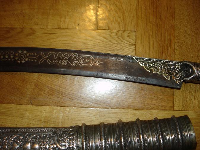

on the first pic (from right to left) the date seem's to be 1315 more than 1215, anyway the hegire 1 is 622, either
1315 + 622 = 1937
1215 + 622 = 1837
but 1799 ??

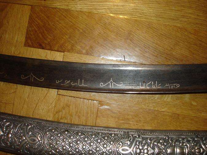

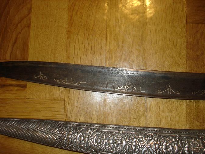

the first group of letters could (?) be "Ali", the (?) because it's arabic alphabet letters, but without clear meaning,
the second group is not letters, just signs without arabic relation
on the second pic, all signs are not arabic letters , even if their design seems to be oriental
anyway, this yataghan is really wonderfull
à +
Dom
Old 28th November 2005, 07:47 PM   #4
Dom,
You need to use conversion calendar: Islamic year is lunar!
Please check this:
http://www.oriold.unizh.ch/static/hegira.html
1215 H= 1800 Gregorian
1315 H = 1897 Gregorian
Lovely yataghan: somehow reminds me of Greek/Balkan origin: handle, dolphin, silverwork...

hi. I think Islamic calendar is not calculated so,we can't just add 622 to find the matching date in the other calendar. it differs around 11 days every year compared to Gregorian. otherwise it would be very easy
The discussed number on the sword has two tips going upward, if it was number 3, it should have three tips. it is carved quite crudely, thats why you think it is a "3" I guess. if it is 1215, it means something like 1799 or 1800 for sure. in 1890s-1900s nobody was making yataghans anymore. Which picture do you mean by "the second"? The second one containing silver inlaid figures, from up to down? Yes some of them are oriental decorations but, you think none of them are Arabic letters?

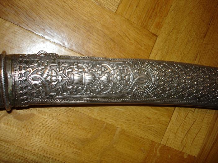

Hello erilkhan, how very handsome and such lovely crisp silver work. I no nothing about the Islamic calendar but the formal borders of the cartouches and there contents have a strong European influence and the profusion of decoration makes me think of the latter part of the 19th cent. Where in the Islamic world do you think it comes from? How do you know the handle is walrus ivory? Tim

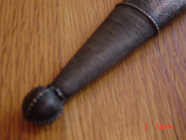

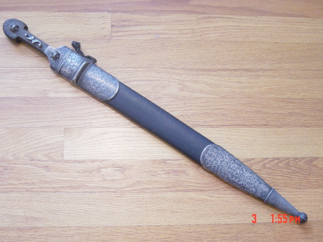

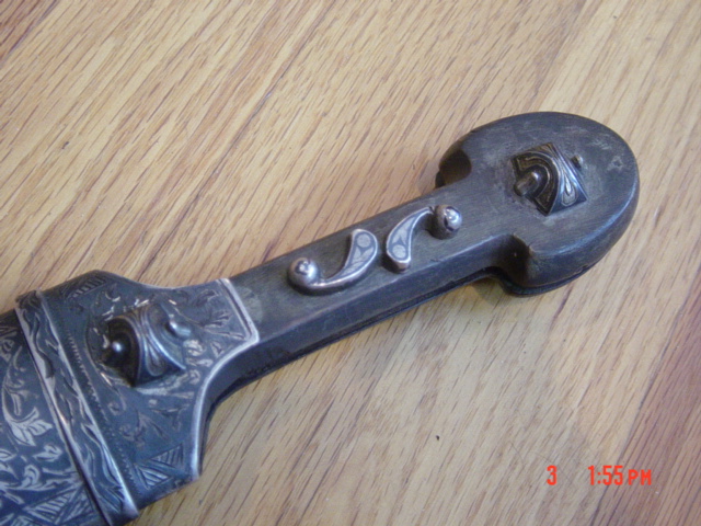

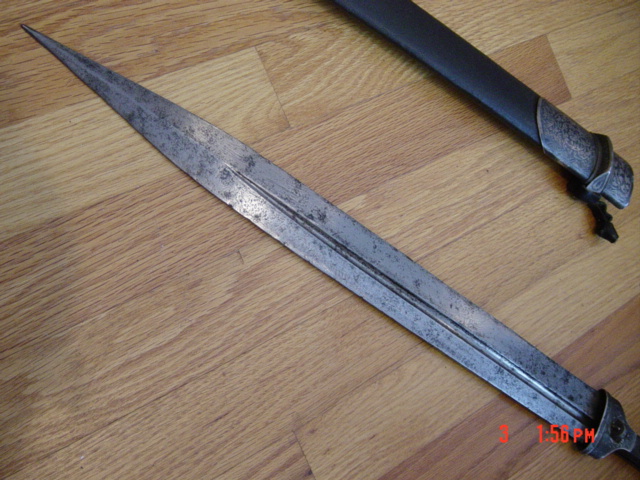

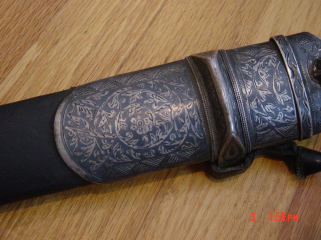

Here is my Kindjal as promised. Couldn't photograph the markings but you have to believe me: 1181H. The leather is new, the rest is original and in a very good shape. I do not want to polish the blade for fear of removing the markings.

I have been thinking about the origin myself...
The best would be to read the armourer's mark on the blade and I shall try to find a translator ( afraid, there are very few Chechens around here, though...)
The form might be of help:
Circassian kinjals wer smaller and narrow-er ( except for Shapsughs', but those were shorter). Daghestani/Chechen kindjals had better silverwork, but that was after Shamil; The Great Leader favoured simple iron. The ornament has nothing to do with the traditional Avar/Chechen/Daghestani motives: too simple .
I would stick my neck out and say: Georgian. They had blades of any kind, and 3-rivet handles. Flimsy evidence, to put it mildly, but I can't do better than that. Why couldn't the bugger sign his name on the scabbard??
What do you think?
