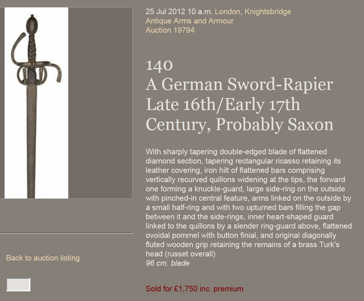

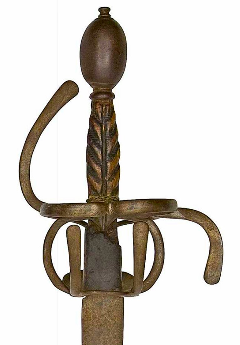

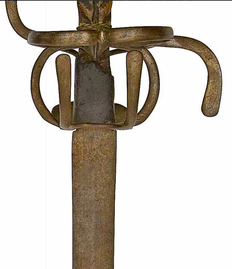

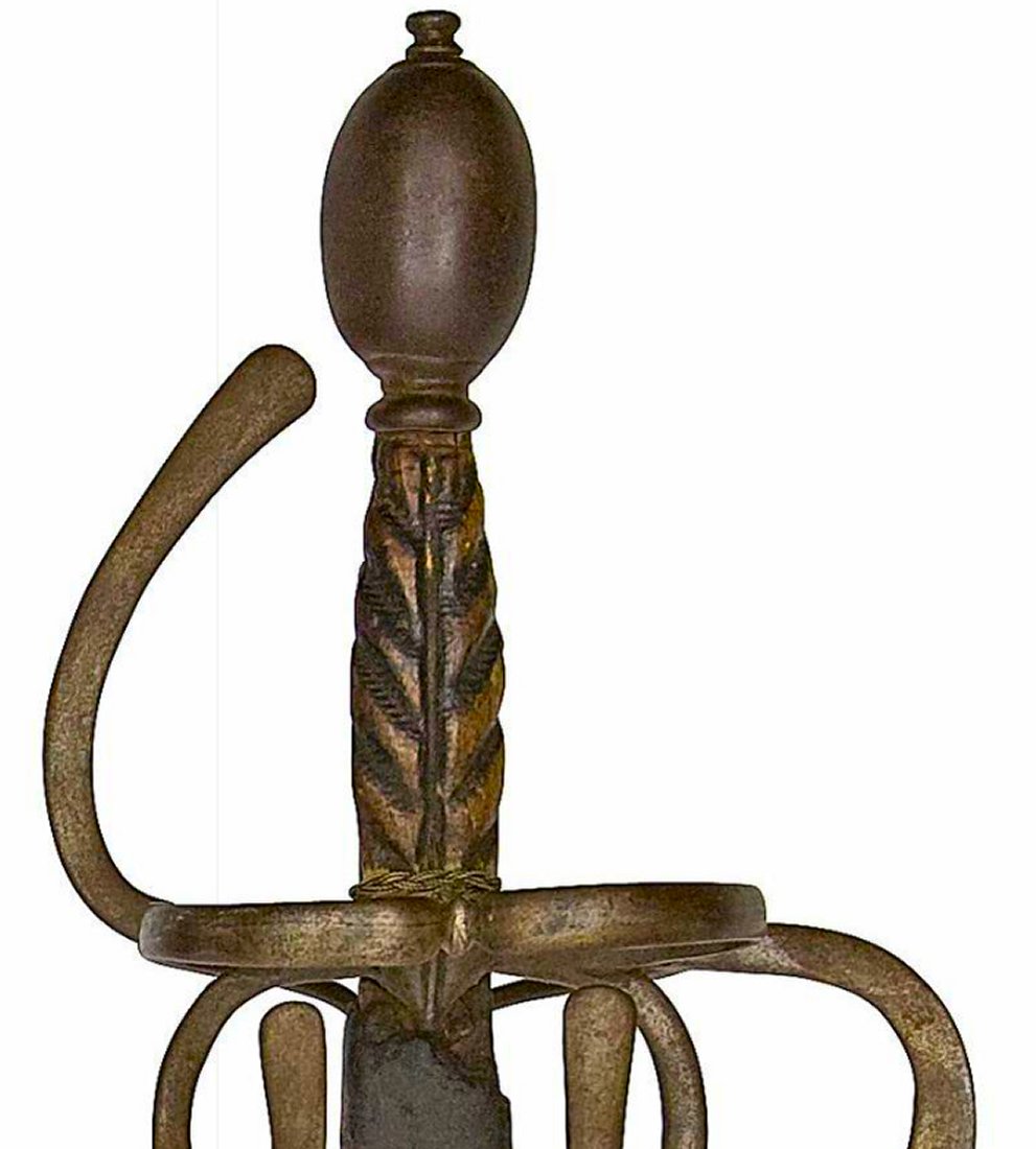

Sold Bonhams, July 25, 2012.
The iron parts preserved in perfect original yellowish olive oil patina, the wire binding missing from the leather-covered wooden grip except for a Turk's head. The ricasso retaining its leather covering. Best, Michael Last edited by Matchlock; 25th July 2012 at 02:47 PM. |

At 96 cm ( a fraction over 3 feet ) the blade isn't particularlly long as many rapiers tended to be, some of them extremely so. Its too bad there are no width dimensions listed as this would give a better impression of whether it was more of a rapier ( long and thin with a hard diamond cross section ) or more of a backsword/military sidesword with a broader blade of more flattened diamond cross section better suited to both cutting and thrusting more usefull on the battlefield. The " sword/rapier " in the listing gives me the impression that it may have more of a cut and thrust blade as i've heard the term used before to describe military sideswords.
