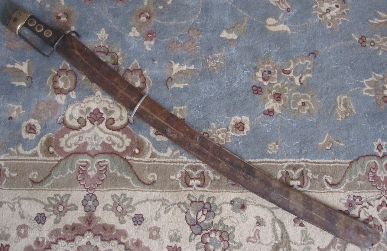

Hello all,
I got this one today, was in a poor condition but cleaned it up. It could benefit from a polish I think.
The blade seems to be a European trade blade? There are some latin inscriptions on it. Some other inscriptions exist also but barely show..

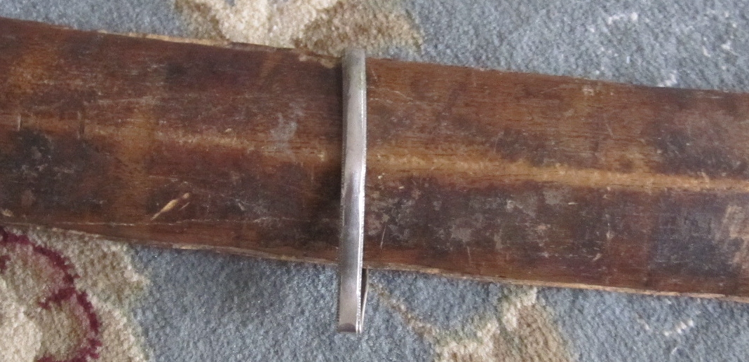

The scabbard is beat up but the wood is solid. There are prints of what used to cover it, any idea how it used to look like??

Hi Lofty,
Interesting example which appears to be a sabre of the form which seems commonly held to be used by Bedouin tribes from the Negev into the Sinai Peninsula. As often discussed through the years the 'nimcha' term has been widely misapplied, and typically used by collectors for the Moroccan sabre with distinct guard configuration. From a semantics point of view of course, and as you know, it is easier to use the term in this parlance, I just mentioned it for the benefit of our wide range of non-participating readers, who scan our pages to learn more. As always I look forward to their joining us eventually. I am inclined to favor the descriptive term Bedouin sa'if.
The blade is as you note European and very well could be latter 18th, but probably 19th century, as these heavy sabre blades which entered these spheres via Red Sea trade in the 19th century were reused for often countless generations. The mounts are of course much more recent as evidenced by the screws etc.
The cursive script ligature, or more likely acrostic, is European and used often in acrostic sense to abbreviate a phrase or slogan, even perhaps an acronym for a particular group. I cannot see the letters properly but there seem to be four, so would not be initials.
These swords have a certain rugged charm to them as they reflect the fascinating character of the Bedouin tribes, who often anachronistically used these weapons well into the 20th century. This blade could very well have seen service in the WWI campaigns in these regions, as well as the long history of internecine warfare .
While many collectors might scoff at these rugged old warriors, you are astutely aware the colorful history they hold. Nicely done !

Hi Lotfy,
Lovely sword!
Could the script read 'NOJA' or possibly even 'NOIA' and refer to the places Noja/Noia in Spain?
Just guessing of course.

Hi my Brot.
I'm backing completely what said Jim,
it's not a "nimcha" even if the general shape for the handle remind a bit ...
it's manifestly, a "Saïf"
about the letters, the form of it, it's called "English form"
the 4 letters could be read as well as : " N D I A" ...
I can not imagine, that what do you suppose being erased,
could might be, ... be an "I"
anyway, I love his rough aspect, a "Saïf for a warrior" not for a court representation ...
and it has his scabbard, that for me I consider as important
MABROUK, and all the best

Lofty, Im not too sure of the scabbards on these and as far as I know, few survive. I am hoping that Sa'ar will come in on this as his knowledge on these is superb.

I am looking at it and think ... South Aravian.... The Sinai/Negev beduin sabres do not have either D-guards or quillons. They also do not have the cavity at the top of the handle, which is a common feature of N. African or Aravian sabers. That being said, nothing is impossible: the whole area was in a constant flux of beduin tribes, and mixed forms are dime a dozen. Also, the fact I never saw one does not mean they do not exist. I like these rugged, crude and unostentatious weapons very much.
I have been given a present of a "real" beduin sword from the Negev, newly made: a bastardized version of a Turkish kilij ( handle and crossguard) and home made shamshir-like blade made on a grinding wheel. Nothing touristy about it, it was specially made as a present to a very respected doctor in gratitude for saving sheik son's life. Top of the line. That was the modern beduin impression of the luxury sword :-) Times are changing...

Ariel, Thanks. I think the scabbard also has similarity to the scabbards on zanzibari nimchas but thats not conclusive.
