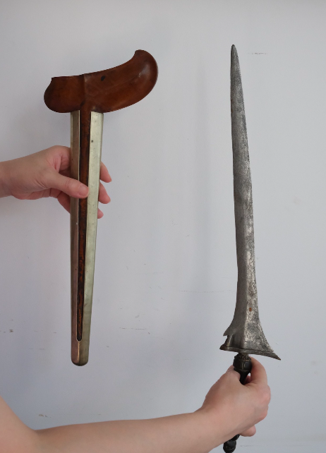

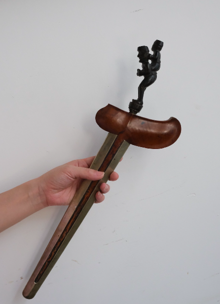

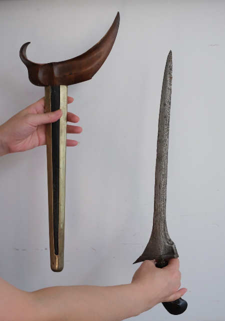

A friend showed me two Javanese Keris. They are alleged to be from 1900s (I don't know if it's ture). Can you identify them?
Why almost every Keris always be alleged to be from 1900s?
Many old Keris seems to be white but doesn't have too much red rust. Is that a valid method to identify old keris?

Blades look legitimately old. First one could easily be 19th century. The second blade is possibly older.
That's also a very strange hilt on the second blade. I don't think it was originally intended for a keris.

I wonder if the strange hilt might be Batak. I've seen a fair number of Batak carvings depicting figures riding upon each other.

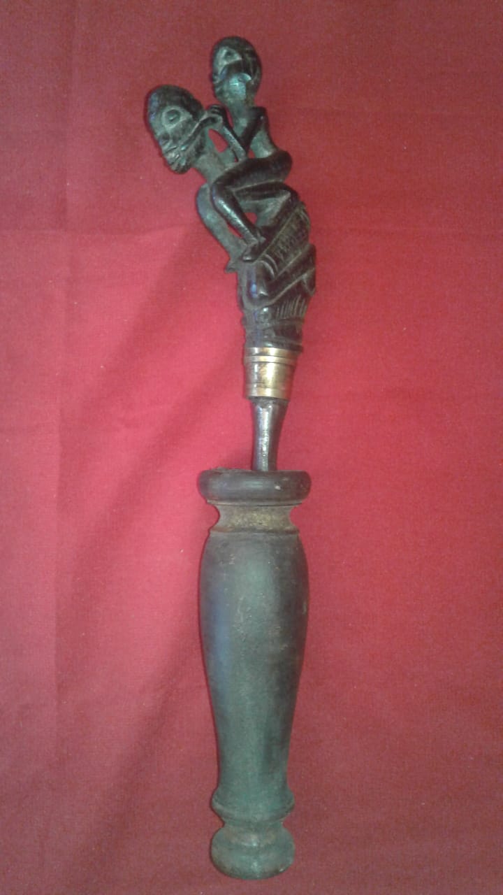

Hi, Rick, Like this
The hilt is from a betel crusher from Lombok, see here: http://www.vikingsword.com/vb/showth...ighlight=betel

Posts: 6,441
Yup.
That's what I had in mind Sajen.

Originally Posted by HughChen View Post
Hi, Rick, Like this
But it's not Batak work, these hilts are common on Lombok.
