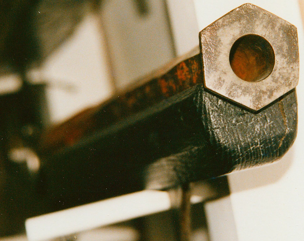

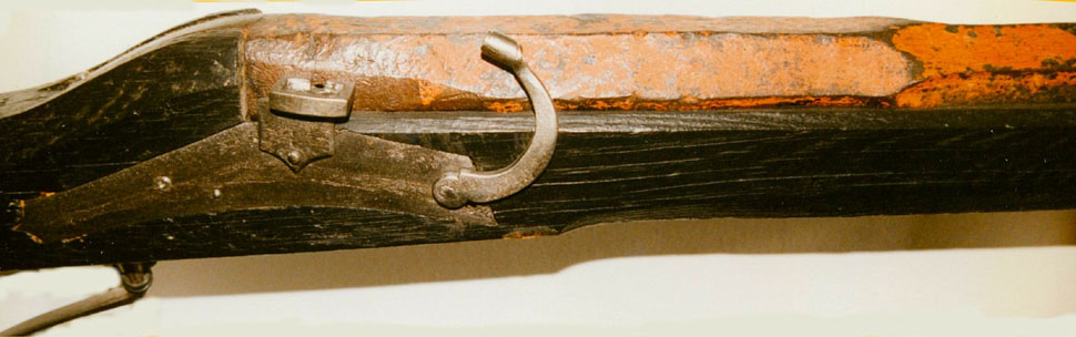

The only real examples of painted/stained iron surfaces on early (15th-17th) firearms to prevent them from rusting I can give are minium/read lead painted barrels and locks. Blueing, on the other hand, was almost always achieved by the heat of the smith's fire and stopped at exactly the right color/temperature in those times.
What I have often seen in untouched arsenal situations are barrels painted black for the same conservatory reasons but only in the 18th century and later - which means well after their original time of use.
For today I give some samples from a minium painted barrel of ca. 1460-70 preserved in Schloss Ambras, Austria, and from Schloss Frondsberg, Styria/ Austria, ca. 1540 - the later partially sold by Tom Del Mar, 15 Dec 2004; the barrels of the latter were missing and later replaced by primitive dummies.
More to follow.

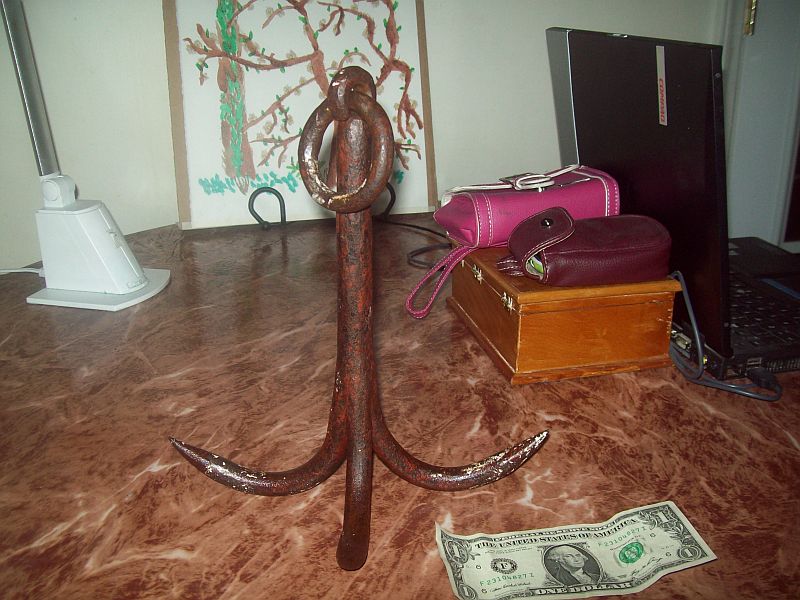

Default Grappling hook
Here's a naval piece with brownish red primer to retard salt corrosion. Sea air just loved iron implements...

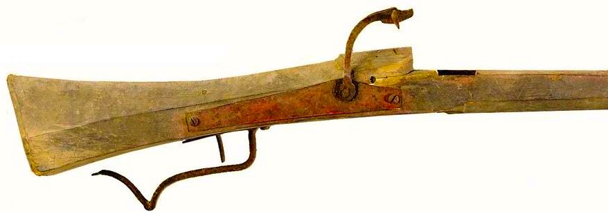

By the turning of the XVIII-XIX there was a gunsmith established in Braga (North Portugal), who has become popular by producing low cost muskets, that were massively required by imigrants going to reside in Brazil and Angola.
Hi name was Lazaro, and so was his father; due to this he decided to sign the guns with "Lazaro Lazarino legitimo de (legitimate from) Braga", in order not to be confused with the famous Italian Cominazos.
These muskets became so popular that all period hunting muskets were generically named "Lazarinas".
It is widely known that he used to finish these guns stocks with a red paint, to prevent rotting with worm and tropical moisture.
Fernando
Old 27th April 2010, 03:42 PM   #7
M ELEY
Location: NC, U.S.A.
Posts: 2,229
Fantastic information, Fernando, thank you! I must do more research on the blackened "board black swords" you mention. That is a magnificent gun you picure. The red stock is quite nice. Is it one from your collection?

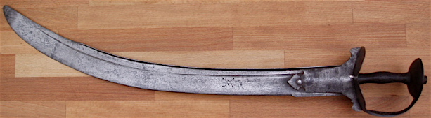

Hi,
An item of mine which has been tentatively identified as a possible example of an Indian 'cutlass'. Coincidently it has vestiges of black paint or a similar substance on the inside of the guard, on the grip and various spots elsewhere, definitely applied protection of some description or other, whether it was put on specifically for naval use or for protection in general is guesswork.
Norman.
P.S. I was always under the impression that in the U.K., rightly or wrongly, that iron/steel items in a naval context, weapons or otherwise, were painted/coated for protection as a matter of course and that this was a long standing mode of preservation dating back to at least the end of the 18thC if not further back than this. In H.M. Forces the adage, 'if it moves salute it if it doesn't paint it' would seem to be appropriate in this context.

Originally Posted by M ELEY
... The red stock is quite nice. Is it one from your collection?...
Oh no; i have selected the more "close up" one from those illustrated in two of my books.
Not that they are extremely rare; you may find them for sale every now and then.
However examples spotted are often of very low quality. There were those made by Lazaro Lazarino, those imported from Belgium, and later even from Birmingham, to feed the increasing demand. Also Liege made their own exports to Africa.
And finally the African started making their own replicas, with barrels made of water pipes ... the usual stuff, with the stocks fully decorated with brass nails, etc.
As a matter of fact, these guns achieved the status of currency; they could be traded for women and, later, they were currency for the buying of slave boys ... as witnessed by Livingstone.
But i believe the red finishing in the stocks was a particular characteristic only used by Lazaro Lazarino.
Fernando

Yes, I have seen the Leige export types. I have a boarding pistol circa 1810 with Leige marks that I'm told was also exported to Africa as a cavalry pistol. Quite a difference. The reason I thought about it is that the wood is indeed a brownish red stain. Very interesting.
Norm, that is an incredible piece you have there. Cutlass all the way, I say. it makes sense that it would likewise copy the British patterns, in that the U.K. had such a foothold in India at that time. And of course, let us not forget about the Indian pirates ( ). They were a powerful force in their day. This is really a great piece, Norman!
