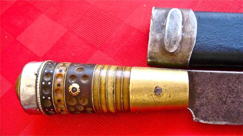

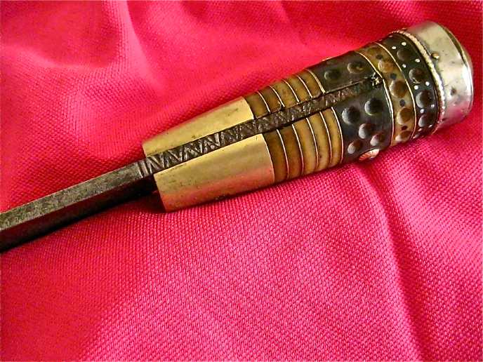

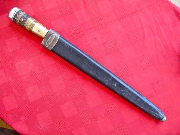

in Isfahan (Iran) I got this knife, but difficulty to identifiy it
your precious help is required, thanks per anticipation

A very nice looking item Dom,
Nice steel, nice marks.
Not a pesh kabz, i would say.
With that peculiar blade point ... would it actualy be a weapon ? .
Certainly the experts will ID this piece.
I will hopefuly expect so.
Fernando

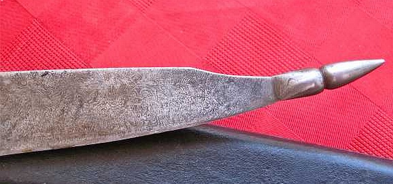

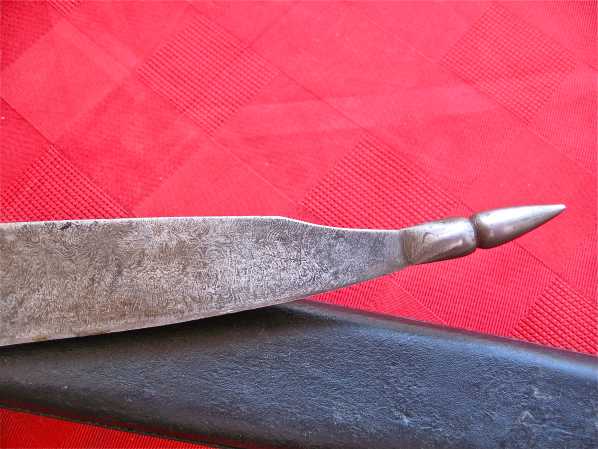

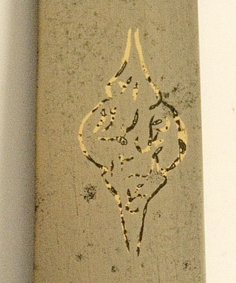

It looks Afghan to me but I have a big problem with tip it is totally non functional and it even looks like it was pinned on? The steel looks acid etch to me also.

It almost looks to me like a european piece that has been altered to have the 'ring splitter' added, making it more like a similarly 'armed' persian kard.
I also agree with Lew that my first impression of the patterning was 'added'.
Also, is that a 'frog button' on the scabbard?

if the tip who chocked you, has been added on my "Pesh Kabz"
I found a "Wootz Kard" probably Circa 1800 with that type of tip, to pierce mailcoat ...
tip not added, the blade was forged like that (beautiful wootz)
ps/pictures issued from "Akaal Arms" catalog
Best Regards

Lew wins These tips are different structurally, one on Persian Kard is meant for reinforcement/piercing, the other has a decorative purpose and was not meant to pierce anything hard/metal. Dom, please do not try, it'll snap below the tip:-)

You are correct the example shown at the bottom was forged as an integral part of the tip with the proper taper and and shape which is like a flattened triangle.
The one you have seems round and eckhorned shaped with a rivet through it. This could have been a later repair.
