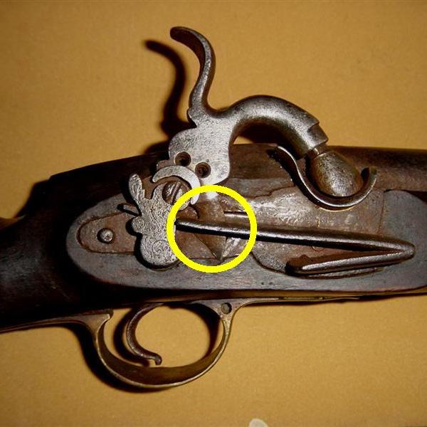

The lock style is called here half Portuguese & half French ... the late due to the internal spring action; although only with one position, that of full cock. The half cock postion is done with a hand moving pawl, which is considered one of the safest mechanisms for such purpose.

Old 3rd March 2012, 10:49 PM   #4
Thank you for your input Fernando.
No, this is not the "molinhas" lock. Although the manualy operated half cock external pawl (gancho) is that of the usual molinhas system, the internal spring is not that of the molinhas but the 'conventional' one, reason why this is called a half Portuguese half French lock.

Hola Fernando:
Gracias por tu aclaración, y por las imágenes. Lo que no me queda claro es el gancho de seguridad: si era movido manualmente, cuando el pié de gato esta en posición de armado (full-cock) el gancho podía moverse e interferir en su caída.
Afectuosamente. Fernando K
Hi Fernando:
Thanks for your clarification, and images. What is not clear to me is the safety hook: if it was moved manually, when the cat's foot is in cocked position (full-cock) could move the hook and interfere in its fall.
Affectionately. Fernando

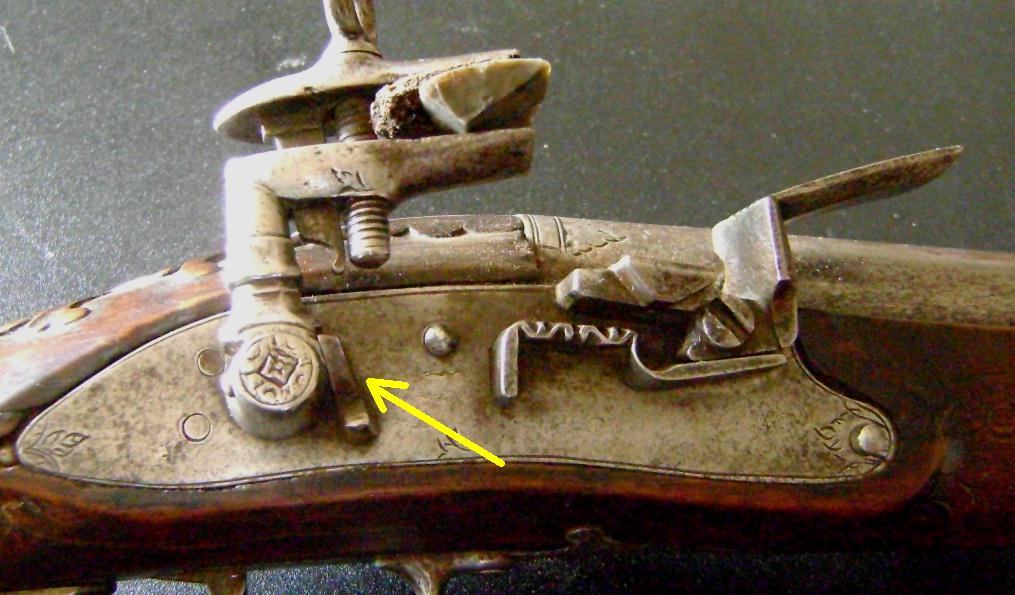

broadaxe
Join Date: Nov 2008
Posts: 334
This is most interesting. I like blunderbusses as a rule, and lacking information regarding Portuguese arms. I can see the connection here of the well-decorated barrel, to Indonesian Lantakas.
The lock isn't exactly a miquelete, is it?

Old 5th March 2012, 07:16 PM   #10
The miquelete lock is completely another thing. The basic difference is that its main spring is in the outside of the plate. This had the advantage of not having to deeply carve the stock wood, hence not diminishing its strenght. For the same reason such main spring could be sturdier/stronger, something we can observe in most examples.
The action mechanism was also very particular, with its hammer foot operating both half and full cock by means of internal sears passing through the plate, suspending the hammer foot. As this hammer foot had its features similiar to a human sideburn, this lock was named (apart from later miquelete) "patilla" (patilha in portuguese).
Old 5th March 2012, 06:53 PM   #11
Originally Posted by Fernando K
... Lo que no me queda claro es el gancho de seguridad: si era movido manualmente, cuando el pié de gato esta en posición de armado (full-cock) el gancho podía moverse e interferir en su caída.
What is not clear to me is the safety hook (pawl): if it was moved manually, when the cat's foot is in full cocked position, the pawl could move in and interfere in its fall. ...
The pawl (gancho) is not dinamic (has no spring=muele); it stays where you leave it.
There is a small protuberance (saliencia) in the hammer (pie de gato) round foot . When you pull it up to full cock, this will push back the pawl (gancho), so that it won't be on the way when the hammer comes down.
