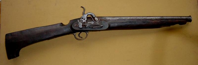

I love the looks of this specimen. Anyone knows what it is ... or willing to know ?
... before i tell the little i ( think i) know about it.
Fernando

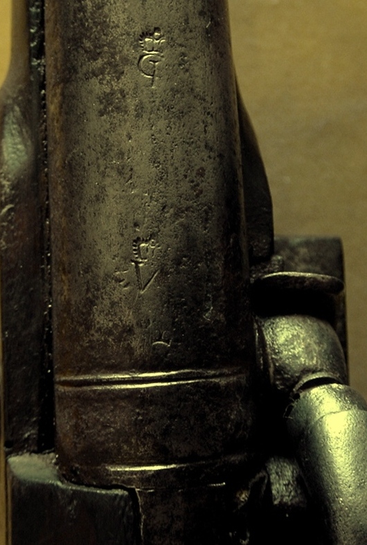

Without going thru books to verify it, those proof marks look british. Could this be a coach gun or warders gun of some sort?

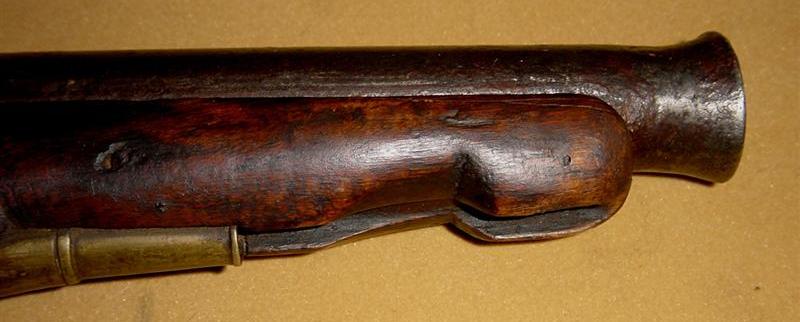

This is a sort of blunderbuss, called "bacamarte" in Portuguese and "trabuco" in Castillian, as also optionaly in Portuguese.
These things were usualy a setup made with parts from different origins, mostly that of the barrels. Often a result of regional assembly, by the local smiths. They were largely used in the Peninsula in the beg/mid XIX century, when civilians needed to assure their safety, firstly from invading army astray guys (Napoleonic wars) and later from a consequent troubled period, where outlaws or desperate assailants abunded.
They were very short and handy, easy to conceal under the owner's cape.
This particular one has indeed a .75 British barrel, shortened to 17 inches and "atrabucado" or "abacamartado" ( muzzle widened), mounted on a stock so called "a la Catalunian", and equiped with an action lock of the "patilha" (Miquelete) type, of late generation. Note this is originaly for percussion and not converted from flint, as so often seen.
The barrel was made by some famous John Clive. The trigger guard and ram rod pipe are also British.
Although its stock and lock are basicaly Spanish, this doesn't avoid that it could have being assembled in Portugal. Both cultures and methods were not so strange to each other. It could have also been brought by some Spaniard through the borders, which at the time were not so well defined. In fact, the seller has traded it very close from the (nowadays) Spanish frontier.
Anyway, i find it a very elegant piece.

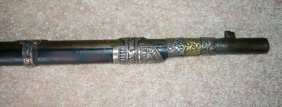

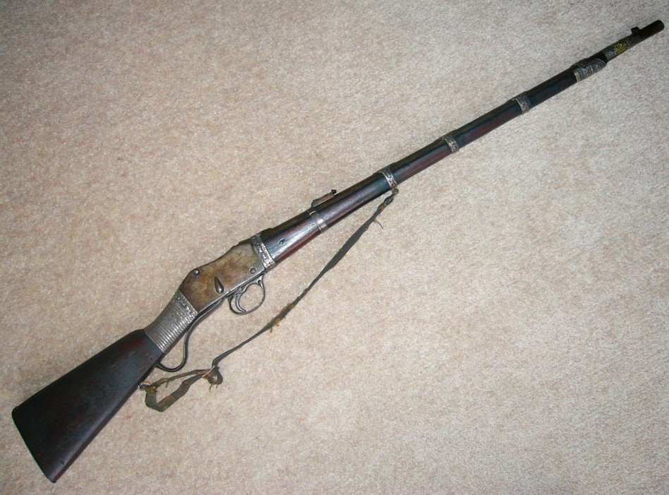

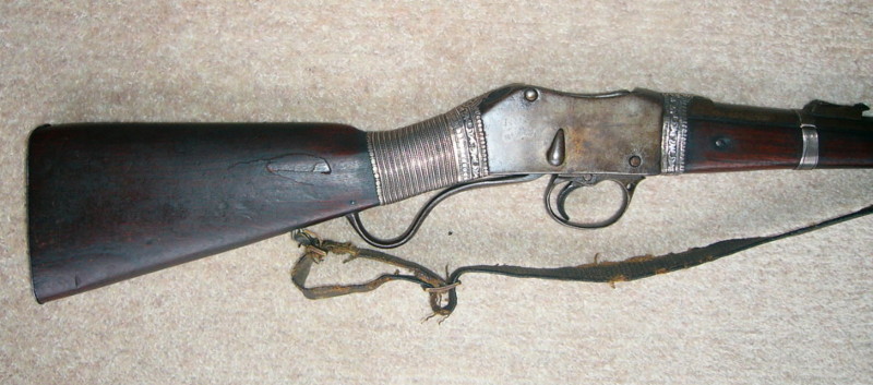

Hi Fernando---yes I believe that firearms DO have a place here. My collection over the years has had may firearms of different types in it, but now, due mainly to space available, is not mostly composed of blades. I do still have one item which compliments my collection of Arabian Peninsula blades. It is an old 577/450 cal Martini Henry Rifle, which is decorated in silver. This item came from Oman.
I do keep an eye out for firearms still, and if something particularly took my fancy and was not at a crazy price, I could well be tempted.
There is not (as far as I know) a Forum of this type for old firearms, though if there is, perhaps someone can publish the details.
Maybe a further sub heading on this Forum??
Pics attached.

Outstanding example of the Martini-Henry!! and actually one of my favorites as far as vintage military rifles.These can still be found at reasonable prices (beware of growing number of these of questionable integrity exiting Afghanistan from what I have heard).

You have a Spanish Miguelete Lock percussion "escopeta catalana".
Probably a flintlock converted to percussion in or around 1830.

Fernando, would be it short enough to call it "trabuco naranjero"?
Just noticed your comment re this. This is not a "real" Martini Henry, and the story goes that this is one of many which were "built" in Pakistan and traded or smuggled to various Middle Eastern countries. This one in 577/450 cal is very early and the later ones were .303. It has no marks of any sort but despite being a "copy" is surprisingly well made. Collected in the Oman during the time of the Yemeni incursions by a friend of mine who was a mercenary in the Sultans Armed Forces and subsequently smuggled out again when he left there for NZ. (Exporting of firearms was absolutely banned at the time.)
I believe that the backyard builders of firearms can make you anything you want including the AK47. When you consider that the machines which make the real thing are not available, I think they do very well!!!

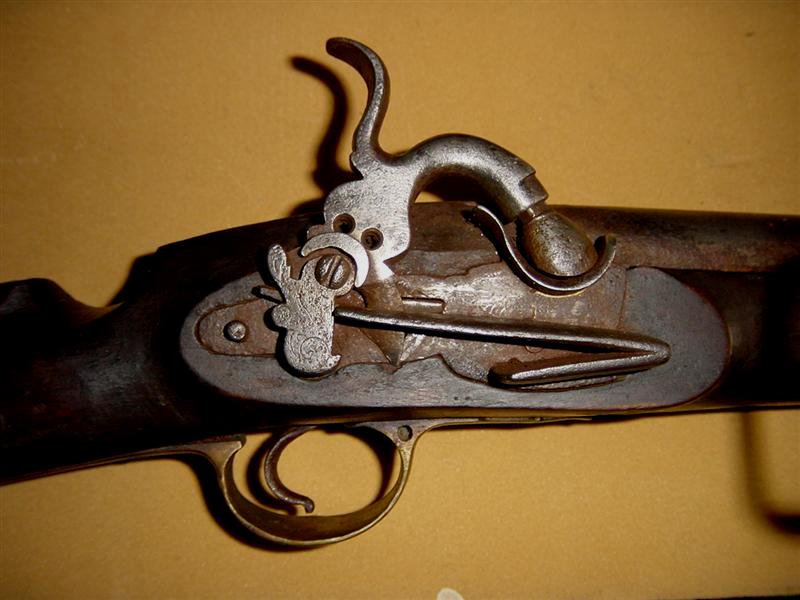

This gun looks Spanish in design, but I am confused by the percussion hammer & scent bottle type drum. The main spring on the exterior of the lock suggests along with the overall design a much earlier firearm?!

Me parece que es una adaptación de un fusil militar: de allí el calibre (.75) y las fornituras; también las marcas del Banco de Pruebas, GP y V coronadas, aunque carece del punzón de la Torre y del punzón de propiedad real. No he tenido en mis manos el cañón, pero me parece que se ha soldado el "masacote" para atornillar la chimenea (niple), o sea que el cañón era originariamente de chispa. Tal vez sea un fusil construído para la Compañia de Indias.
Afectuosamente. Fernando K
Hello Fernando
I think it's an adaptation of a military rifle: hence the caliber (.75) and the trimmings; also the proof marks, GP and crowned V, although it lacks the punch of the Tower and the punch of royal property. I have not had my hands on the gun, but i think that the "masacote" has been welded to screw the chimney (nipple), meaning that the barrel was originally for a flintlock. Maybe it's a rifle built for the East India Company.
Affectionately. Fernando K

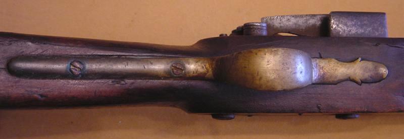

"Masacote" es el término que se aplica al trozo de metal que se usa para la conversión de un cañón (barrel) de chispa (flint) a percusión. Se siguieron dos métodos, tradicionalmente: la soldadura a base de cobre, en el lugar del oído o el agrandado y roscado de este, y la introducción por roscado de la pieza. Por supuesto que la pieza tiene un canal para permitir el paso del fogonazo producido por la ceba fulminante y una perforación mas grande y roscada para permitir el roscado de la chimenea (niple). "Masacote" viene de "masa".
En los cañones originarios de percusión, el masacote está forjado, y forma parte de la parte final (breech).
Afectuosamente (y pese a la traducción) Fernando K
Hello, Fernando
"Masacote" is the term applied to the piece of metal used for the conversion of a barrel from flint to percussion. Two methods were followed, traditionally, the copper soldering in place of the fire hole or its enlargibng and threading, for the introduction of the piece. Of course, the piece has a channel to allow passage of the priming spark produced by lightning and a larger and threaded hole to allow the placxement of the nipple. "Masacote" comes from "mass".
In the barrels originating from percussion, the masacote is forged, and is part of the breech.
Affectionately (and despite the translation) Fernando K
Old 21st January 2012, 11:36 PM   #30
Fernando K
Join Date: Apr 2010
Posts: 672
Hola a todos:
Fernando usó el término "Patilha" que es la traducción del español "patilla". Patilla es el diminutivo de "Pata" y se refiere al apéndice que tiene el gatillo (pié de gato") y que monta sobre los "calzos". Patilla también es la parte del pelo que está delante de la oreja, y que tiene esa forma
Hello all,
Fernando used the term "Patilha" which is the Spanish translation of "patilla"". Patilla is the diminutive of "Pata" (hoof) and refers to the appendix that the trigger has (cat foot), that mounts on the "calzos" (sears) . Patilla is also part of the hair in front of the ear, which has that form.
