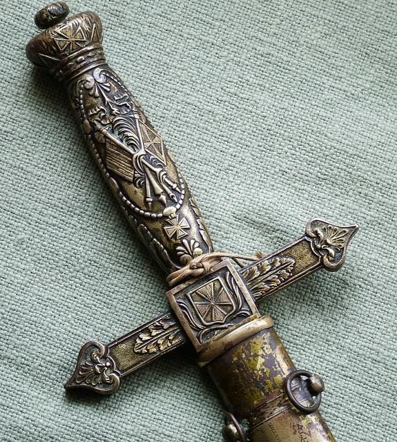

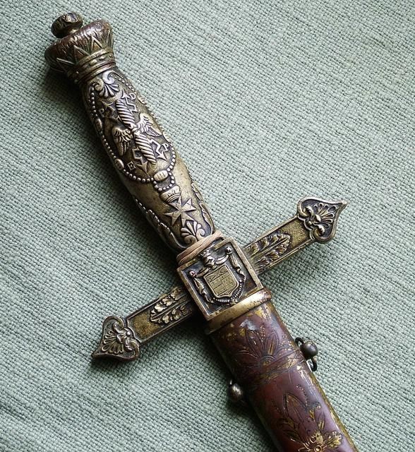

It is not ethnographic but I am almost sure you will find it interesting and some people here will help to identify it.
It is a society sword, but we don’t know few things.
1. What society?
2. When it was made?
3. Does it carry special meanings?

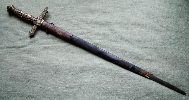

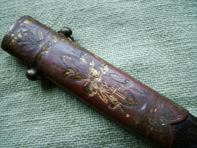

The hilt is cast bronze. The scabbard is wood covered by black sharkskin leather and with engraved bronze, tip is missing.

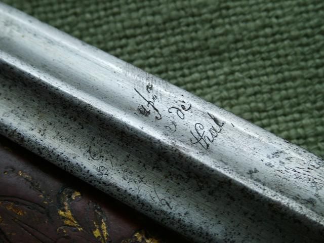

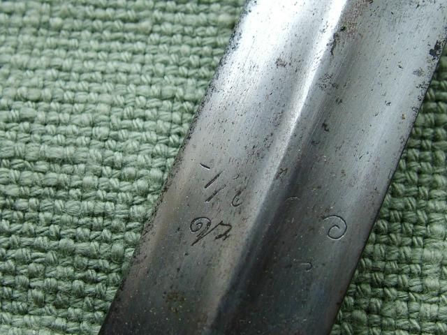

The blade has nothing to do with society swords we see often. It is a real fighting blade of smalsword. It has diamond cross section (raised rib) with two wide fullers. It is hand forged and has some marks both sides.
There is an inscription on the back side of the scabbard with fine lettering in French:
“Le chevalier +F+ Jean Paleologus grand prieur de Grece … de Thrace commandeur de Corinthe …. tres cher frere et ami chevalier Jean Jaques Watts"
What is +F+ for?
Paleologus was the family name of the last Byzantine emperors and there are still people who claim them as ancestors.
Watts could be the John James Watts, an English man, one of the persons who revived the Order of the Hospital of Saint-John of Jerusalem in Britain back in 1857.
There are few maltese crosses on the sword so I assume that the society could be the Order of Malta. But I am not sure.

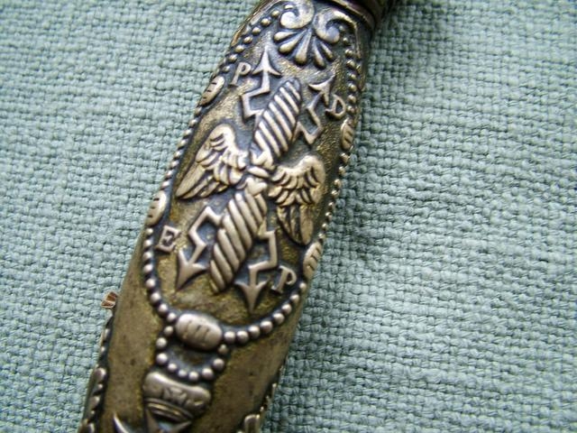

Also I cannot identify the other insignia, the marks on the blade and the four letters on the hilt P D E P.
Anyone can help? Please

I do not know anything about this kind of smallsword but on one picture I read the ending "-thal" which indicates French Klingenthal manufacture, approximately late 18th to mid 19th century.

PDEP are the latin initials for Pro Deo et Patria = For God and Fatherland, a motto much used by Orders and other forces.
In this link you will find all the various marking combinations, both maker's and blade inspector's, through all Klingenthal existance. With a bit of patience, you may be able to precise the date of your sword.
http://www.chez.com/klingenthal/

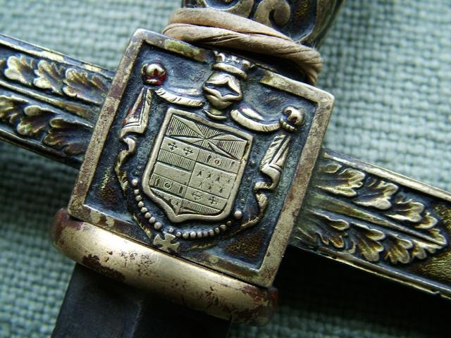

The pendant Maltese cross & crown below the winged thing on the handle very closely resembles the cross pendant worn by members of the Order in the 18th C. (maybe later, too, but the ones I saw represented in later paintings & photos were a little different). I found nothing indicating that the wing and lightening bolt symbol is associated with the Order, or the motto that fernando has provided. The coat of arms is most likely of the owner, as "16 quarters" of nobility are a requirement for membership -- i.e., as far back as your great-great grandparents. Didn't find that one particularly, or reference to this guy Paleologus. Notably, the Sovereign Military Hospitaller Order of St. John (etc.), which is the only Order of the four that can legitimately trace back to the medieval Knights Hospitaller that is still Catholic, does not have a priory in Greece, or even an embassy there. So, while it does appear that the sword is connected to the Knights of Malta, it would have to be with one of the other three Protestant branches. The John Watts connection would point to an English Order, but there are a bunch that claim some connection to the Knights Hospitallar. The one that is recognized as legitimate is the Venerable Order of St. John in Britain, which has been in exhistance since the Reformation.

There is one picture that you posted that shows a coat of arms - during my research this year, I have found several good websites that explain the shields. As you know, each symbol is significant, but also the number of divisions a shield is divided into. You could call it the sword's heiroglyph (sp?).
You may already have decoded it, but I will study it. Good deciphering lesson for me.

I found a trace for the mysterious symbol on the hilt and it is very strange. If you like the “Da Vinci Code” will love this
http://emblem.libraries.psu.edu/parad166.htm
