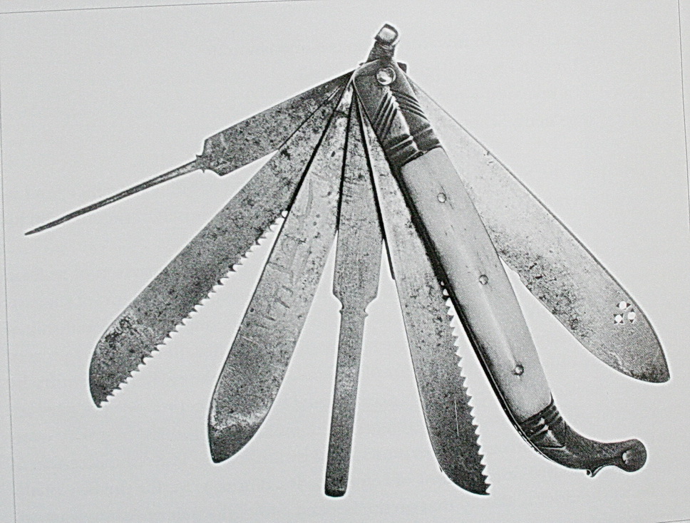

James Allen and Brian Guilmour: Persian Steel. The Tanavoli Collection, Oxford University Press 2000.
A number of folding knives are shown, but they are all 19th century, and I don’t remember if older folding knives are mentioned in the text. Attached is the oldest one shown, dated AH 1221 (AD 1806-7).
Sorry I could not be of more help.

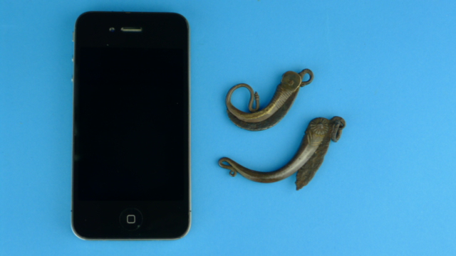

Folding knives of a sort, I have had these for a while. I believe they are South Indian Betel Nut knives, probably 18th Century, if not earlier. Pictured next to an Iphone for indication of size.
I have seen South Indian/Sri Lankan betel nut folding knives which I would consider 17th and 18th Century in the past. Some information on those lies in the book 'Ancient Swords Daggers and Knives in Sri Lanakan Museums' by Silva and Wikramsinghe.

Excellent and fascinating illustration Jens of that compound knife.
Runjeet
I don't think that this are Betel knives, the betel nut is to hard that you can cut it with this knifes. Is it possible that this are old opium knifes?
