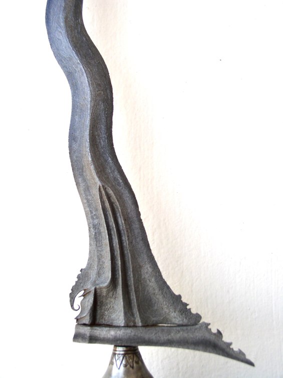

Just picked this up: nice old Palembang I think.
The scabbard needed some restoration, unfortunately there was only one half.
I hope there is someone who can tell me more about it, is it an original Palembang blade? It seems to me an original composition, the pendoko looks it’s gilt silver, but the gold has almost all disappeared, leaving a faint golden tinge.
The veiled durga hilt has no cracks (but was stuck very tightly) the total length of the blade is: 45cm/17.7inches, length of the pesi: 6cm/2.4inches.
The little one is 24cm/9.4 inches in total, I do not know if it is a patrem, or is it talismanic?
Thanks in advance for your comment,

Hello Sirek,
yes, in my humble opinion it is a Palembang blade. Look for comparison to the blade of my Palembang keris. I have a second example with nearly the same features.
Nice catch!

I agree that this is a nice old Palembang kris, but i do not think that this hilt is durga...

Certainly looks Palembang to me. The greneng style is consistent with what I see on my Palembang pieces.
The interesting thing is that this blade looks more 'beefy', with much more accentuated luk than most other Palembang blades of similar style. Here's one of mine for comparison.

I am glad that it’s a original, there are indeed many similarities especially the
greneng style.
In my opinion an original Palembang-keris is not so common,and is not often offered for sale in our country.

Hi Sirek, your long keris seems to be a nice example of a Palembang keris. The shorther keris, although looks crude.. it's a type that can be found around that region.
Sajen, your keris is also nice, but the selut and mendak do not match, imho looking and post #3 and #4. Looking at the blade, the kembang kacang area seems disturbed especially the pamor works, which suggests a repair, perhaps.
