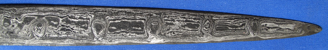

Dear friends,
I bought this kris from Solo, the blade is attributed to tangguh Tuban/ Mataram by the seller, and the dapur is Tilam Upih. My pamor identification was the same a the seller and his friends but we are not sure about it, your opinion will be welcome.
Thank you and best regards
Jean

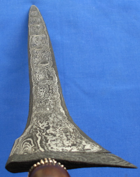

The pamor on the gonjo looks quite muted compared to the wilah .
I looked through Tammens2 and EK; didn't see anything like this .
It reminds me of bamboo a bit .
Sorry .
What do you think it is ?

Very nice pamor Never seen one like this
I agree: seems bambu (but not with inserts)
The blade, IMO, seems rather new (Madura?)
Also the gayaman is very nice

Jean, I feel that this pamor is open to a number of interpretations.
Have a look at Haryoguritno and see how many pamors you can find that this one could be squeezed into.
What I was taught about pamor naming was that you cannot just stick a name on a pamor because it looks like a particular motif .
Nope. Not allowed to do that.
You need to try to understand how the pamor was made and what the maker was trying to do, then you measure that against the lexicon of motifs.
With this pamor we have a canvas of wos wutah that has been surface manipulated by repetitive punch marks, or possibly ground in dips, or maybe punched and ground --- too hard to tell from a picture.
When I see a line of this sort of dots running down a blade, my favorite nomination is banyu tetes, but there are other candidates, and like many things to do with keris and names, maybe what you call it depends upon the influences that rule you.
The form does seem to agree with Tuban, but not Tuban -Mataram. In Tuban-Mataram we expect to see a tungkakan, and a pamor motif like this in a Tuban blade is something I would not expect to see. I rather doubt that this is an old blade --- but it is quite a nice one.

Thanks for your comments. First I apologize that the dapur type is Brojol and not Tilam Upih (there is no tikel alis).
Regarding the age of the blade, I don't think that is new but probably not very old and well maintained, there is some visible wear especially on top of the sor-soran on one side. It was recently cleaned and stained in Solo.
The pamor on the ganja is less bright than on the blade itself but it is not wulung and its colour shade is the same as the blade core.
Regarding the pamor, the best fitting style is Sumur Bandung although I agree that it does not constitute a perfect specimen. Any other opinion?
Best regards
Jean

Jean, I do not think that this pamor can be sumur bandung.
The round areas in sumur bandung are empty, that is they do not contain pamor, but have been created by forging out a pimple in the blade, removing the pamor while that pimple is raised, and then forging the blade flat again. Usually this pamor has only 3 or four empty round areas on each side, I have heard it can have more, but I've never seen this.
Now, if we look at your blade, the round areas have been created by either one of two methods, they have either been punched into the blade surface, or ground into the blade surface, and then the blade forged flat again, but importantly, in most cases they have been allowed to retain pamor within the depressed area.
I suppose we could say that it is an imperfect sumur bandung, because of retention of pamor, or we could say it is an imperfect banyu tetes because in a couple of cases the pamor has not been retained. But then we have the number of round areas, which is one hell of a lot of circles for sumur bandung.
There is another problem with this pamor, when it comes to naming:- if we look at the flow of the grain, we can see that not only has a round punch ( or grinding ) been used, which is the usual process with banyu tetes, but it is possible that when the blade was forged flat again, a square punch was used to bring the blade back to flat surfaces. This is a variation in process from a simple banyu tetes process, so it is entirely possible that the maker was trying to create something new.
The visible lack of pamor depth in one area of the sorsoran was caused by the fact that that area of the blade had a badly centered core, and during the making, the maker was either lazy or insufficiently skilled to recenter the core before he shaped the blade. It is not age wear.
I think it was Rassers who theorised that all pamor motifs developed from an original five motifs. This might or might not be so, but what is so is that the older blades invariably have much more simple motifs than the more recent blades. In historic blades any blade with pamor miring is rare. Very rare. Any blades with surface manipulated pamors are also rare. As we move forward in time we find that both surface manipulated pamors and pamors made by miring process become not only more frequent, but also more perfect.
In all Tuban blades, we are looking at quite old blades, and in all genuine Tuban blades the pamors involved are invariably very simple pamors.
Here we have a blade that has some elements of Tuban form, and a pamor that has a number of elements in its construction that were not mastered until the current resurgence in keris making, which did not really get under way until around 1990.
We must never expect that any old blade will look like a recent blade when it comes to the techniques involved in pamor work.

Semar, sumur bandung is a confusing pamor, it is confusing because it has the form of several empty round circles, or a couple of empty oblong circles separated by a puser. Two distinct forms, with the main characteristic of a framed area of blade that is empty of pamor.
You have shown us the second type, with framed empty oblong areas separated by a puser.
Jean has shown us a blade with a series of dots, which if one has never actually seen a sumur bandung pamor, and only had book pictures to refer to, could possibly be mistaken for the second type of sumur bandung.
In fact, in Jean's example the dots are not big enough, not few enough, and not distinct enough to be read as sumur bandung. But from a book reference, could easily be mistaken for this pamor.
PS --- if you would like confirmation of what I have said, I have just checked Ensiklopedi, and Harsrinuksmo says just about the same as I have said. Page 446.

To be clear the seller did not mean Tuban/ Mataram transition period but a blade made in Tuban style (form) during the Mataram era, but I accept your opinion that the blade was probably made recently as shown by the complex pamor especially. Any opinion if this blade was made in Java or Madura?
Best regards
Jean
Old 18th May 2011, 08:55 AM   #12
Posts: 7,217
Yes Jean, that's what Tuban-Mataram means:- made in Tuban during Mataram period; same as Tuban Pajajaran and Tuban Majapahit.
I know of nobody in Jawa who makes blades in this way. My guess is Sumenep, or if not Sumenep, a Sumenep craftsman living in Jawa, probably Surabaya-Malang area.
