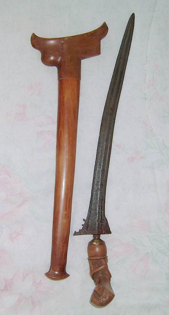

I picked up this Keris in a deal and it seems to have good age and an intersting iron mount.
Can any of you enlighten me, as these are rather a mytery to me.
Age? Any information really. Does it need an etch? Can anyone show me what it 'should' look like?
Thanks
gene

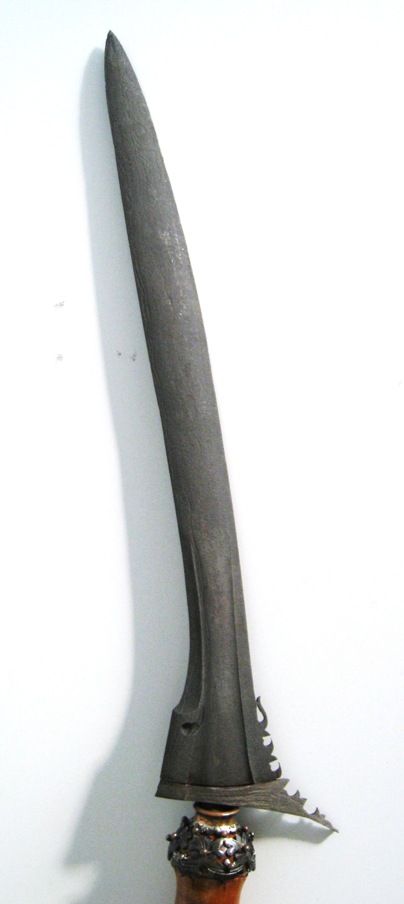

This once was an anak-alang of very high quality, peninsular, probably Pattani.
To me unusual seems the very strong well forged central rib. Unfortunately some damage to greneng, which also was well made, somewhat to classical for a peninsular blade. Sumatran influence?
Somewhat unusual also the way Tikel Alis is "suggested". Normally there is a more or less deep one (often more), or nothing at all.
Pendokok is a form associated with Pattani. Could it be silver? Would be a little bit strange to have an iron pendokok for piece of such quality.

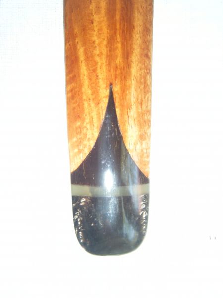

Sampir and hilt are very well done, the sampir wood is beautiful with it's two coloured grain.

Nice blade, but it does not have the profile and features that i would normally expect to see on a anak-alang, so i would question that assessment.
The pendokok might well be dirty silver. Did you test with a magnet to determine that it was iron? Unfortunate that it is damaged so much however.
If you plan to restore you will want to create a new "toe" for the sheath and get a new pendokok. I would image that a nice piece of blade horn would work well here.
AFAIK peninsula blades are not normally stained, but i would say this blade certainly should be cleaned. However, i am not convinced that this keris isn't of Sumatran origin, in which case a staining might be in order.

Frankly Gustav, i don't believe i have ever seen a anak alang with a center ridge (ada-ada) down the blade like this. To my understanding the profile of this dhapur looks more like this blade that Big G posted some time back. Note the profile, the thinner "waist" as it approaches the base of the blade, the "C" indentation in the gandik.
Whether or not peninsula blades are stained has been an unanswered debate on this forum for some time. I would love to hear something more definite about what the actual traditions are, but have yet to see anything i would call conclusive.

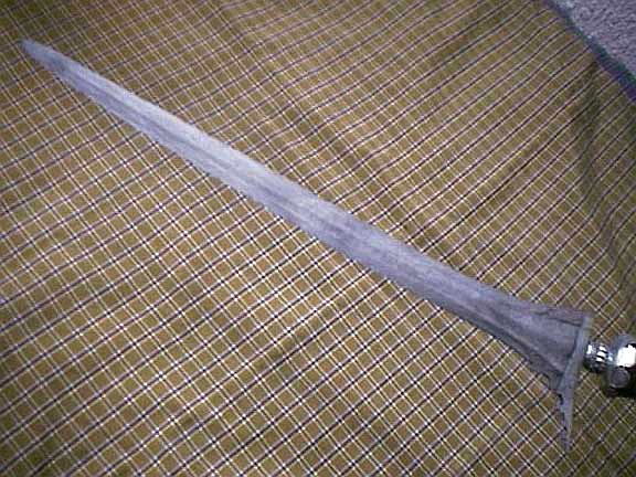

Okay, Alam Shah, Blu Erf and Dave Henkel are probably to busy. Just for refreshing this thread.
Regarding the staining of Peninsular blades: there is an article of I.H. Evans, "Notes on the manufacture of damascened spear and knife blades in Malay states", an eyewitness report from 1913, about forging, tempering and etching blades in a village in Perak.
It seams to be self-evident, blades with elaborated pamor, which are occuring in Peninsula, would be stained. The question seems to be, have also the polished blades made from more homogenous material been stained?
The unique Tajong blade from Museum für Völkerkunde Basel, there from about 1920, still has a black-blue staining, which appears to be original.
About shape of blade: Panjang and Panjang-related blades with central ridge don't have a thinner "waist", it is more or less suggested with help of slightly narrowing fullers in this place. On blade in question the narrowing of fullers is pretty distinct.
There are Panjang blades without this "C" indentation (which to me seems something like overinterpreted Tikel Alis), just a plain Gandhik. The blade in question even HAS a notch at this place.
When we call Rick's blade an Anak Alang, what is the real problem with this one? When, even more, it seems to be coming in an original Saribulan Sarung, which is very appropriate for this kind of blades?
Another blade of similar size with a middle ridge (and etched) from Forum Archives:
Last edited by Gustav; 8th March 2011 at 02:02 PM. Reason: forgot to write "Basel"

As Kai Wee mentioned I have discussed this blade with him and in my opinion this blade is definitely a Pattani piece. however, the defining characteristic is not the medial spine but rather the greneng - which is textbook Pattani. The dress is also. BTW the pendokok is tin and given the poorish fit and mismatch in quality with the rest of the piece, is probably a later replacement. The original was most likely a much nicer one in silver or perhaps even gold that was sold off. A nice example and definitely not a run of the mill piece.

Also, the blade you posted in post #15 is in my collection. Bought in Riau (Tg. Pinang) some years back - and probably from there - as a bare blade with the pendokok but no sheath or hilt. Note the difference in the greneng...
