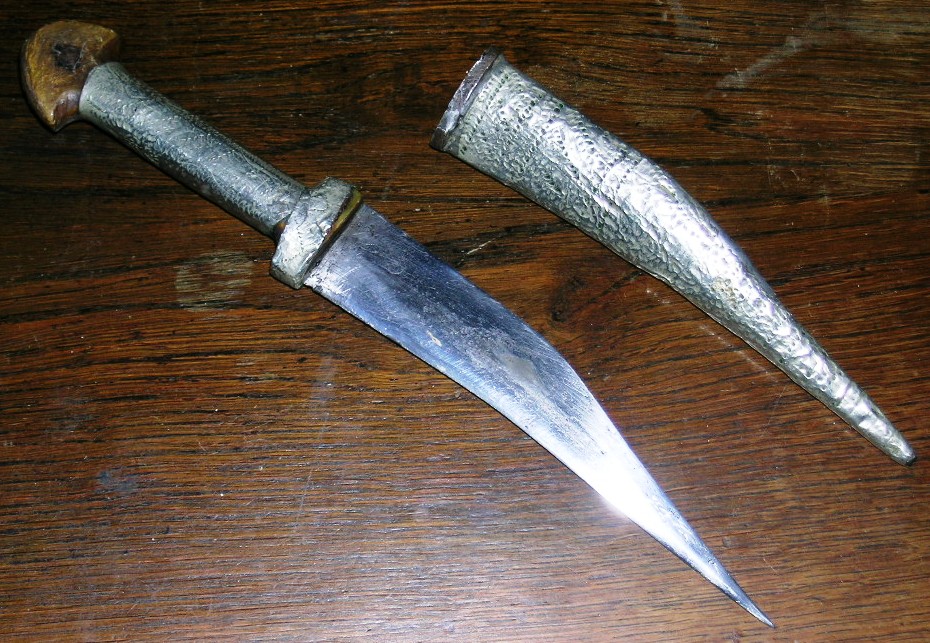

Quite a rough thing but seems to have good age (well for one of these!)
Blade is clearly a file, good thick and sharp, with a central spine.
Scabbard and hilt have been recently polished to a high shine sadly, but good patina in recesses.
Unusual hilt shape, any thoughts?
Hilt is Horn with silver sheet covering. Central sheet has niello decoration.
Must add, might no keep it, so throwing it open for comments before I make a final decision on its fate!

I think at least with the one made from a file we know there more likely "real" Rather than the the mild steel, place marked & dated tourist examples we so often see.
Hilt shape looks fairly common to me? at least both the ones Ive kept are that shape. Ones made from a file as well. The others silver & nielo scabbard & hilt. Ive only erver had 4 or 5 of these, the others had " single peaked" tops rather than the double peak.
I think the lanyard type ring should be on the front not the back though?

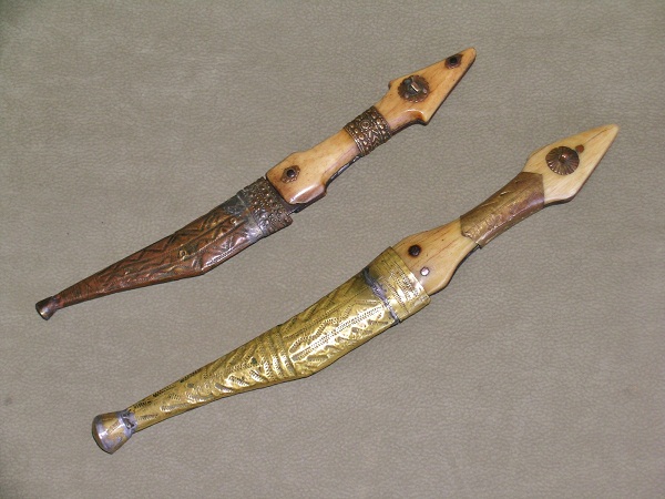

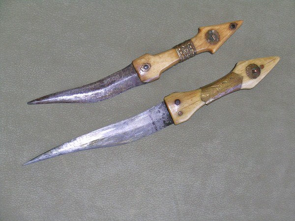

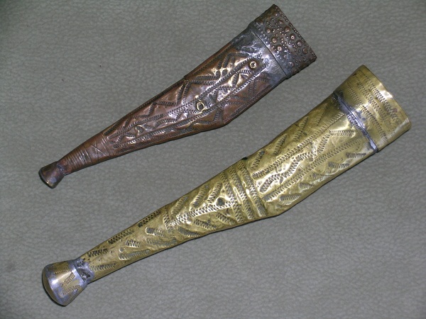

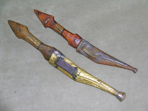

Here we go....
The brass one has a lovely & unusual almst luminescant light lime green shade to its horn grip, which the photos dont realy capture.
There interesting pieces I think?
Spiral

Here is my input: as spiral said, the ring is usually at front. It is not for a lanyard but rather for a small lucky charm, most popuplar was a blue glass bead on a fine chain or leather thong.
When sheet metal hilts are in concern, the scabbard is mostly made of the same material.
The "twin peak" or thumb rest pommel is not very common, but also not scarce. I would date these file blades to in between the Wold Wars.
The niello work is simple but very uncommon to this type of arm. It indicates circassian (highly improbable due to the form) and armenian (most probable) work.

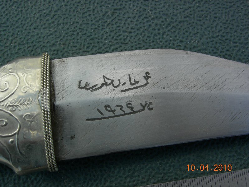

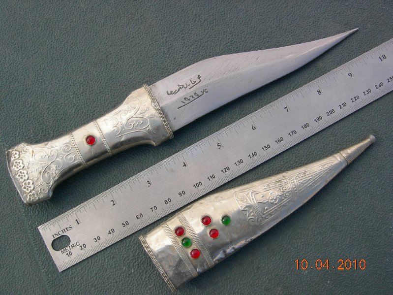

Here you go, longer one is 33cm overall. Though I got each one on different time and occasion (one has been imported from USA via ebay...) they are very much alike.

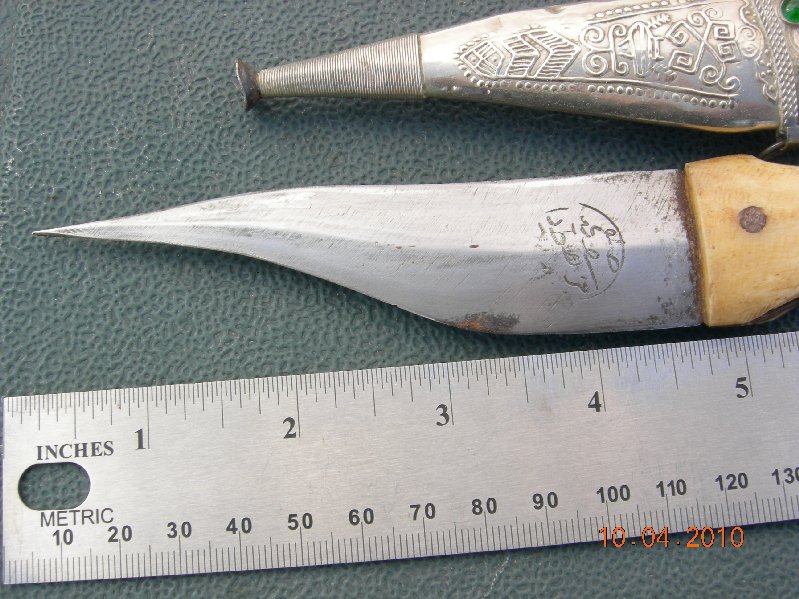

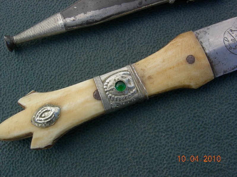

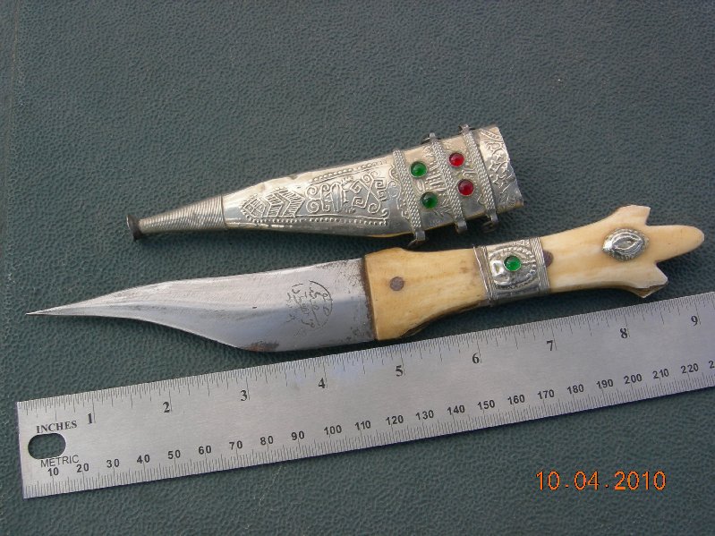

Here are a couple that I've picked up recently.
I Believe that the bone handle one could be pre WW2 and I think the other is a 1964 dated tourist model.

Ahhh! Thanks again Broadaxe for the clarification & also the pics of the bone examples. Interesting to see the blade shape varients.
Intresting bone top on that piece Warren, I havent seen the that shape before.

Indeed, Warren's bone handled specimen is rare, the three-pronged pommel is less common but this is the first I see with a bone handle. I think, though, its sheath has been made later, in the 1950's & onwards fashion.
