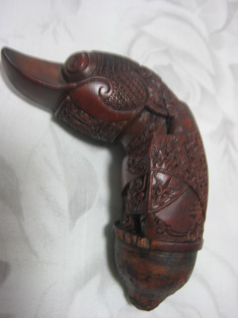

Hi All,
I have a Palembang wooden keris hilt that's very old and light with some minor cracks. Most of the carvings are intact and I would like to preserve this. It has traces of wax which has probably helped keep it in such good condition. Should I re-wax it?

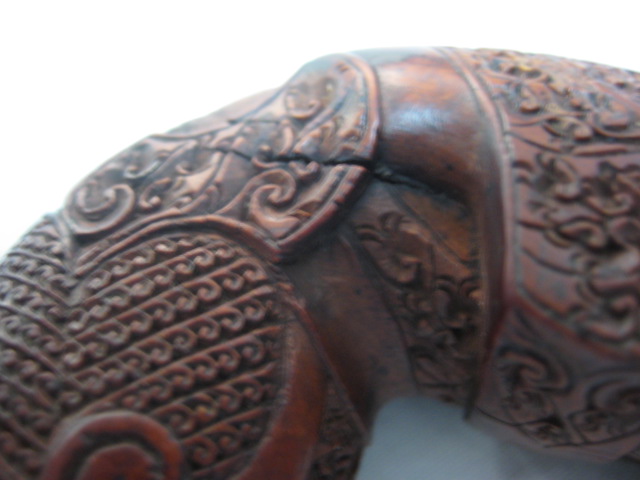

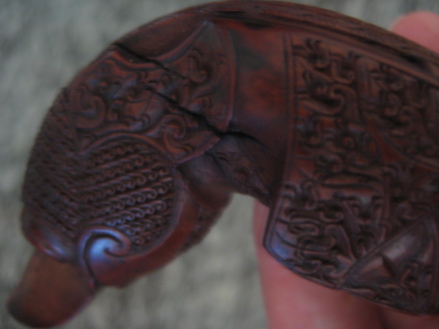

Hi Guys! Sorry I used an old pic of the hilt. I have taken a quick snap of the 2 cracks on the hilt. How should I proceed?
jonng is offline   Reply With Quote
Old 31st May 2010, 05:46 AM   #13
jonng
Join Date: Oct 2005
Posts: 41

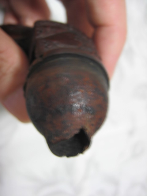

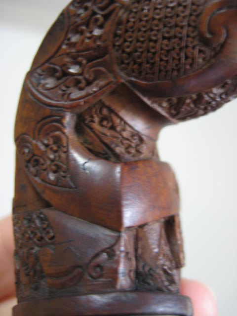

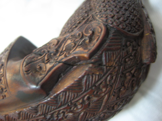

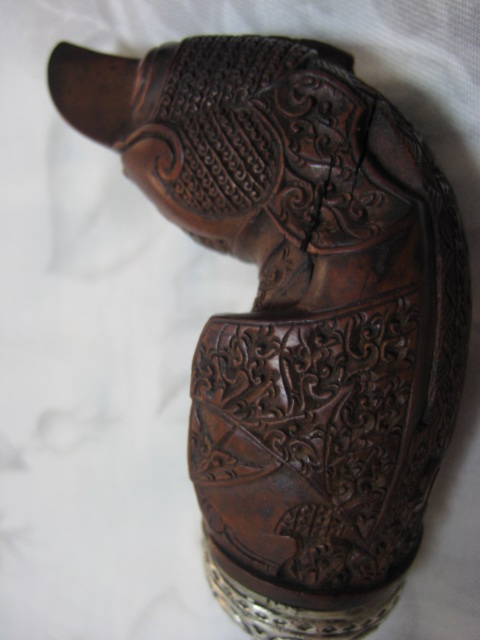

Better pics.

I'ld put a very little red-brown wax inside the cracks (...very nice hit)

It depends what your personal standards are.
If you want to try to make it look as it was when newly carved, you could proceed as Marco suggests, and fill the cracks with hard wax of a compatible colour.
I personally don't like this approach, but I must emphasise that this is a valid approach. My dislike of it is just a personal thing. I used to follow this approach many years ago, and hilts with cracks that I have from 30 or 40 years ago have often been filled with one medium or another.
However, these days I tend to do as little as I can get away with when it comes to old hilts. If I think I can take up cracking with oil, I'll follow that course, but if the cracks are not too bad, I'm more inclined these days to leave them as they are.
My objection to the use of fillers is that they are a purely cosmetic approach that does absolutely nothing to assist preservation:- in other words, they can make something look good for perhaps your lifetime, but in time the filler will fall out and you're left with a hilt that still needs attention.
We only have a loan of any of these things --- keris, hilts & etc. If we truly have a love of the art and a respect for the craftsmen who produced it, we have an obligation to try to make it last another generation or two.
If this were my hilt I'd probably start hand rubbing raw linseed into it. The cracking is not bad, and I could easily live with it the way it is, but that wood looks hungry to me. I'd probably put this alongside my lounge chair and feed it with hand rubbed raw linseed for a couple of months and see what happens. Just a few drops in the palm of your hand and rub it in until it disappears from the surface of the wood, and your hands. Concentrate on the cracks and try to work the oil into the cracks.
A. G. Maisey is online now   Reply With Quote
Hello Jonng,
Nasty cracks, I would do as Marco suggests (filling with dyed wax) or as Alan if you have enough patience! By the way the hilt is very finely carved but does not seem VERY old to me as there is no clear sign of wear to the carved motifs (see my specimens for reference).
I tried olive oil which is excellent for nourishing the wood as mentioned by Alan but... it stinks after drying may be unless you rub and rub again.

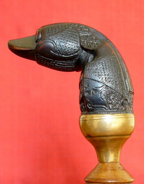

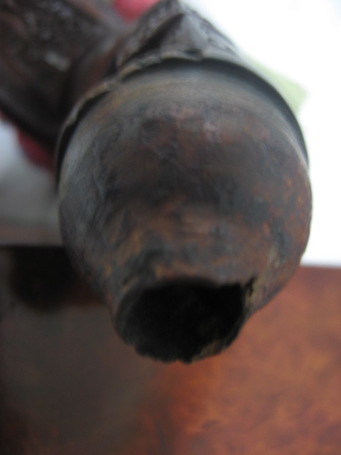

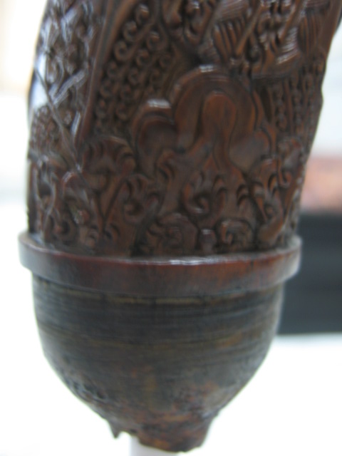

Thank you all for your kind advice. No luck buying raw linseed oil so far. I have oiled it with olive oil and almond oil. Olive oil disappears in minutes. Almond oil stays longer. Some chatoyancy is appearing around the beak/ nose, eyes and "fang" which is nice.
How old the hilt is? I'm not sure. It certainly is not a new one. I have added a few more shots. Maybe forum members would like to have a go at it's age.

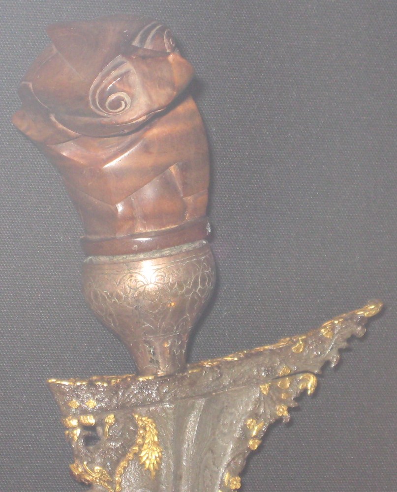

This one is from the Asian Civilisation Museum. Wood seems similar, but not elaborately carved, to show off the nice chatoyancy. Dated late 19th century if I remember correctly.

As I mentioned the British Museum scientist found that commercial waxes based on the usual natural waxes contained acids which,in time could spoil original finishes on collections of furniture.
When thinly applied Ren Wax is glass clear with no discoloration either of the wax or the underlying surface.I gather that on furniture and wood carvings the wax echances grain patterns.It protects existing finishes such as french polish and it can be applied to sanded unfinished hardwoods.
Should surface repair or restoration be needed,Ren Wax can be removed by rubbing with white spirit.
Alan,I was interested to read that you use Antiquax.I used this till very recently when the tin was empty,and I couldn't find some more.But I used this on wood,not on metal.I agree that wood and metal have to age,I don't want to freeze a finish.I am concerned to protect wood and metal finishes from mould and rust.
I have found that Ren Wax is very effective in protecting gun stocks from mould in damp conditions,and european sword blades from rust.
I'm a small private collector,not a public museum.I do like to get the pieces of my collection out and enjoy having them.This includes friends handling them.
I recently cleaned some rust spots from a Balinese blade with another product from the same source as Ren Wax.I have now applied a thin layer of wax and will be interested to see how effective the cleaning job has been.
The cleaner is Pre-Lim Surface Cleaner,which is used in professional restoration of arms & armour,sculpture,brass & copper exhibition cookware ceramics and other surfaces.
Formulation is based on blended Neuburg silica chalks in a water/white spirit emulsion.After cleaning an application of wax is recommended.
I would not have used Ren Wax,or Bees Wax,or Antiquax on finely carved keris hilts,or to fill in a split.Most of these applications are to heavy,and difficult to remove ,as Jean has mentioned.
If I have a split hilt or sheath I prefer to leave to piece as it is,apart from cleaning it.
Also with a finely carved piece ,such as th Palembang hilt illustrated by Jonng,I would not want to clog up the carving with wax.I prefer to keep the piece clean,with a light wipe with Ren Wax,or an oil.
I don't keep my collection in the open,or hung on the wall.The dust and salt spray is too strong.But in wet periods,I still have to check for mould or rust.I sometimes think that I would enjoy seeing my keris as I walked into a room,however I know they are there,in drawers,and I enjoy getting some out from time to time.
I agree with Alan about using baby oil for ivory,works well if the ivory is dry.
