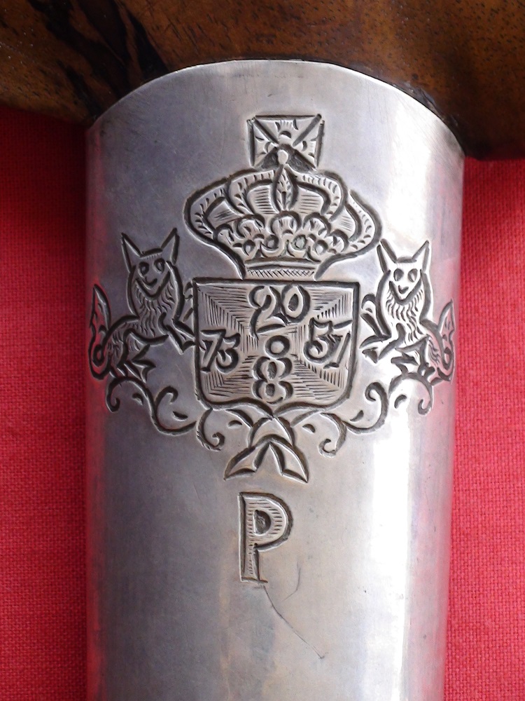

pendok silver ho can tel me te meaning on the back of the pendok

I'm not sure why no one has commented as of yet on your post. I am rather fond of this dhapur and like your example. As for the meaning of the numbers on the back of the pendok, i suspect this is more likely talismanic (numerology) rather than a date and as such is probably not decipherable by anyone other than the original owner or creator.
Old 4th November 2014, 04:30 PM   #3
Posts: 7,303
If this were a Surakarta keris i would image the "P" might represent one of the Pakubuwonos, but since it is obviously Yogyakarta dress i have no idea.

I do not recognise this crest, it is not Pakualamanan, Kraton Jogjakarta, nor is it Mangkunegaraan or Kraton Surakarta.
In fact, it looks like a trade mark, but the numbers puzzle me, I have no idea what they represent. Sometimes you'll see something like this with numbers that can be aligned to a date and represent a birthday or anniversary, or some other important event; at other times you will see a "magic square" with numbers having a talismanic intent, but I cannot see either of these things in this number arrangement. I don't know what it is.

This is my first post here so please be gentle. I found the crest stamped similar to a woodcarving I have from Madura. The heraldic nature of it reminiscent of the V.O.C influence there. I'm not in any way proposing that the Keris itself is Madurese, only that the stamped crest may be.

Well, it looked similar to me anyway. I suppose I am missing something.

I wouldn't take it personally. I'm not sure what could be said in reply. The keris in question is clearly not from Madura. I am not sure what crest your carving represents. It is not a very good carving by Madurese standards so i doubt it was used in any official capacity. There are certainly clear similarities between it and the crest on the pendok. It might be possible that if this crest has some significance in Madura this keris might have been owned by someone living in Jawa of Madurese heritage, but i'm only speculating these.

Thank you David. I think the woodcarving is probably just a headpiece from a piece of semi-cheap furniture, but I really lile the mix of European and Asian which so many ornaments from Madura display. I picked it up in some curio shop in Sarawak and I really enboy it. When I saw the crest on the Pendok I felt wanted to share this with you all.
