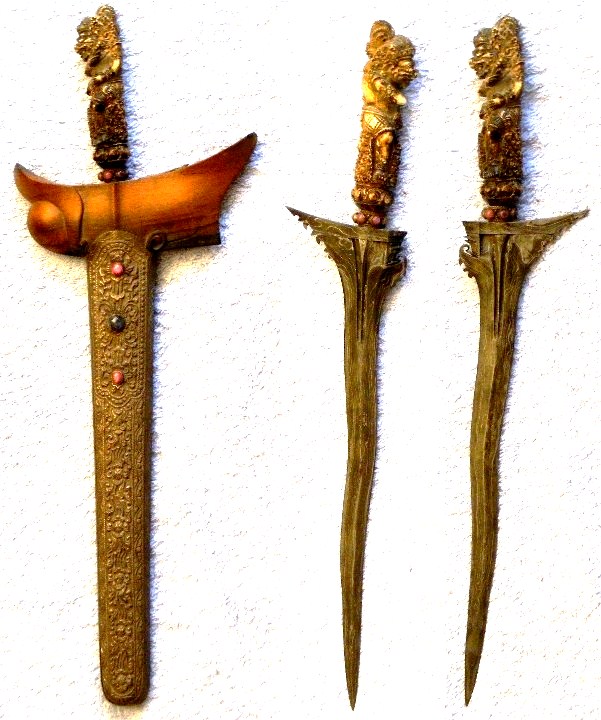

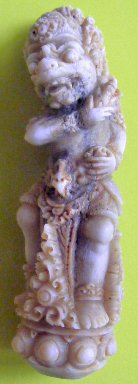

On july, 19th 2008 Semar posted a nice picture of his balikeris with Parasvati-hilt. In the replies various colors were mentioned of the
ivory: caramel and dark brown. Some months ago I've bought this bali patrem-keris and would very much like to know the following:
1 - on internet I found the following definition: QUOTE It is called patrem if the length of the keris, measured from the 'Ganja’ until the
point of the Keris, is as long as the length of one span of adult human footstep UNQUOTE. If this is the standard, which foot are we talking
about: my size 11 or anyone else's size? Can't find an inch- or cm-definition.
2 - Which person/god/demon is my hilt representing?
3 - Can't determine whether the hilt is ivory ore bone because of its color (and yes I did the needle test) and like to remove the brownish
color if that can be done at all.
4 - Like to clean/polish the pendok as well. Tried various methods (cloths, silverpolish as well as lemonjuice) but except for a very light
improvement it doesn't get me anywhere.
All your expertise will be very much appreciated, THANKS

Hmmm....i don't think your hilt is ivory, or very old for that matter. It might be bone, but it is hard to tell with all the gunk they painted onto it to give it the appearance of age. I generally clean up ivory and bone pieces with a toothbrush and a little bit of mineral oil, but since i don't know the natural of the applied black stuff i don't know what you might need to remove it.
I suspect that your blade is also contemporary and as such it's origins are more likely Madura than Bali, though this is still a "Bali-style" keris. As for whether it should be called a patrem or not, how long is the blade? I am not sure if there is any hard and fast rules for this, but i usually count blades under 10" as possible patrems.

The blade is 9 inches long and yeah perhaps I've been mislead by the gemstones on mendak and pendok to call it Bali. As for the hilt I will give it a try. Nevertheless I hope to receive more suggestions to clean the hilt.
Thanks again,

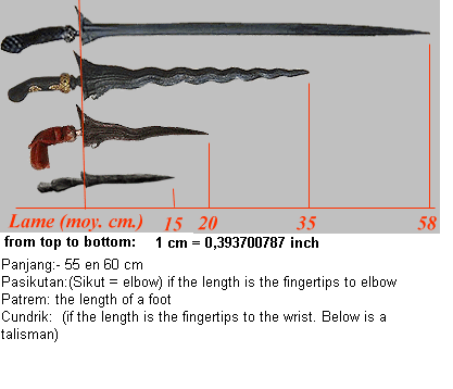

about your question about the length of one span of adult human footstep
I found this on the net, you might find it useful.

certainly guwaya,
but it is a French site so it is all written in French
(If you do not understand french, maybe you can translate with the google toolbar)
http://blade.japet.com/KRISS/KERIS.htm

I would be inclined to leave this keris exactly as it is.
I rather feel that attempting to alter the intentionally created appearance of this keris might result in some unintended surprises.

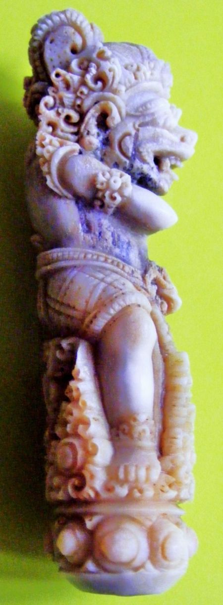

Alan,
I do agree with you to leave (certain) things as they are, got curious though to the material of the hilt. I followed the tips I received however before your reply reached me. I wonīt say Iīm disappointed so far because here are the results of an overnight soaking (two times) in denture cleaning tablets (as an addition to the tip of Asomotif ) and brushing with oil and toothpaste. I think it is bone material, donīt know what bone though, could be deer as well as karbau ??
Donīt know either who this is, Hanuhman or Sugriva or ........? Canīt find a tail at his back and wonder what he is carrying in both right (rujakpolo?) and left hand. Some surprises? Yes, there is some damage, deep scratches at the chest and lime at the jaw. Well, it is as it is. Decided to leave the pendok as is, because I noticed some detachment at the side of the pendok.
Regards, njo

Posts: 7,303

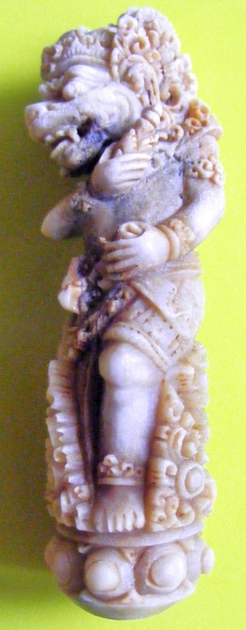

Might be your photography again, but frankly this material looks a lot more like some kind of composite material to me.
Ignorent guy (me) David, how can I determine composite material?

Posts: 6,441
The red hot pin test .
Poke it somewhere it will not be noticed .
Go by the resulting smoke smell .

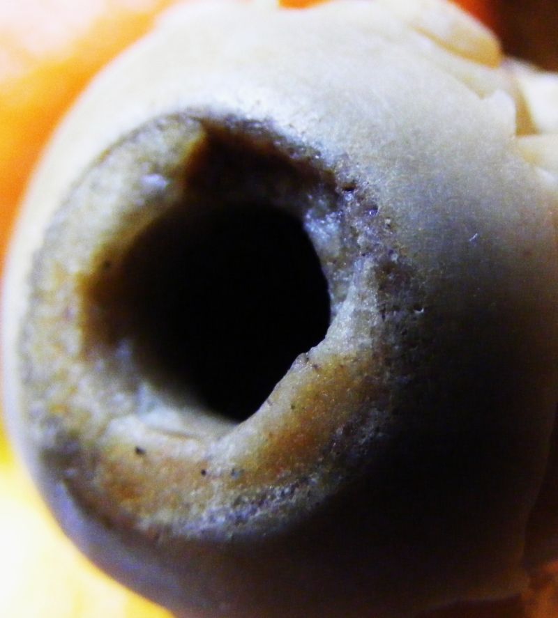

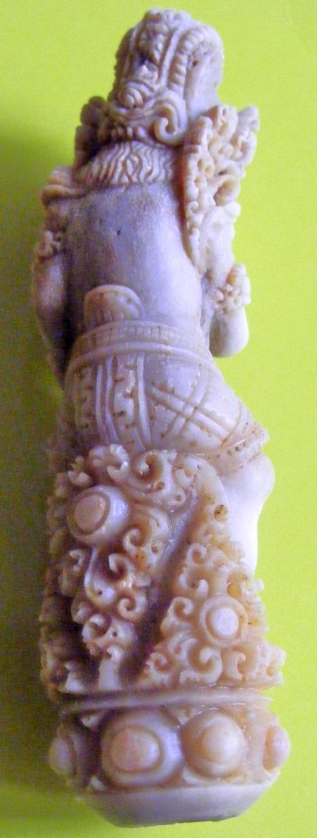

Rick, he said he did the needle test in his first post, but i wasn't clear as to the result. This stuff looks very suspect to be though. It doesn't look like a natural material in many of the close-ups.
Old 23rd January 2010, 07:20 PM   #20
Posts: 6,441
Ah, I missed that David .

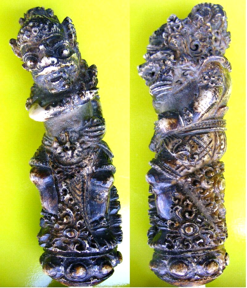

I see what may be a casting bubble in the third picture down in post 15; look at the crown, right hand side .
There seems to be a certain translucency to the material; the darker, more porous areas would indicate bone or horn .
A puzzler .
Njo, what did the hot pin test smell like ?

Posts: 2,238
Hello Njo,
Interesting result after cleaning.
The surface looks crystaline in some places.
Especially the pictures from the bottom.
And indeed translucent in some areas.
Based on these pictures I would almost say that it is some kind of stone / marble like material.
Is it heavy ??
Ps. what did the hot pin test do ? Any smell of burned hair
If it is a sort of stone a hot pin would do nothing I guess.
Maybe you can finish the hilt with some dark antique wax an rub that out again. Tha will accentuate the carvings and relief again.
Although now cleaned the carvings look better than before cleaning
Willem

Rick David Asomotif
The burn test gives a wooden smell (did the test on the hilt as well on an Indonesian statue cut out of horn to compare, both with that result, so perhaps my nose is not that fine anymore )
Itīs heavy compared to his size

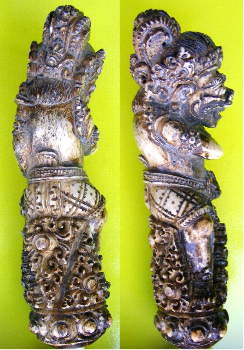

Some BW pictures if that may help (perhaps a workshop in taking good pictures for this forum?)

Posts: 6,441
Arrow
I think the problem we run into with positively identifying these Bali Figural hilts is called 'Artistic License' or 'Carver's Interpretation' .
Unless they are unmistakable in their form they are open to interpretation .
Old 25th January 2010, 09:37 PM   #26
Posts: 7,255
Yes Rick, that's pretty true, especially with figures that are current era production.
If we go back to before about the 1930's, I think we probably see figures in Balinese carving that are more readily identifiable with specific entities, but when we move into the current era we find a more free interpretation by carvers, and a lot of figures that could be regarded as generic representations.
I'm not talking just about keris hilts, but about Balinese carvings of all shapes, sizes and qualities.
In the case of this hilt under discussion, I feel that what we have is a generic demon --- the fangs --- so let's call him a raksasa.
