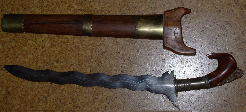

Hello together
have long been the keris, but unfortunately just do not know where it comes from or what tribe he had worn.
how old is he?
thank you for all the information
blade length: 35cm
handle length: 13cm
smells like rosewood?

Sorry, but this is not an Indonesian keris, it is from the Philippines in the style kris of the Moro. This doesn't appear to be an old one, probably late 20th century. This forum is for Indo keris only so i am moving this to the main forum.

I agree that this seems to be a recent kris. The handle is wrong for this and recently made and the scabbard is also recently made looking to be possibly Maguindanao. Sorry.

Interesting & odd little kris. It almost looks like a composite piece with a barung hilt. But even the metal work on the hilt is odd.
The blade doesn't look like a tourist blade & everything shows some wear & a little age (50/60's?).
Could it have been a training kris for a boy? That might make sense using a barung type hilt so the mini sword doesn't slip out of a inexperienced hand.
I've seen some pretty young boys being trained with wooden bolo's in the Visayas, so it wouldn't surprise me somebody had this made for their boy.

I know it is not easy
so I am looking for specialists. New touristenkeris no! The blade is good! has wrought tracks! metal deposits are good, brass, copper, German silver.

I don't anyone is suggesting it is new, just not an old one. It looks post WW2 to me. Could well be the late 50s or 60s. It definitely has some age to it.
Though i won't necessarily call this a tourist kris i must point out that brass, copper and silver materials are often used on them. This blade does seem a bit meatier than your average tourist blade. Most certainly though it has a mismatched hilt. This is not a kris hilt and clearly wasn't made for this blade.
It's size is unusually short for a Moro Kris at about 13 in. Bill thought about a child's blade might hold weight, but i wonder how much serious kris training kids still got in the Philippines of the 50s and 60s. Enough to warrant making a real blade for the workouts?

I agree that this is not one of those crappy blades (which don't deserve the name kris) made for ignorant travellers. However, Moro kris this small (and with fancy fittings/inlay) do seem to be a relatively recent development (WW2 and later) and the (barung) pommel style isn't old, too; IMHO the scabbard also doesn't suggest an origin much earlier than WW2.
Can you ascertain wether the unusual brass grip was made by the lost wax method?
BTW, are you sure that's not real silver utilized for parts of the inlay?
