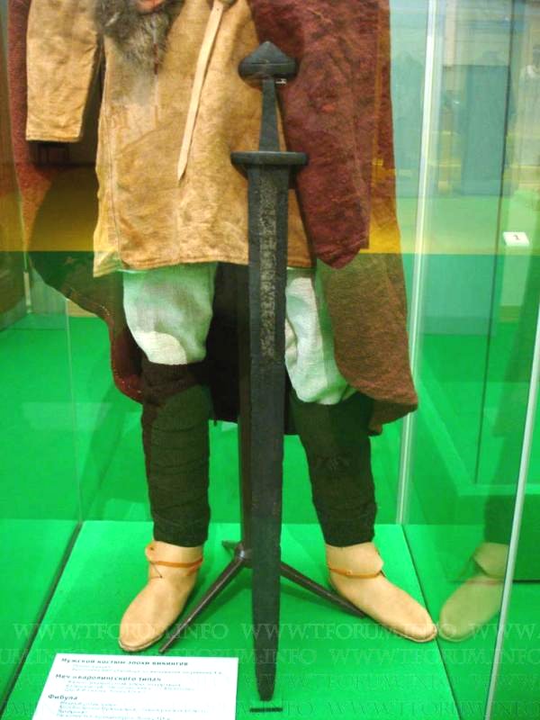

Default A Viking Sword With Inscribed Blade in a Moscow (?) Museum
Please see
http://www.tforum.info/forum/index.p...eq=si&img=2362
on the Russian Forum.

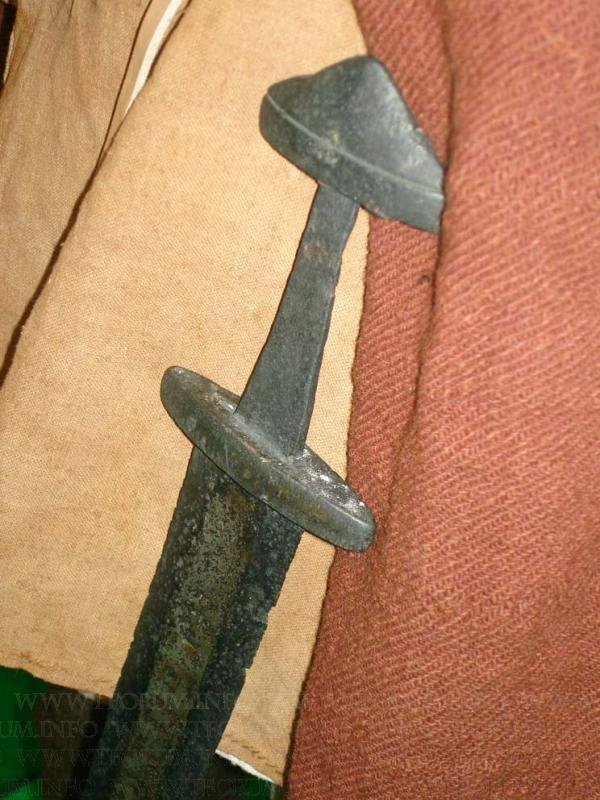

Although I have always much admired Viking swords, I honestly have never researched them in any depth....this illustration has certainly inspired me, and one of the best references is "Swords of the Viking Age" ( Ian Pierce, 2002). While the late Mr. Pierce is named as the author, Dr. Lee Jones was also instrumental in the production of this book, along with the late Ewart Oakeshott. These gentlemen together produced a book that is in my opinion key to research on these historic swords.

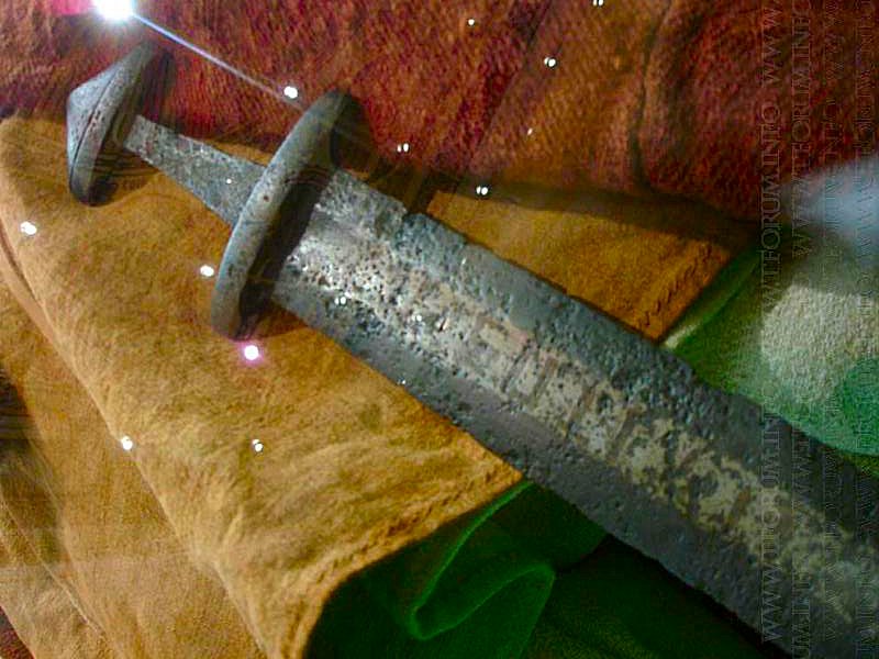

The excellent example shown here, as near as I can estimate, is closest to the example illustrated in Plate III, which has similar construction as well as the iron inlaid ULFBERHT name. I cannot quite make out the large lettering on this blade, but it does appear to be a variation of the Ulfberht name.
The pommel/ upper guard in triangular configuration and shape of the lower guard seem to correspond to the Petersen (1919) reference as Type H.

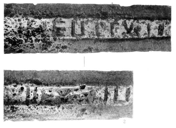

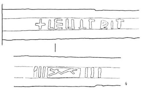

I had a go at the sign that accompanies this display, (hoping to determine if the sword is an original or a copy) and was able to glean a little more about the sword despite my complete lack of Russian. The sword is signed on the blade, Ulfberht-style, with the name ‘Leutlrit,’ and thus may have been made by the same sword smith who forged the more famous River Withham sword in the British Museum. That one is graced with an excellent Anglo-Saxon hilt, this wears a Petersen Type H. The section on the River Withham sword in “Swords of the Viking Age” mentions another in Russia, and since the spelling of the name and find place of the artifact match, this must be that sword at the State Historic Museum in Moscow. The illustration in Kirpicnikov is labeled “Альметьево, бывш. Чистопольский у. Казанской губ. (тип Н, X в., ГИМ, хр. 12/1) which corresponds well with the signage.

I was able to locate a PDF version (by googling “Кирпичников Древнерусское оружие”), and this sword is pictured therein, Plate XVII # 4 (as well as Plate XIX #s 1+2) with the caption below calling it out as (I presume) GIM Inv. # 12/1. However, in the catalog of swords starting on p.73/74 of the pdf, #16 is a type H (column 6), there is Mr. Sizov again in column 3, so you’d think that is the sword in question; but the inventory # is 117/85. In that table, Inv. # 12/1 shows up in the row for # 43, listed as a type E sword. Which do you think is the correct inventory #?

I took another look at the illustrations of this sword and found something pretty amazing on the other side of the blade. Where many of the signed swords of the 10th century have an interlace or similar decoration on the ‘B’ side, this one has the running wolf of Passau!
Could it be the first example of that trademark?
