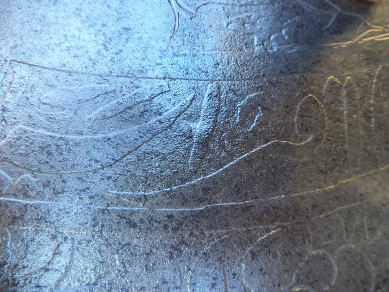

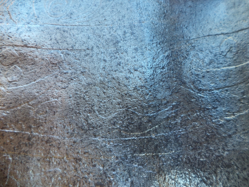

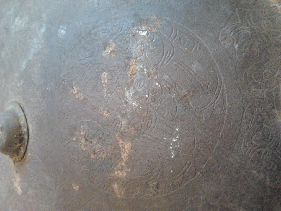

The old shield has been presented elsewhere.Now is mine.I restored and now looks better.I do not know what is written on it.He is shield before restoration.

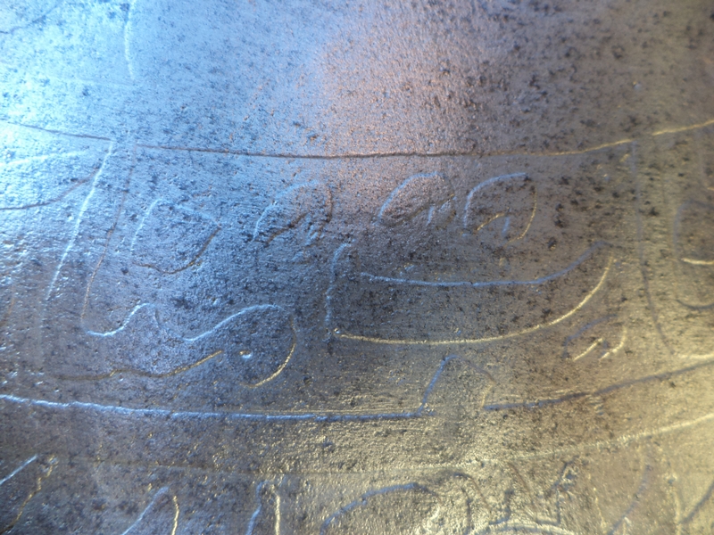

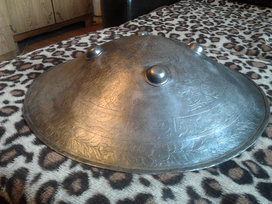

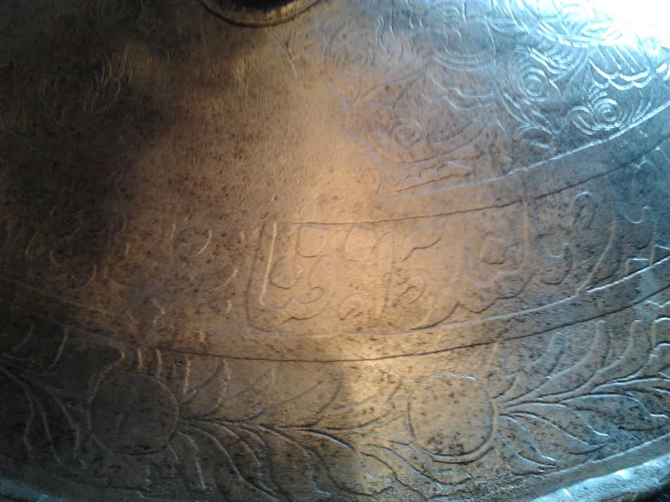

Shield after restoration.I want to help me with translating the text from the shield.Thank you very much.

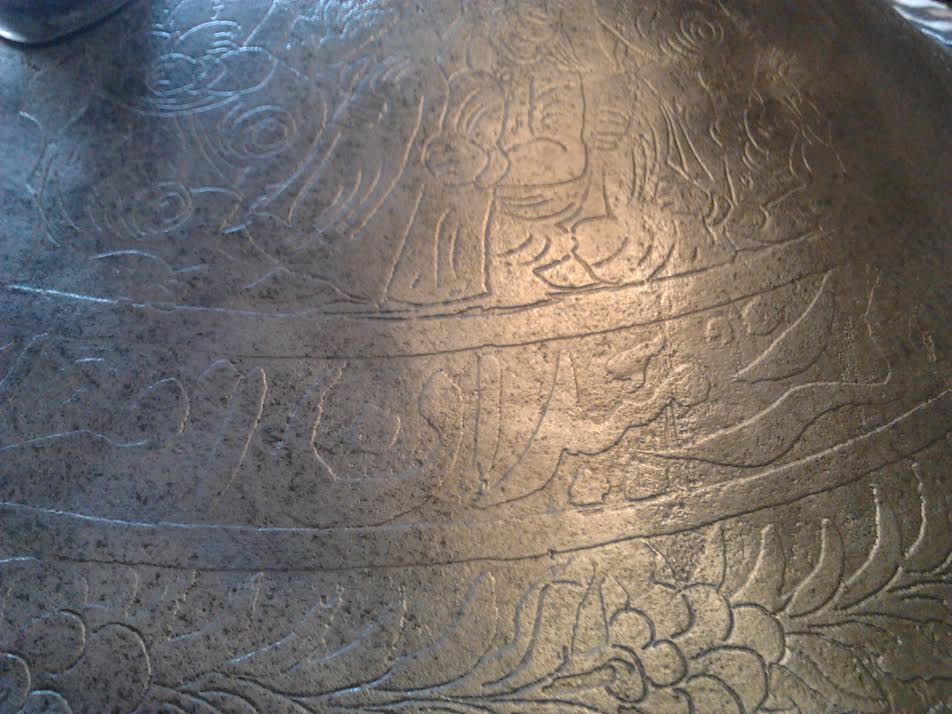

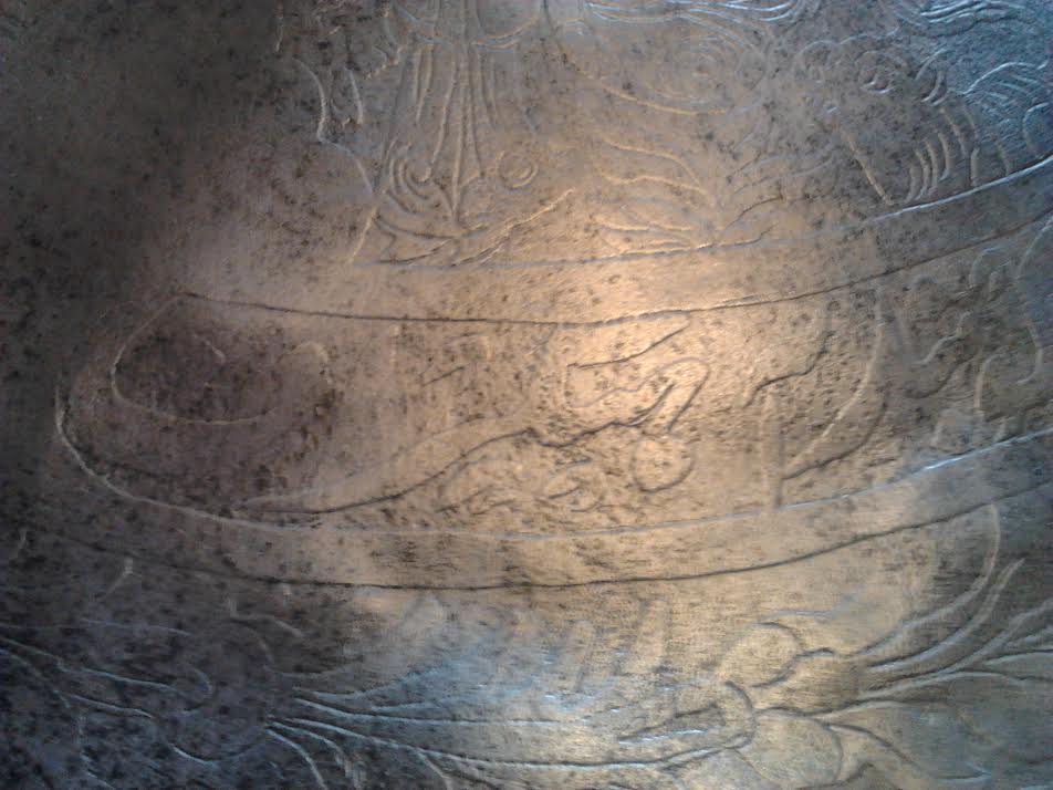

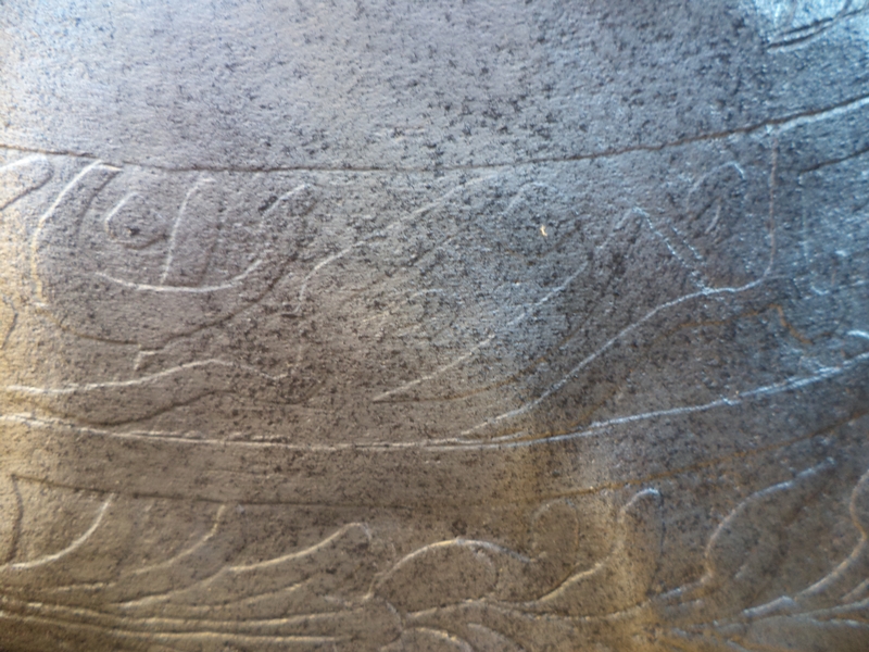

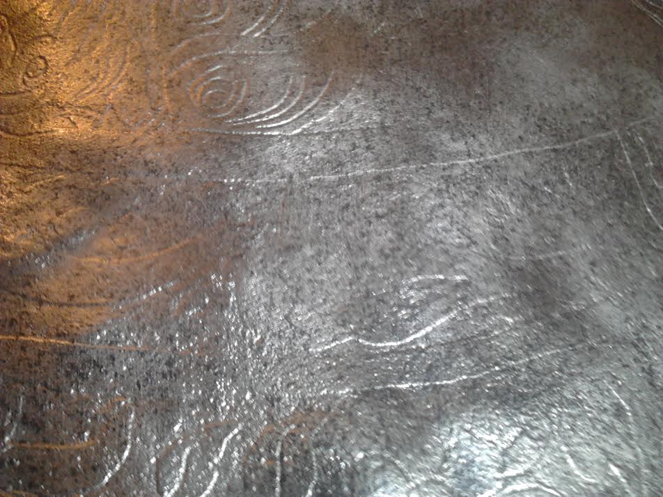

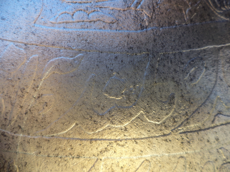

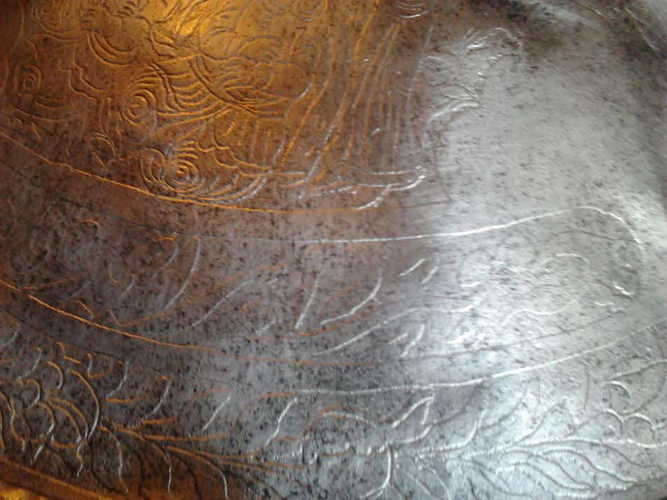

And other pictures.

The shield I put in a plastic box over it poured vinegar 9 degrees. Everyday you clean it with hot water from the sink with a plastic brush, then enter back into the tank with vinegar repeating this process for 7 days.In the last day after I removed the vinegar and I rinsed and cleaned with plastic brush, I rinse well .No is immediately as gloss metal. After a good drying I gave wire brush .After the treatment with vinegar were removed about 1mm layer of rust.Rust finding the bottom of the bowl with vinegar. Put vinegar to cover the shield.This process is not suitable for objects worn.Vinegar can attack some important details.The object is kept under control.
