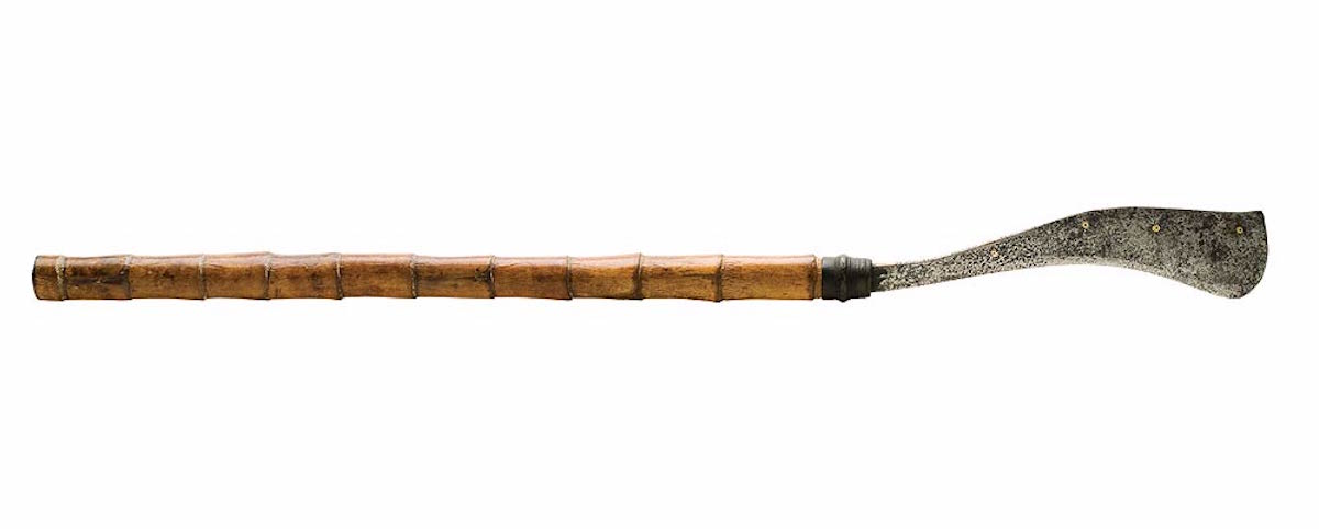

The coconut chopper function of this one was confirmed by my sources as well. It is interesting to note the detail in the construction of this one and its decorations. These choppers do come in various sizes, although this is the sturdiest one I've seen. It is interesting to note that other chopping tools from the general area of mainland SE Asia can be quite elaborately made and decorated. The example of a Thai pra (attached) has another well made and decorated blade with a plain, business-like shaft.

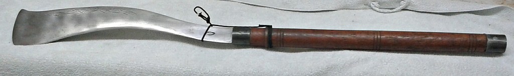

Another Thai Pra with a decorated blade, steel fittings and a simply decorated hardwood grip emulating the joins on bamboo or a rattan haft.
(the string is looped around the forte to let it hang properly on the wall, not far from my head as I type, as the balance is pretty much at the blade/bolster join.)
