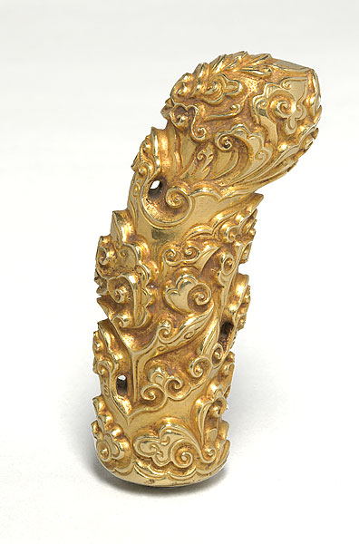

Default gold hilt
http://cs.nga.gov.au/Detail-LRG.cfm?IRN=140710&View=LRG
nice and rare.

Very nice. Let's just put it up here. You never know when these linked sources will just disappear.
The information on this site says the hilt is gold and cinnabar. This confuses me a bit because AFAIK cinnabar is a mineral that is basically the ore for mercury. I am not sure how it can be used to make a hilt. Any ideas?

cinnabar is a blood red mineral that carves well and is used in conjunction with gold to produce jewellery.
could this be a gold cover on a cinnabar stone core? any red bits showing on th other side perhaps? i find it hard to believe they'd make that of solid gold. aside from the expense it'd make the keris quite heavy to carry if it were and the balance would be terrible.
or more regionally correct an indonesian talisman container made of gold, silver and cinnabar
you can just make out the dark red-brown stone behind the gold scrollwork.

Ah, thanks, i didn't realize they used it this way. The hilt most probably is not solid gold, though if it were it would be a matter of status and not a fighting blade so balance would not be an issue.
I think it is fairly clear though that the gold is overlaid on something for this hilt. I would imagine if it is cinnabar that it was a mighty big chunk and is probably pretty heavy as well.

This gold hilt is in the Asian collection of the Australian National Gallery.
It is identified as from Sunda, and as the hilt of a keris.
Additionally one of the materials used in its construction has been named as cinnabar.
There are several things that I find strange in this attribution and description.
The major question for me is how cinnabar was used in its construction.
This type of hilt is typical of a Javanese pedang, not a keris, and the way in which it is made is by embossing the motif into a shell of metal, which is then joined and chased, and filled with either a shellac mixture or a mixture that includes damar, a natural resin.
I cannot understand how cinnabar enters the equation.
I have noted erroneous descriptions of Javanese objects in Australian collections and exhibitions in the past, some that were really ludicrous. I suggest that perhaps the description of this hilt might be taken with caution until a confirmation can be obtained.

that is interesting, i found a notation that chinese cinnabar statues were actually made of laquer with cinnabar pigment which was built up in layers before being carved....
Lacquered art pieces have been produced in China for many centuries. Lacquer is produced from the sap of the lac tree, which is commonly found in central and southern China. Various pigments are added to the resulting lacquer to change its color, and then the lacquer is applied in many coats to an art object. After many coats, the lacquer is carved, producing unique designs, patterns, and subjects. On lacquer, which was prominent throughout China, was cinnabar lacquer, which was made by mixing a seemingly innocuous mineral called cinnabar with lacquer. Cinnabar lacquer was used on a wide variety of pieces ranging in size from jewelry pieces to large ceramic or metal vases.
Cinnabar is a mineral that appears near volcanoes or hot springs. It is rich in mercury and, when ground into a fine powder, produces a deep red tint. It was believed at one point that the mercury's toxic effects could be neutralized with heat, but it appears that science has proven this theory incorrect. However, Cinnabar lacquer was produced and carved for many years before the toxic effects of mercury were discovered.
The production of a cinnabar lacquer piece is a fascinating and time consuming process. First, the base work was produced, whether it was a vase or a brooch. Next, layer after layer of cinnabar lacquer was applied. Often layers would alternate in color to achieve a multicolor effect in the design, and some pieces would feature more than 300 coats of lacquer. Each layer would have to dry before a new one was applied, so some pieces could take almost half a year to prepare – some larger pieces could take years! Once the lacquer layers had reached the correct depth, the carving process could begin.
Carving a cinnabar lacquer piece was a very delicate process, and could take the artist many years to complete. Care was needed, since a slip could require filling with many new layers of lacquer or could necessitate a complete re-do of the entire project. Once the carving was finished, another layer of lacquer would be added to seal the carving. Clear lacquer with no cinnabar was often used in this final step to keep the piece from spreading mercury to the skin – this was especially important for jewelry pieces.
Many cinnabar lacquer pieces are still available at auction, and are highly prized for the richness of color and intricacy of carving. Minimizing exposure to these older pieces is essential to prevent any contamination, but pieces kept behind glass can still be a valuable part of any collection. While true cinnabar lacquer pieces are hardly ever produced today, many carvers work with simulated chemical cinnabar in their lacquer. This has allowed carved lacquer pieces to remain in production, without the harmful effects possible when working with cinnabar.
maybe we are converging on it. pine rosin and brick dust are a traditional western cutlers cement, jabung as noted above is much the same, throw in agm's shellac. red powdered stone/brick all much of a sameness all of a sudden, some sort of resinous shellac/laquer combined with a red powdered stone/brick used as a cutler's cement. we now cover east and west.
