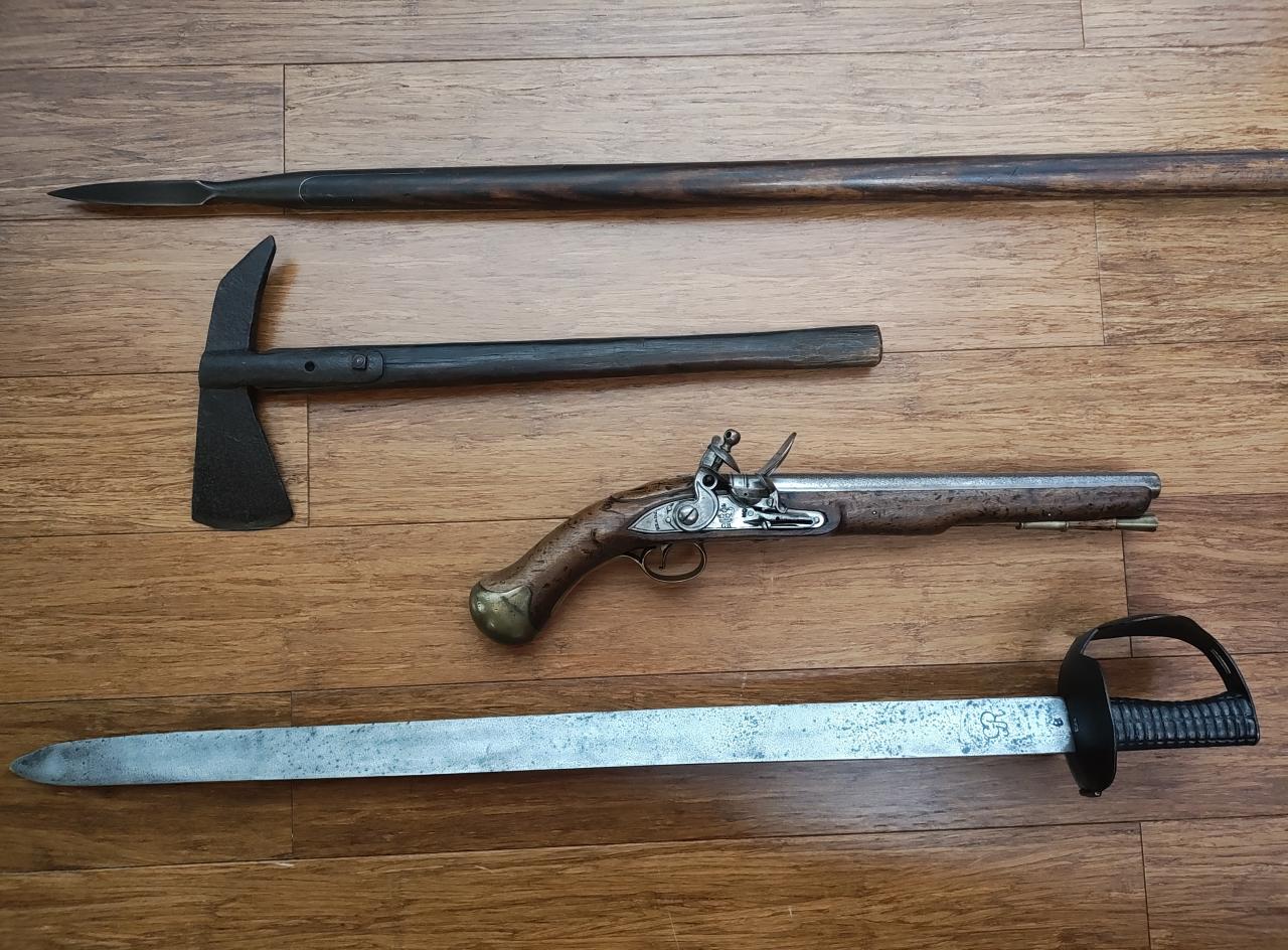

I thought I would capture this grouping before I put the pike back on the wall.
It is not entirely chronologically accurate because the pike is the 1888 model but the rest are representative of the weapons used by the crew in boarding actions in the early part of the 19th century.
Boarding Pike – Tower Armoury
Boarding Axe - Sargent. It has lost some of the shaft and would normally be 2’ long.
Long Sea Service Pistol – Tower Armoury. This is a monster, it has a 12” barrel and is 19” overall length – compare the size with the cutlass. It is also heavy 3.3 lbs (1.5kg). It is no surprise that reports indicate that once fired, seamen often just chucked it at the enemy to be rid of it. Many of these were shortened, by the admiralty, to a 9” barrel to make them less cumbersome.
The 1804 Cutlass – Craven. Marked with the cypher GR.

That is quite a neat set. Is it possible to see the Ordnance markings on your pistol please? Close up photos of the stamps near rhs of the trigger guard, in the ramrod channel, on the lock, the barrel breech and the side-plate flat?

Wow, CC! This is an amazing grouping! I especially love the boarding axe! I haven't been able to add a great naval use pistol to my collection yet, but hope to do so in the near future. I have the brass bluderbus with the spring-loaded bayonet, but most of my other 'guns' are associated, but not true naval issue. Yours is a great one! As you always say to me, great to see some maritime sea-service items!

Fantastic grouping CC!!!!!
Seen together like this really puts perspective to the circumstances at hand with naval warfare. As noted, while the pike may not be chronologically correct but that is irrelevant as these weapons remained in use for long periods without significant change to elements.
The boarding axe is noted as SARGENT. I would presume this to be William Sargant of Birmingham working there 1803-1814, after that he was partnered with James Wooley. It is noted that items marked to him were found in War of 1812 sites.
It is confusing on the spelling with his name listed SARGANT in references, but not unusual to see variation, its the same guy.
The CRAVEN cutlass is amazing! For a long time it was thought that Thomas Craven only worked 1818-1820 in Birmingham.......one of my very first swords (c. 1866) was a 1796 disc hilt by Craven, and that was the data available in those days.
We now know he worked 1799-1802 at 96 Moor St. Birmingham (Bezdek).

Hi Adrian, I remember that you are an expert in the world of firearms so I'm guessing that you are probably tactfully asking whether the pistol is one of the fakes! I knew about them so I'm confident mine is not.
I have had my share of mistakes over the years so I am much more careful these days.
Apparently back in the 1970s a company in France (?) manufactured a load of Long Sea Service pistols that were almost identical to the original. Well made and complete with inspection marks. I don't think they were made as fakes but as reproductions for re-enactment or for black powder shooters. However they have become fakes and regularly fool auction houses, dealers and collectors. Many years ago, one respected researcher and author noted them as 'made by the Tower but of inferior quality to save expense' in his book of the time but notably removed from his next edition!
There are many LSS pistol survivors, which regularly come up for sale - so there are many pictures to study on the net. I passed over a few that I was not 100% sure of, until this one.
This is a really good explanation of what to look out for if anyone is interested in buying one.

Thanks Mark.
Good British boarding axes are hard to find and this one is in a poor state. It's photographed on its better side as the other is missing the langet.
A good Sargent came up for sale at an auction in London last year. But it went for silly money - way past my bidding limit. More annoying was that the buyer contacted me a few days later, through my website, to ask my opinion on his new acquisition.
The pain slightly diminished by me knowing how much he paid for it!
