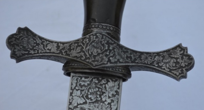

Good day dear members,
What about this one ?
Maybe some of you has seen it in an auction.
Older blade and later nielloed silver mounts ?
Glad if someone has already seen the monogram
( AB ?? )

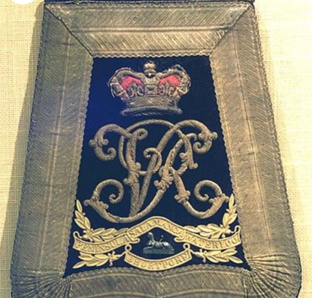

The crown over the monogram meaning this sword belonged to a noble person ?
Old 23rd May 2024, 04:09 PM   #3
francantolin
Join Date: Sep 2014
Posts: 973
Hello. thank you Fernando
Yes, sometimes...

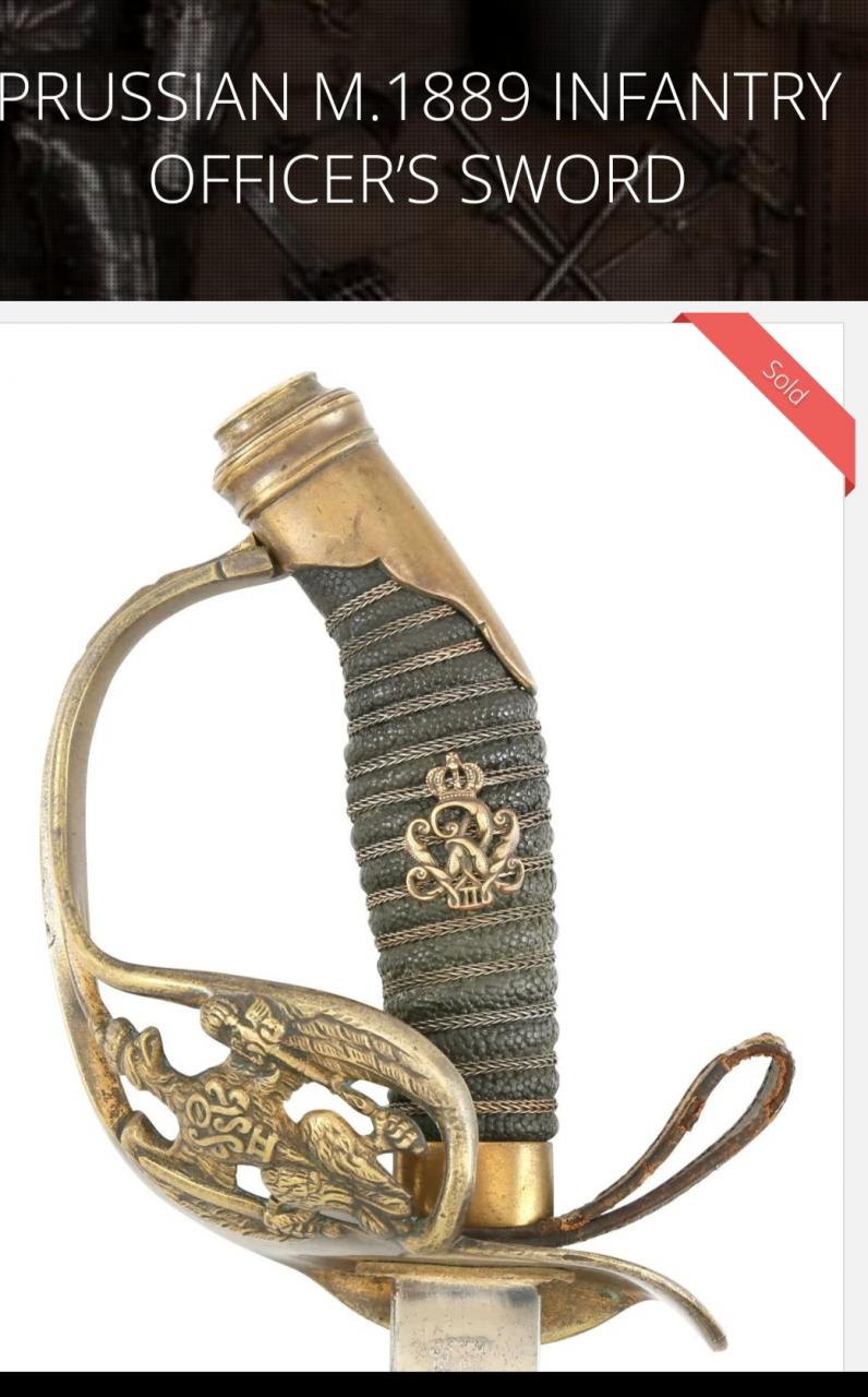

It can be a militar common monogram like the Prussian swords with Wilhelm II empereror monogram on the hilt(1)

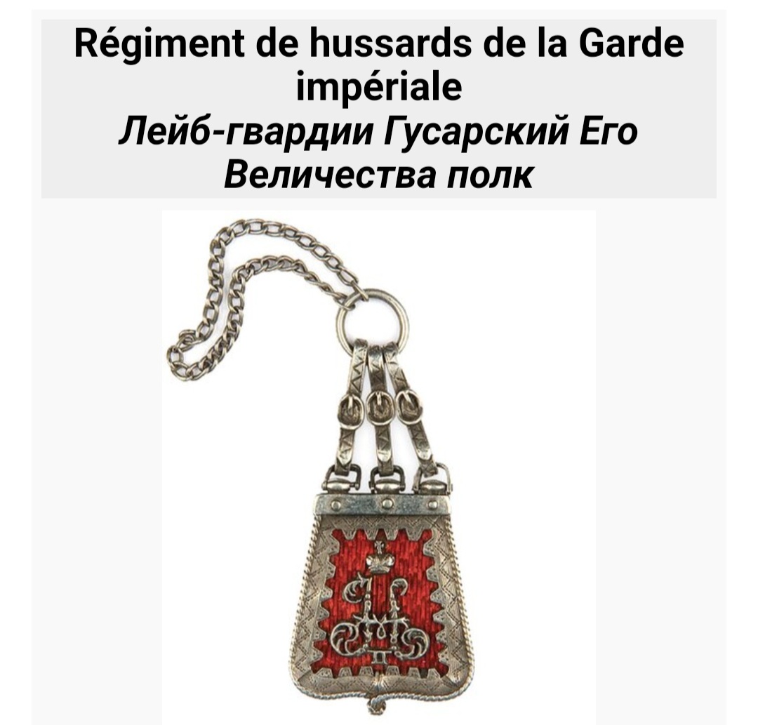

Or rare like the russian hussars impérial guard monogram(2)

Hungary is a good origin for these sword with mixed oriental and european influences.

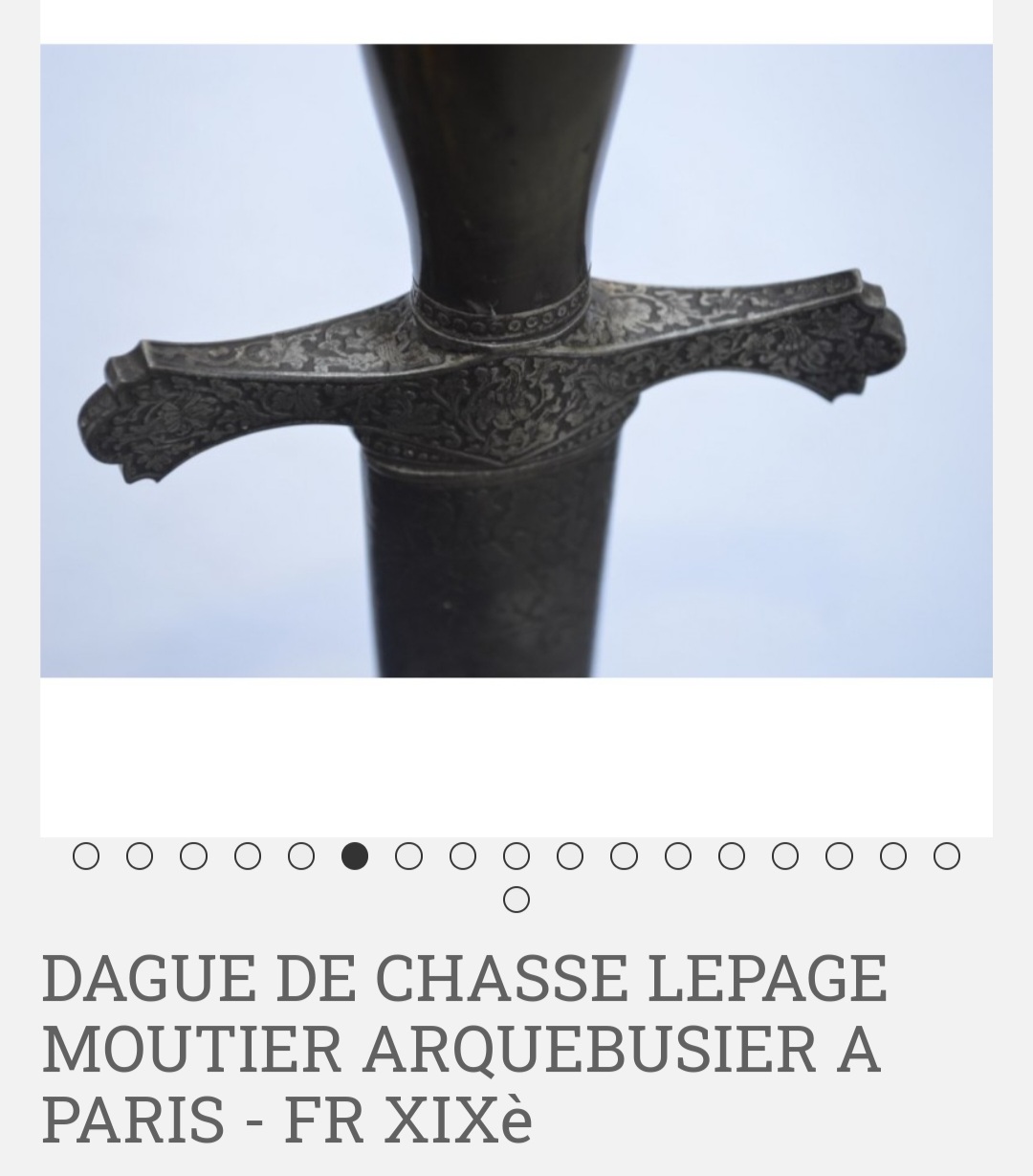

I found 2 steel-iron crossguards with similar shape and foliage in 19th french hunting daggers.
I read they call it ''garde de croisé'' / ''crusader''-''templar' crossguard.
Maybe someone has a sword crossguard like this one ?
Kind regards

It’s typically Hungarian when the crossguard ends are wider than near the grip. Don’t know if it’s related to similar effect on the Slovakian cross (Slovakia was part of the Hungarian kingdom pre-1918). See picture below how a scene at Buda castle might look pre-1914. The Hungarian nobles dressed in national costume and carried sabres. Can’t see what the monogram shows but I assume since the sabre is private it should be the owner’s monogram and he must be a noble because of the crown. I suppose the sabre could also be for a private castle/estate guard since I read somewhere that gilt/brass was reserved for imperial and royal use (regular armed forces).
