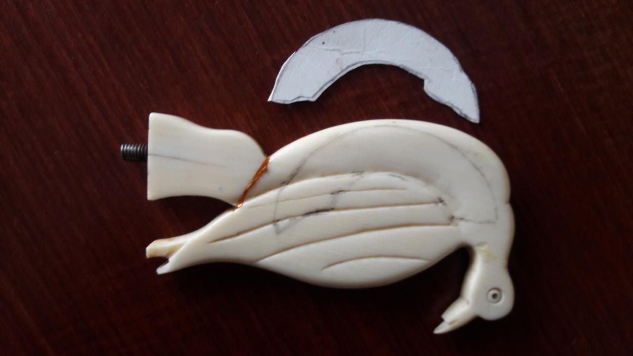

Greetings
I just bought a Sudanese arm dagger in a good condition exept for the handle,
and the arm loop is missing.
Top part is ivory and is missing a piece of the cilindrical part, the ivory piece at the top was broken in two pieces and was poorly glued and i glued the pieces again. Question: leave it as it is or restore it.I don't think the dagger is worth the restauration cost by a proffesional restorer, so probably a diy job. The ivory bird can be used for the missing part.
There is a text on the blade, a translation is always welcome.
Best regards
Marc

If you have the skill, I would definitely say restore the handle, especially since you have some ivory to do it.
Stu

Hi
What's the plan as I cant see how the piece of ivory will be big enough for the job at hand
I found a hand fret saw is very good at cutting ivory with minimal wastage.
Ken

Originally Posted by Kmaddock View Post
Hi
Ken
Hi Ken
I made a mould out of cardboard and am going to cut it out with a scroll saw for model making. the ivory bird is slightly thicker than the part to be repaired.
i will fill the cracks with ivory powder and glue and touch up.
Best regards
Marc

Hi Marc,
I see where you are going with the repair and looks like you have enough material alright.
Will you put a pin in the handle to locate the part in situ while sanding down and give solidity to the join, also how are you going to blend the new "C" shaped part into the existing.
I never like cutting the original part but the shaping of new to old looks very jagged, are you tempted to make the jagged part more uniform by cutting out some of the broken part?
Take pictures as you go along if you have a chance.
Ken
Hi Marc,
Ken
Hi Ken
Good idea to use a pin, i hadn't thought of that because i'm going to use two component glue and it should be strong enough. Will not take anything off the original and try to make the new piece as fit as possible and fill the rest with glue and and ivory dust. Will take pictures during the process.
Best regards
Marc

Hi
I find a pin useful in grafting parts not just for strength but it also center's the part in the same location each time when doing the shaping.
If using epoxy 2 part glue be aware it does go yellow when aged, for this reason I use wood glue for these jobs which sets clear and is easier to incorporate particulate matter to colour the filled in bits.
Wood glue is not as strong as epoxy but hopefully you wont be using the knife for its intended purpose and strength is not the main requirement.
best of luck
Ken

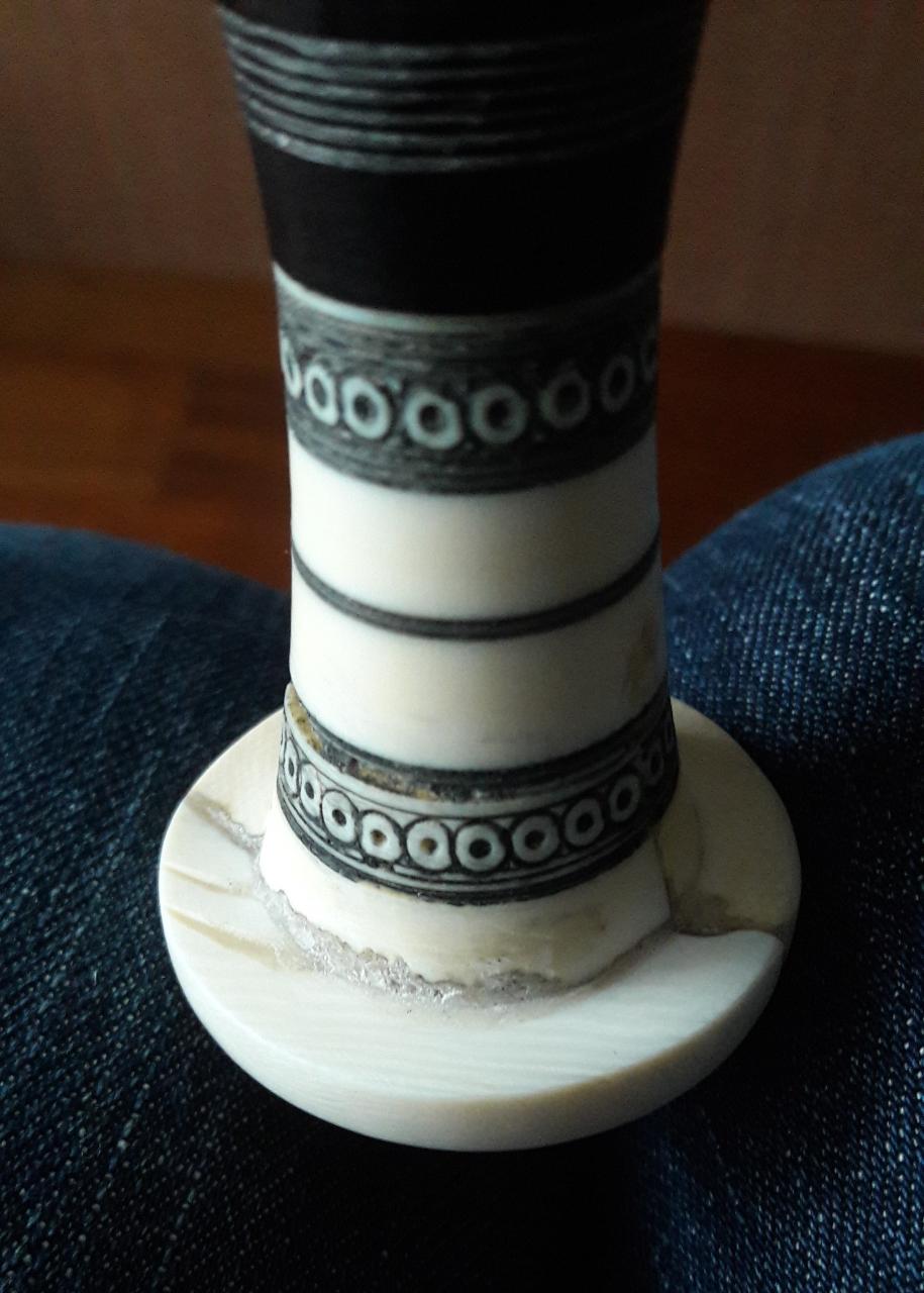

First attempt to restore the handle, result is ok but could be better, the joints are a bit too visible. Didn't have much time and was a bit rushed. Maybe i'll try again.
Best regards
Marc

Nice job. That turned out well. What adhesive did you use?
Marc M. what is the board behind the daggers called? I have seen them used by Samali people as well.
Hi Interested Party
I used industrial super glue.
It is a Quran board that children use to learn to write in the Quran school in Mali.
Best regards
Marc

Nice enough job
But the fact the glue is wrong colour and the join is jagged it is about the best you were going to get away with.
The only way I would have done any better would be to just make the entire ring section/ un peen the tang and insert a new entire ring and bond to the remainder of the handle but this would have been very very invasive and not something I would willingly do.
Ivory would not match either, have you tried to stain the new ivory with something like tea or coffee, I have never done this myself just wondering can you stain ivory.
Ken

Nice enough job
Ken
Hi Ken
It did crossed my mind to make a ring section, but as you said, too drastic.
I hoped that the joints would blend in more, as i filled the joints with ivory powder and glue. Result not so satisfactory. Tried with turmeric powder but wiped it off without results. Maybe i'll try with coffee or with tannin powder.
Best regards
Marc

When it comes to staining the efficacy of common boot polish is often overlooked.
Richard
