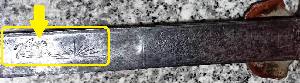

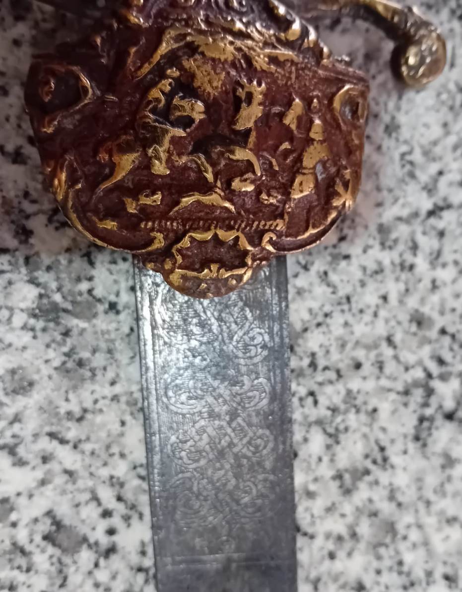

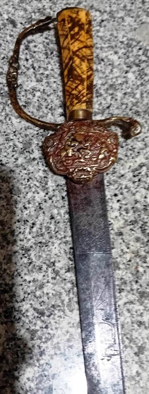

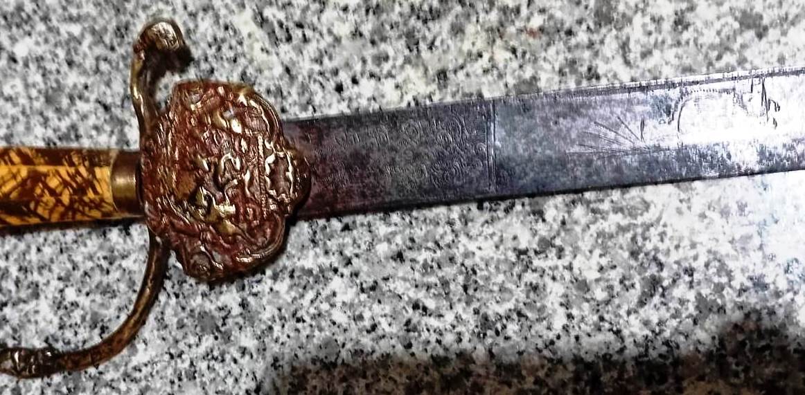

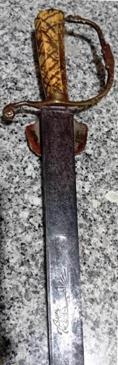

Default Hunting sword - Hirschfanger for comments
A friend acquired this one and would like to know whatever possible about it.
Not much to introduce, except for what it looks like four (?) letters (rara ?) engraved above that creature. Could it be the smith's mark ?
Thank you for your Gentlemen's help.

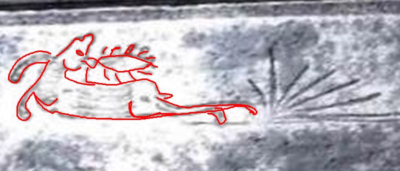

I think it's a deer fleeing in terror after a grenade explodes or something similar

I would say a Hunting sword of the second quarter of the 18th. century ,most probably German.The knuckle bow with a figure in the middle,the upper monster head and the decorated shell guard is typical for this time.The decoation lines in the upper part of the blade and the stylized stag ( antlers over the back) smells like Solingen.I wonder if there isn't the rose on the back of the blade.Also the decor of the grip,remembering of asiatic painting ,was made in Solingen.Certainly the weapon was used mainly for presantation and not for rough hunting.And yes, these kind of weapons are also loved by officers, mainly in the navy.

This is a most attractive example of 'hirschfanger' , hunting hanger and I agree likely in first half 18th c. There can be little doubt the blade is a Solingen product as from the beginning of the 18th c. the swordsmiths there established a virtual monopoly for supply of blades to the cutlers of Europe (Blackmore, "Hunting Weapons", 1971, p.41).
The styling of the hilt is of course basically as found through Germany, and followed basically throughout Europe with the guard shell extending down from hilt to provide palate for the high relief themes often employed on these.
The decorative convention of the grip material does resemble 'chinoserie', the European favor for Oriental styling in the 18th c.
The blade decoration follows the often elaborate themes including both mystical and religious elements reflecting the profoundly serious and celebrated art of 'the hunt' which was elaborately followed by the gentry and nobility. While often there were mystical devices and symbolism as well as accompanying interlaced strapwork designs (following talismanic forms of Eastern Europe), sprays of foliage and sometimes martial trophies also were used.
In this case, I am wondering if the dynamic image of the stag falling might be hubris oriented? that is, the rays might suggest, rather than explosion, the 'point of hit'.....?
in other words, suggesting a stag hit by shot while 'on the run', more notable feat of a skilled hunter.
These hangers were actually also very much 'court swords', which is why they are typically included in reference material on these. While elaborately decorated, it seems that often this did not preclude their wear on the hunt for fear of damage from hard use. I had always thought that the task of field dressing was to the accompanying 'employees' of the noble figures, and that the actual 'kill' was seldom using these hangers.

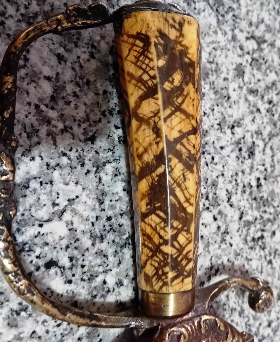

Is the handle of this hanger porcelain? I had thought tortoise shell at a glance....
My friend thinks it has to do with some horn material; maybe deer antler !

From Bruno Thomas & Ortwin Gamber, "Jahrbuch des Kunsthitorischen Museums in Wien 1937 to 1955". as cited in
"imperial Austria: Treasures of Art, Arms and Armor from the State of Styria"
Musueum of Fine Arts, Houston, 1992:
"...they convincingly explained that rather than being mere accessories, weapons are themselves artistic creations that reflect larger stylistic tendancies of a period".
The nobility and gentry of Europe, much as characteristic of most civilized societies, were well aware of fashion, style and curiosities, and the 'hunt' was more of a 'field exercise' of court assembly and event.
There was of course notable competition among these figures who eagerly sought to impress others and themselves with unique, sometimes dramatic, elements reflecting these, of course on their weapons.
Blackmore (op. cit. 1971, p.36-38) notes, '...towards the end of the 17th c. TORTOISE SHELL obtained from the hawkesbill turtle native to Asian tropical waters began to be imported into Europe. The chief advantage of this malleable material was the ease with which it could be shaped, molded, impressed or inlaid with decoration".
However it goes on to describe just how rarely this material was used on weapons, but usually more common on accessories such as snuff boxes and sundry items. .......BUT, there were a few weapons in which it was used.
Porcelain seems to have produced primarily in the Chantilly and St. Cloud factories in France.
The influences of the Orient were as noted, gaining popularity in Europe with the Dutch East India Co. being a primary source. The gold and silver alloy called 'shakudo' while being a Japanese product was originally thought to be associated with the style termed 'Tonquinese' . Tonquin , Annam was a province in now Viet Nam under Chinese control and later French colonial.
The shakudo was apparently produced for the VOC at their factory in Deshima Japan, an island off the mainland.
European hilt makers seem to have actually brought in Chinese artisans for produce hilts and mounts for many of the eagerly desired 'exotic' weapons in the 18th c.
While obviously a Chinese Qing era saber, this example of much earlier blade remounted, probably diplomatically or presentation oriented, using tortoise shell material, probably first half 19th c.

Well, antler is bone - not any horn material...
This criss-cross pattern is not tortoise shell IMHO. To me, this looks like a paint job (there was a special technique being utilized - its name eludes me right now): The fading of the dark pattern along the facet ridges is the major hint (worn through).
Close-ups (in focus) would be good!
kai is offline

... Well, antler is bone - not any horn material...
So sorry for the idiomatic expression ?
" Antler = each of the branched 'horns' on the head of an adult deer (typically a male one), which are made of bone and are grown and cast annually "
... The criss-cross pattern is not tortoise shell IMHO...
Visibly not !
... To me, this looks like a paint job (there was a special technique being utilized - its name eludes me right now): The fading of the dark pattern along the facet ridges is the major hint (worn through)...
Maybe done with some kind of acid (?) that keeps it resitant to wearing for a long period ...
Close-ups (in focus) would be good!..
I will ask for those; but this person only depends on his cell phone camera !
fernando is offline

I can see it being a stag handle with these pictures. The shell guard of horsemen and dogs is an interesting and appropriate motif. This guard was cast? A knotwork of protection spells engraved on the blade. Thank you for the pictures.

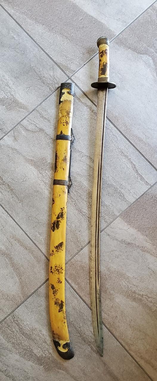

The reason I added the image of the tortoise shell material of a Chinese sword in the unnoticed post I placed previously was to illustrate the effect of yellow color highlighted with brown patches. Somehow it just seemed in line with the yellowish toned material here which is staghorn or buckhorn most likely (not sure of the proper zoological term) which has indeed been painted or highlighted ...
Could it be that the idea was to imitate the tortoise shell effect seen on some Chinese arms?
The elements of rococo decoration in the 18th century often included those of 'chinoiserie' (in the Chinese manner) and it seems faux material decoration was popular through the 18th c. While usually applied to steel or iron, the browning or russeting seems at hand in this example.
In Europe, 'orientalism' was in the height of fashion and popularity, and the curious talismanic charms and mysticism became well represented in the intaglios of themes on blades. The trellis type cross hatching and entwined vegetal decoration IMO has to do with that of talismanic devices and sigils with origins in Eastern Europe which came into France and Germany.
While it would seem strange that protective amulets etc. would be needed in the hunt, there was a good deal of danger from wounded and enraged animals as well as many other potential accidents. The invoking for success in the hunt was also a factor.
I agree this is likely from German states in mid 18th c.
