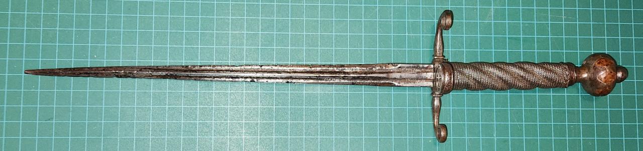

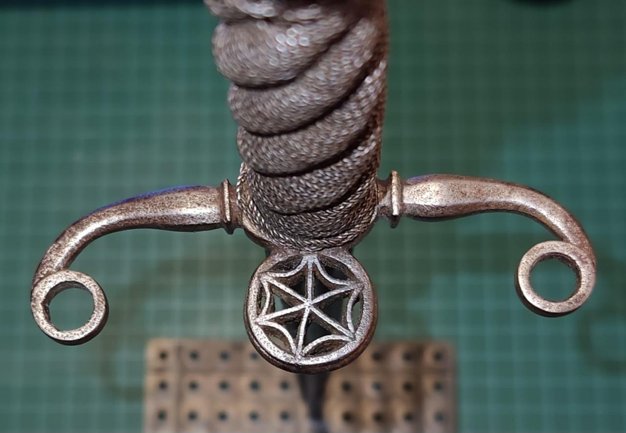

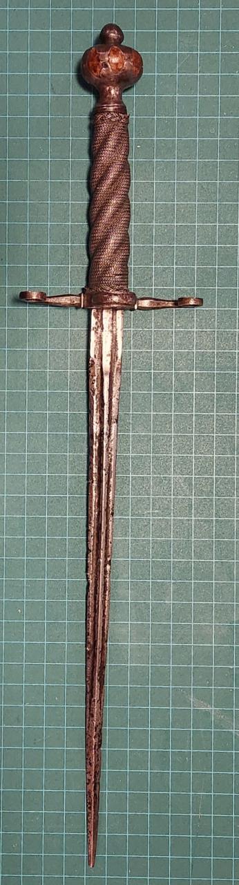

Holiday greetings to all! I picked this interesting old dagger in a trade to day and it's well beyond my collecting field. I found what I think is similar examples in Stone's A Glossary... but I'm just guessing and trying to match my trade to very old drawings. May I ask the Forum what their thoughts are?
Sincerely,
Greg

Thanks Fernando, does this speak to any particular country? Age wise, 1550?
Greg
sabertasche is offline   Reply With Quote
Old 17th December 2023, 04:50 PM   #4
Let the more knowledged members give you an adequate answer, Greg. Italian, maybe ... i don't know .

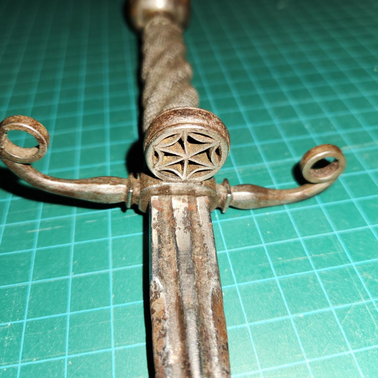

The 'main gauche' thing is IMO a bit overplayed usually, these pretty much fell out if use, at least in the fencing aspect by the end of the 17th c. but daggers, presumably of this basic form did remain worn as secondary weapon. While fencing was typically not necessarily a duel to death, in many situations involving sword to sword combat such as brawls or melee in civilian setting (i.e. Italy as in Shakespearean dramas) the dagger became key when close quarters tussle rendered further use of sword/rapier impossible.
Though this example seems to have the presumed look of a misercorde, that particular weapon had not been in use for some time, these were of course allegedly for 'coup de grace' to mortally wounded knight. While this rather dramatic notion was popularized in the annals of chivalry, these were more for the same close quarters combat as they were intended to penetrate any open area in armor whether gaps or damage.
That the classic design might well have been carried into the theme of this interesting example seems likely, and the intriguing six point star in cartouche seems to have a symbolic character as in architectural motif, more research would be most interesting. The blade seems aligned with daggers of late 16th to 17th c. but I would defer more on that to experts.

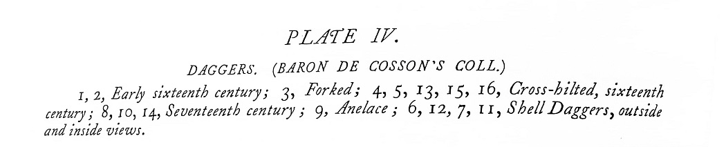

Egerton Castle, "Schools and Masters of Fence" (1885) examples 8,10,14 , plate IV, shows three examples of this basic form as cross hilted daggers of Baron de Cosson, coll. 16th c. Italian seems likely, but of course hard to say as Italian influences strongly diffused into other arms centers.

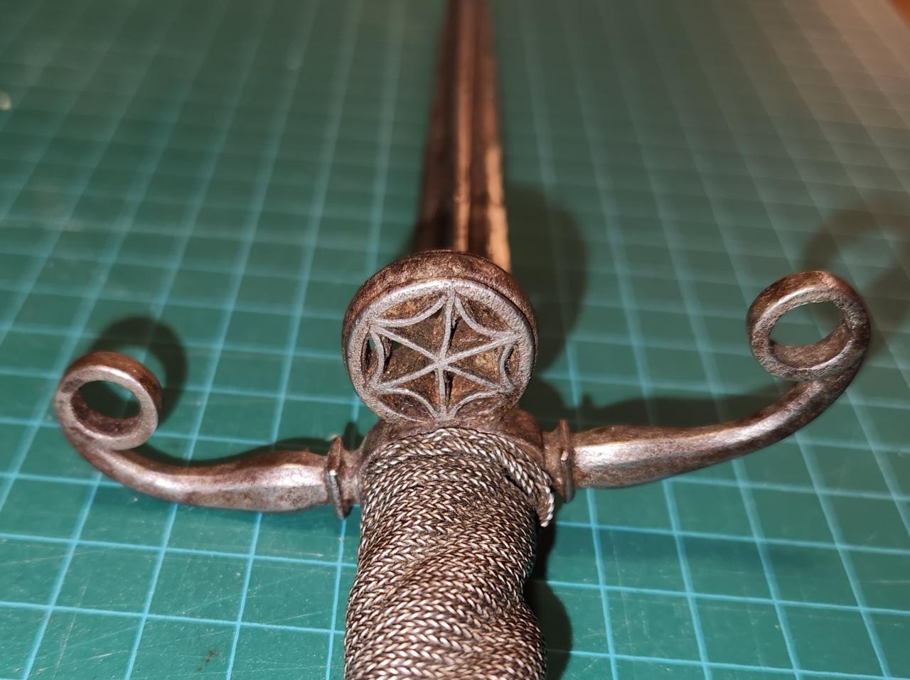

As the readership on this thread is resounding it seems, nearing 2000 views in 4 days! I thought I could at least try to stay active, so hit the books! to find more on the interesting device in the raised guard ring.
This appears to be a 'chrismon' monogram of Christ, which resembles an ancient pagan sun wheel. ..however is transposed letter I over a Greek X.
This rather explains the 'ecclesiastical' feel to the device, noting how many hilt themes and elements included religiously oriented basis.

In my worthless opinion, i would not discard that this is potentially a left hand (main gauche) dagger, notwithstanding that its guard features have a somehow unusual design, both the (one only) direction curved quillons and specially the guard device, being not a ring but a solid disc. Judging by the fact that there aren't many like these out there, we may presume this was the whim of some wealthy client.
OTOH, whatever the signification of this finger guard design may be, i suspect such is not yet deciphered.
But then and again, my assumption is to be taken with lots of salt.

... Castle (1885) did in fact note that while these 'left hand daggers' had fallen largely 'out of use' in that capacity by end of 17th c...............
Do you have any reasoning which opposes that this dagger falls within such period, Jim ? Actually, well within... i would bet .

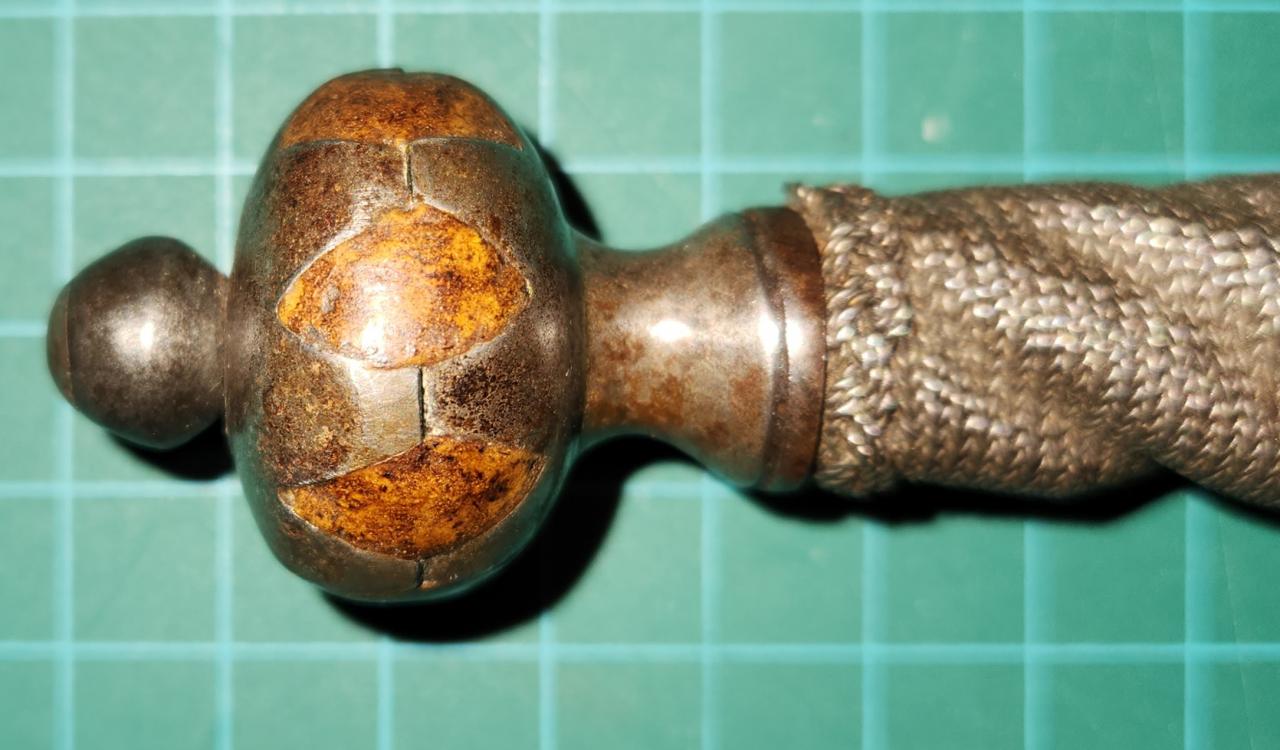

And by the way, this pommel is also an intriguing work of art. I wonder what is that yellowish (?) material showing off between the steel spaces. Maybe Greg could tell us ?

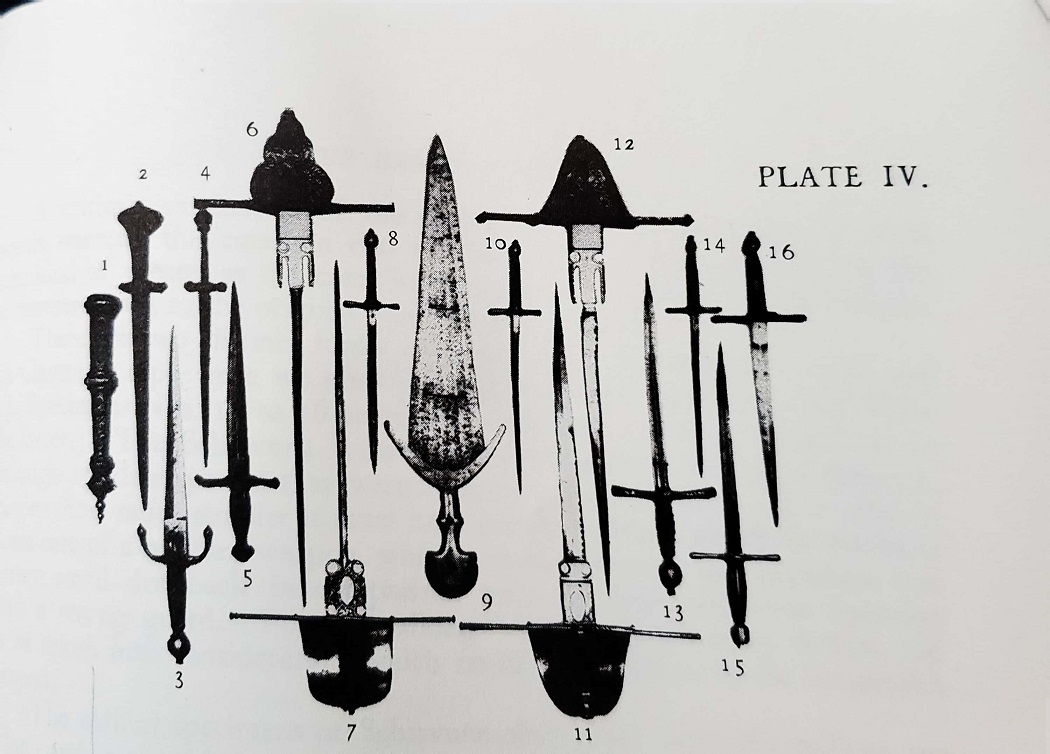

Actually, as far as reasoning, no........I am relying more on the material providing expert opinion/reasoning, of the author Egerton Castle (1885), in PLATE IV......note item #4 shown as 16th c......while 8 and 10 are remarkably similar shown as 17th.
While this plate simply refers to these items as 'daggers' (not otherwise specified) the examples I cited show the propensity for early forms remaining popular in later times (early 16th example to 17th c.).
I have added a page of text that has pertinent data as well.

As far as the yellow, I think maybe just lighting in the photo? rather than actual coloration.

One other thing is how Mr. Castle names figures 6 to 12 as 'shell' daggers, which i find hard to assimilate. In fact these are consensually called 'sail' (guard) daggers, or 'dagas de vela'. Shell daggers are a different thing. His connotation of these being (occasionally ?) sword breakers (as per your 1 - stressed paragraph), perhaps deserves a 'separation of the waters'. They were no doubt left hand weapons.The fact that some had breaking sword implements in them is only an occasional fantasy, notwithstanding the basic purpose of these daggers.

Actually, I had no idea of the term either until I looked it up online yesterday, and truthfully saw a cinquedea oddly in this plate from Castle, wondering WHY it was with left hand daggers! Books are a wonderful thing, however, they have severe limitations, and have always been hard to come by. Most of these I have cited were rare books even in my early days of collecting and I could only access them via interlibrary loan and photocopy pages.
Thankfully we now have the web, and many new references, with these classics now reprinted and readily available. This is good..........as the 'bookmobile' does not have room for a library of notable presence
As you note on the 'cinquedea', that is the PROPER term for these Italian large daggers, which were worn actually in the small of the back. My note to the use of 'anelace' as the term for what we know is 'cinquedea' was to show how the antiquarians of this 19th c. period used terms rather 'unusually', and how Demmin, one of their contemporaries was the source they followed.
Your notes on the 'sail' daggers are well placed and as always fascinating.
One of the most intriguing things for me over the years studying here are the remarkable notes and colorful terminology you have always shared which illustrate the Portuguese and Spanish perspectives on these arms. These I have copied into notes that augment these references I have otherwise, as it is material entirely valuable and NOT found in any books I have.
The highlights on the page shown were not intended for anything in this discussion, but were result of research years ago on these, and were as noted with regard to the often fanciful notions of many of these unusual features.

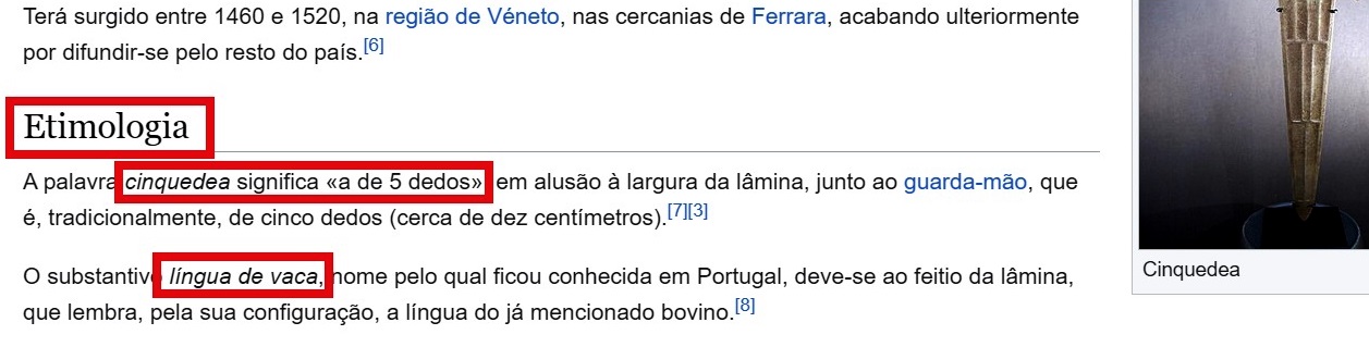

Wait until i tell you the name given to the cinquedeia by the Portuguese; LINGUA DE VACA = COW TONGUE. Easy to know why, when you think of the blade shape .
