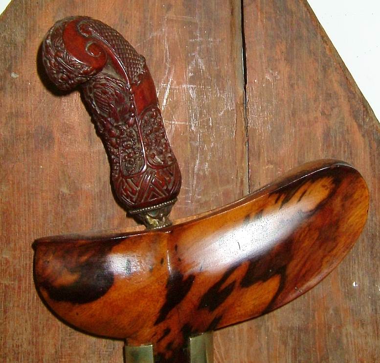

Often I see a feature on some keris which has puzzled me for some time now .
Why are certain gonjos lifted away from the wilah at the tail or greneng end ?
This feature must have some meaning or be of a certain style ; can anyone help with the how and why of this ?

Hi Henk ,
That's something to consider ; but also when you look at the ricikan (correct term?) of both kerises they are similar even though one is Javanese or Maduran and the other seems Sumatran (cross pollination?).
About the lack of pamor on the Jawa piece; it is a very old blade and if I recall correctly from a past discussion of this one possibly from the Sultan Agung period; also again if I recall correctly there was some mention of a prohibition during that time of pamored gonjos or of openly displaying the pamor of one's keris .
Could this be a feature of dapur; or does dapur not cover the area of the gonjo ?

Hi David , I believe it's a Maduran ukiran; sorry I didnt show it in its entirety.
I'm just not sure if this is the result of warangan; the Sumatran keris does not look heavily eroded enough for this to have ocurred .

There are perhaps as many answers to this question as there are keris which display this feature.
In the two keris that Rick has shown, I would suggest that perhaps we are looking at two different cases with different causes.
In the first there is absolutely no doubt whatsoever in my mind that we are looking at the effects of time.
Plain, simple erosion.
In the second, what I can see is a pretty substantial gonjo that does not display an unusual amount of erosion, moreover it is a fairly recent keris.
Possibly this gonjo was not very carefully fitted in the first place.
It does take a lot of time and effort to achieve a tight, neat fit of gonjo to blade, and if a keris being made to a price, the maker is not going to waste time on something that will not recompense him at an adequate rate for time spent.
This gonjo has probably been fitted by the gonjo around the pesi being punched . I feel that a key in keyway fitting would not have been used, and even if it were, I believe there would be evidence of the gonjo hole being tightened by punching. When the gonjo was punched down, any imperfect fitting would show up by the gonjo lifting away from the blade. Another possibility would be that the tip of the gonjo has been subjected to force.
If this second keris belonged to me, and this opening bothered me, I would apply gentle heat to the gonjo with a propane torch, and tap it down to fit.

I cannot see any real problem in the photo.
Yes, there is a gap between the blade body & the gonjo, this is not at all unusual in older keris, and even in recent keris which have not been carefully made.
By dismounting the gonjo & refitting it this gap can very probably be reduced, but this is not a job that should be undertaken by somebody who does not possess the necessary skills.
In Indonesia, the modern approach is simply to fill the gap with two part epoxy + black artists powder + iron filings. This is not an approach that I approve of or recommend.
