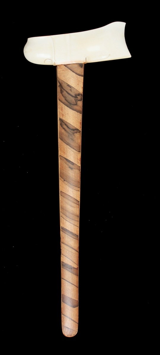

Hello Sidj,
Please show us detailed pictures of the top part of the warangka (front, rear, and top sides, taken at a right angle) for better identification of the materials.

I am not yet in possession of the keris. It has been described by the auction house as ivory. I know that mistakes can be made though. I will post images when I have it in hand. Apart from the dark patch, ivory seems plausible to me. Of course, it could also be some type of bone. I will be able to tell once I get it.
SidJ is offline   Reply With Quote
Old 25th May 2022, 08:23 PM   #13
Jean
Join Date: Jun 2009
Posts: 1,740
Thank you and yes, ivory materials is very possible but the small pits on the reverse side may indicate bone. By the way the hilt is placed in the reverse position.

What if any are the implications of the atasan being ivory vs it being bone? Can we draw any inferences if it is one or the other? I presume bone is less prestigious than ivory but could this also enable a reassessment of the date of manufacture from the 1970s to earlier in time? Thanks in advance.
Old 27th May 2022, 05:34 PM   #15
Jean
Join Date: Jun 2009
Posts: 1,740
Yes, an ivory atasan is much more prestigious and expensive than a bone one.
Bone would often decay quickly (more or less depending on the type of bone and the selected piece) so it generally looks older than an ivory one of the same age, except if the ivory piece has not been properly selected .
See specimens of an ivory atasan (left), and a whale bone one.

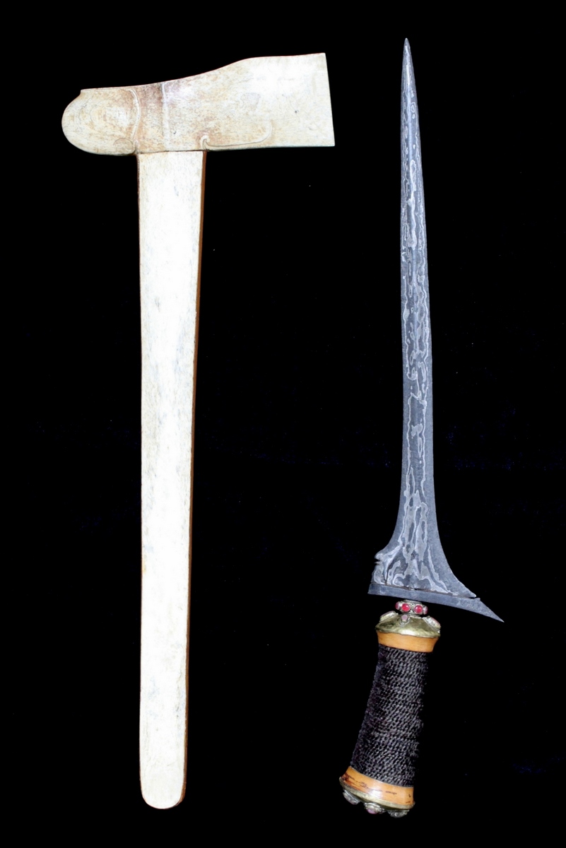

I have now received the keris and having checked it carefully I can confirm the Atasan is made of ivory and not bone. I am unsure if this necessitates any reappraisal of the age of the dress or not.

Personally i never thought it was bone, but i could not see any evidence of Elephant ivory (Schreger lines). Now that you have it in hand can you tell what type of ivory it might be? I'm not sure how much adjustment there would be to the age of the dress. It does seem newer than the blade and 20th century. Likely post-WWII, but it is still hard to tell from the seller's photos. The atasan does seem a little stiff in it's form which might point more to a later date than earlier. But these photos are all from odd angles. Maybe you could post some new images now that it is in your possession.

Pics of the keris
Old 31st May 2022, 05:36 PM   #19
SidJ
Join Date: Apr 2020
Posts: 244
Hi David,
I can see Schreger lines and therefore conclude it is elephant ivory

pic
Old 31st May 2022, 06:54 PM   #21
Posts: 7,297
Originally Posted by SidJ View Post
Hi David,
Thanks Sid. I saw these pics on the FB thread. I could see the Schreger lines there. Clearly elephant ivory. You might need a larger imager to convince the doubters here though.

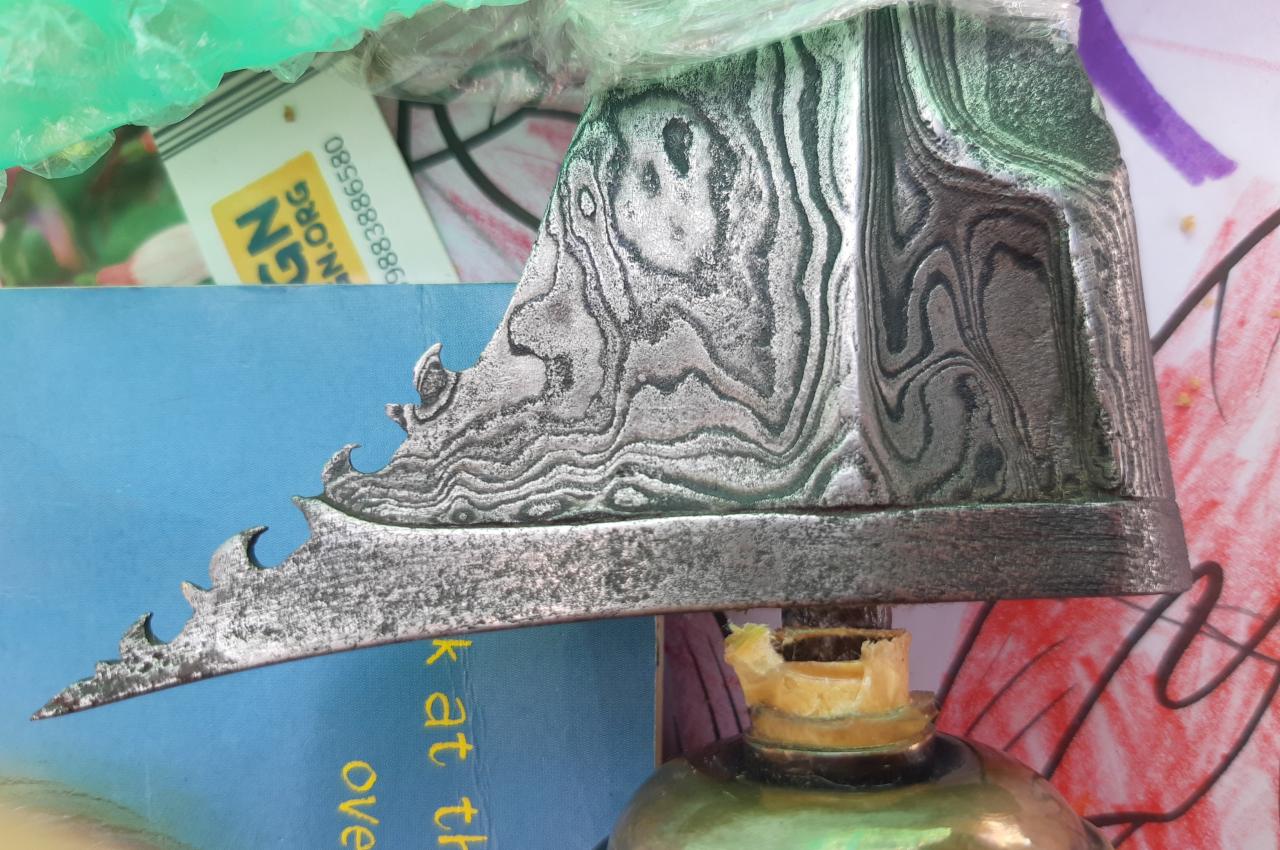

Interesting to see a Bali style Keris with defined Blumbangan but without Kruwingan and Tikel Alis. An unusually plain appearance.
SidJ, is there a possibiity to post a good picture of the base of blade with Gandhik on the left? Thank you very much!

Posts: 244
Gustav see pic
Old 10th July 2022, 05:28 PM   #30
Gustav
Join Date: Jun 2009
Posts: 1,346
Thank you!
