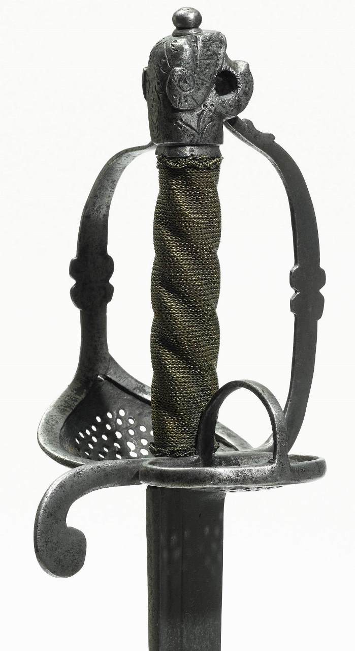

Hi Guys
I am particularly looking for research information on a specific form of early Military sabre that features a dog or lion head pommel. I think they are usually described as Swiss or German Circa 1640. I have attached a picture of a sword from this family that I am referring to. Any assistance with reference material will be greatly appreciated.

Wouldn't that be a Swiss bear vs dog?

HERMANN HISTORICA
'An Swiss officer's sabre, 2nd half of the 17th century Curved blade with a double-edged point and narrow fullers on both sides. Iron bar hilt with thumb ring, the obverse side with inset, elaborately chiselled brass guard plate showing a monster's head. Grip with elaborate brass wire winding and braided ferrules. Pommel in shape of a dog's head with punched and engraved decoration. Small piece at the right side of the snout missing. Pommel with remnants of fire-gilding. Length 91, 5 cm., historic, historical, 17th century, sword, swords, weapons, arms, weapon, arm, fighting device, military, militaria, object, objects, stills, clipping, clippings, cut out, cut-out, cut-outs, melee weapon, melee weapons, metal'
Swiss favored bears. The dog pommel hangers of England are somewhat different.
An couple of older auctions listing them as lions. Still, Swiss liked bears.
https://www.auction.fr/_en/lot/a-lio...swiss-10027809
https://www.ratisbons.com/auctions-a...h-century.html

thanks for that, I thought they were pretty ordinary looking lions, if they are meant to be bears that makes more sense.
