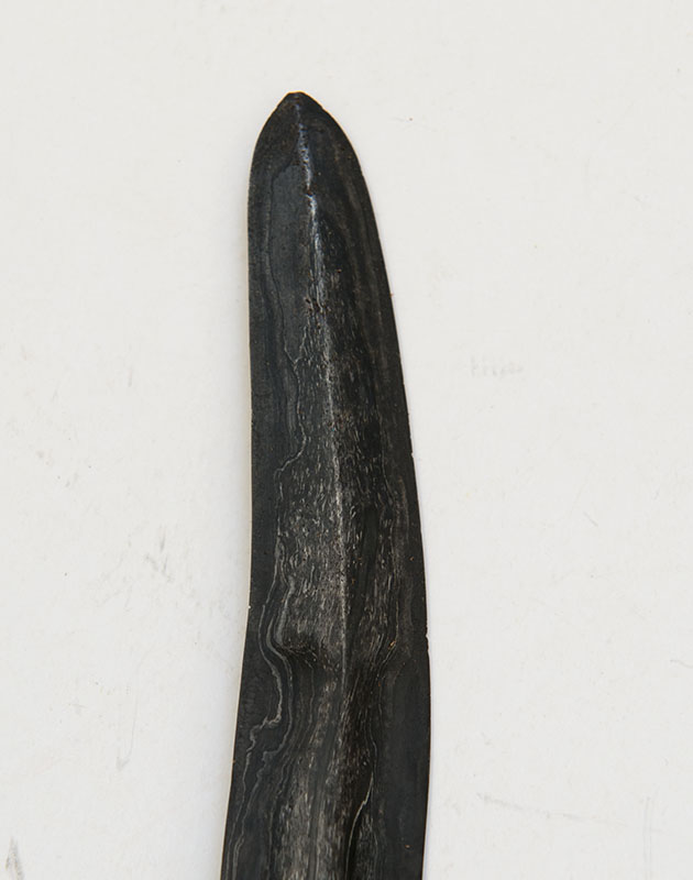

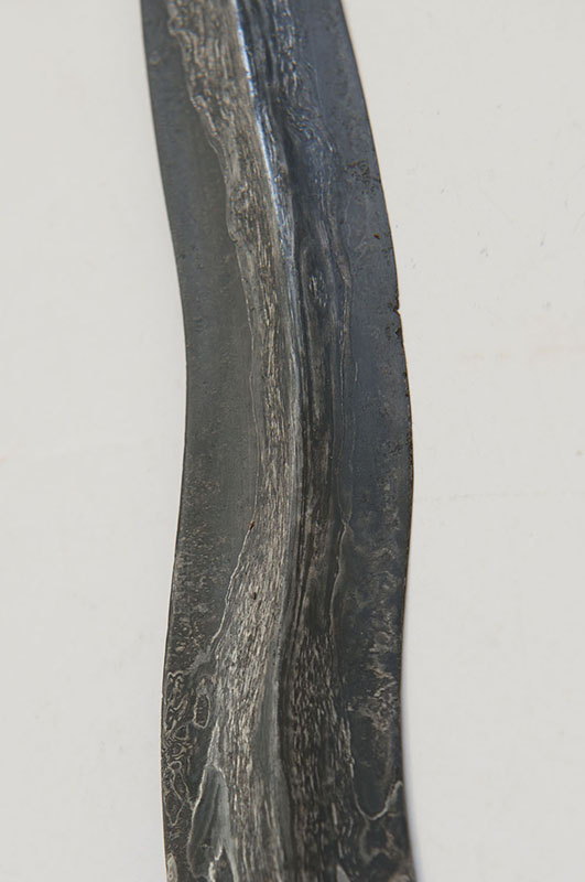

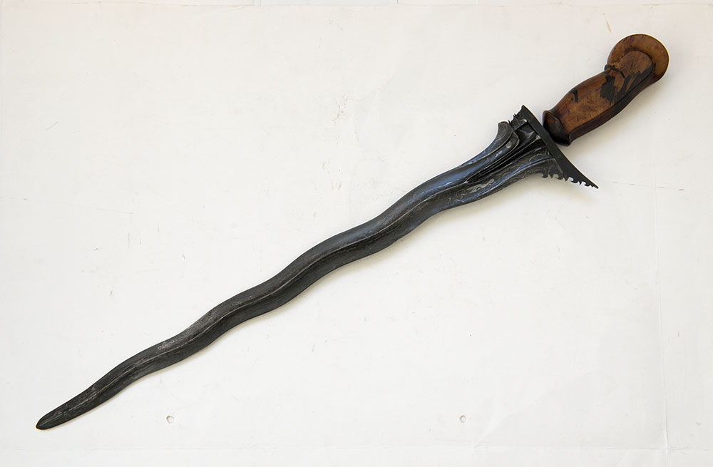

The Pamor on this Balinese Keris looks like it was made of some kind of crucible steel, although a metallurgical analysis is needed to be sure...

This seems unlikely to me Tatyana. Pamor is generally not steel. The word literally means "mixture" and it is generally a mix of various iron ores with varying ferric and/or nickelous content.
