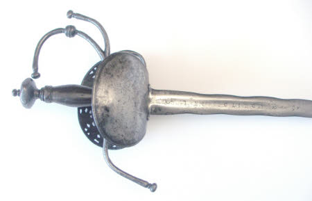

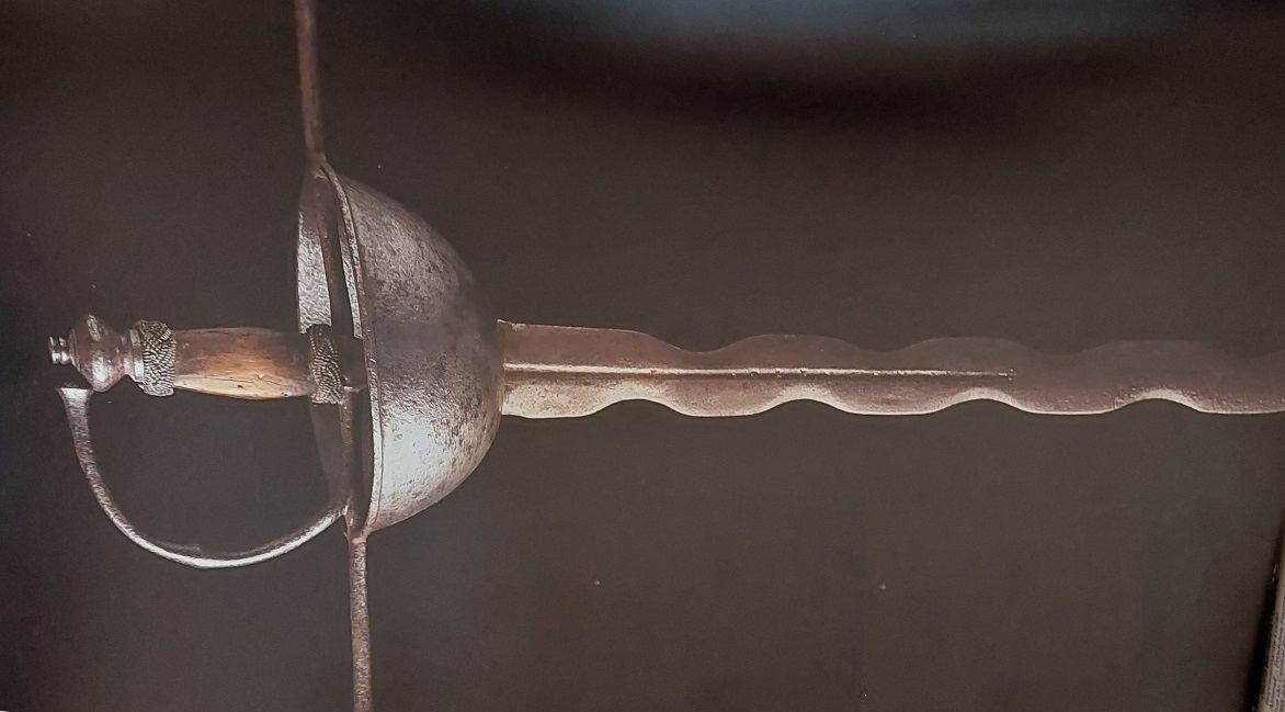

Default A RECENTLY ACQUIRED CUP HILT SWORD FOR COMMENTS

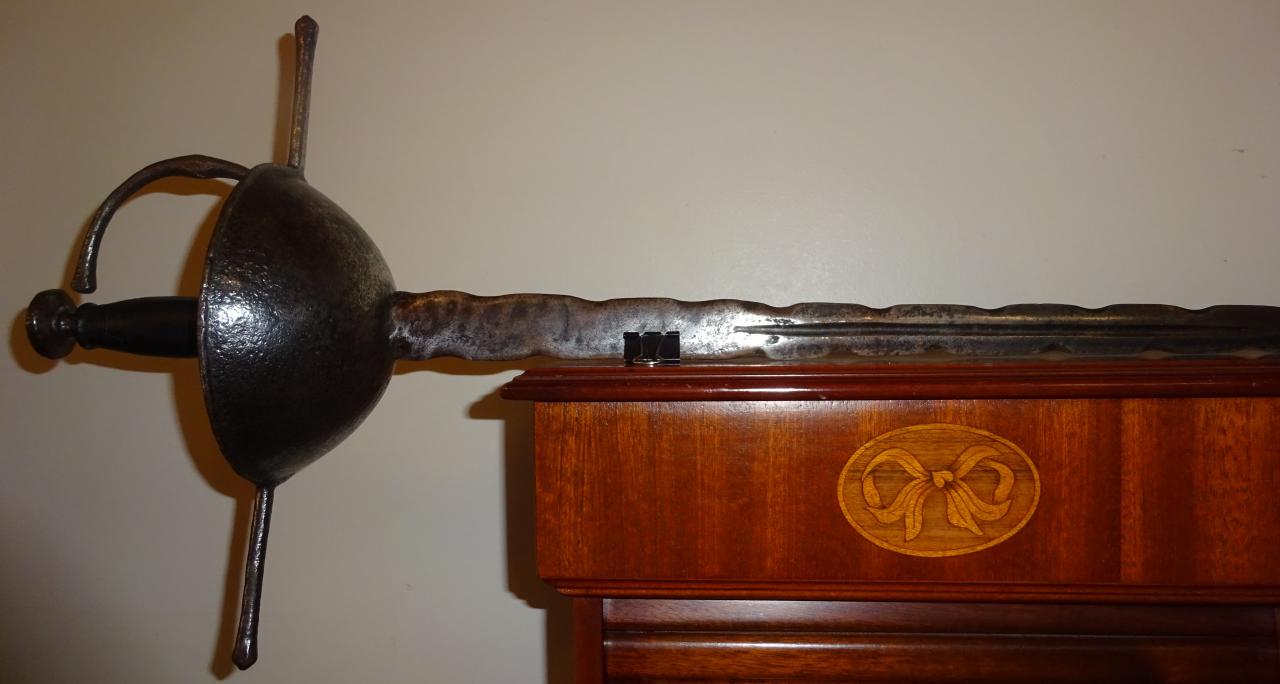

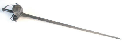

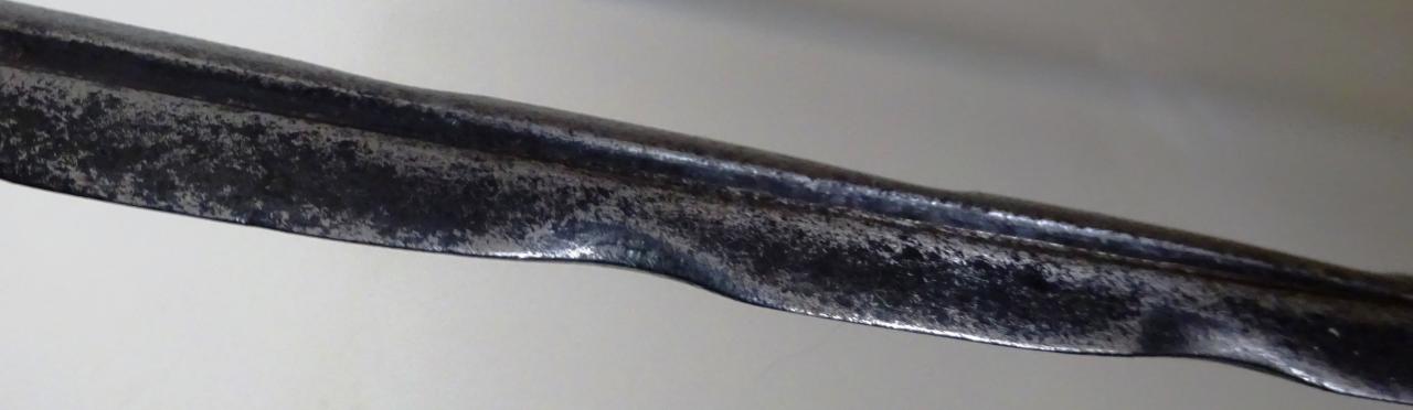

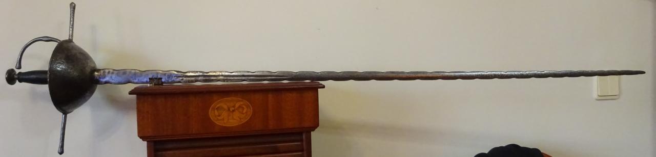

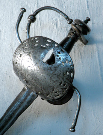

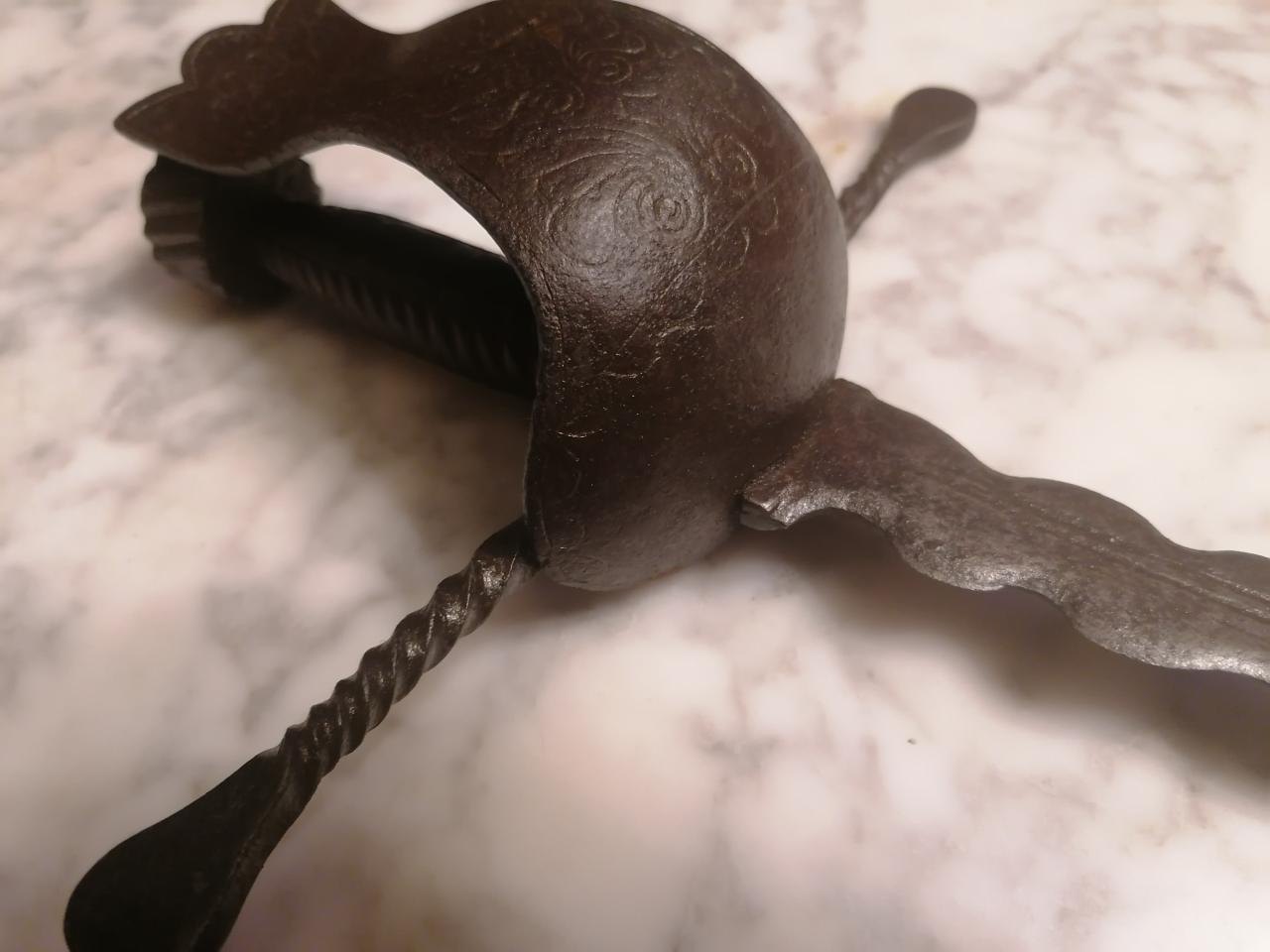

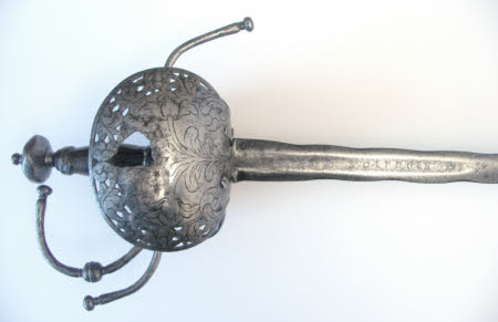

Judging by its characteristics, namely the pommel, i would date this 'rapier' between mid-end 17th century ... subject to your Gentlemen corrections.
This is indeed a rather long sword, by far longer than all others of mine, measuring in total 127 cms. (50"). The undulating blade, with a short fuller starting 16 cms. from the base and extending for 22 cms. Width at forte 32 m/ms., proportionaly tapering all the way to a fine point.

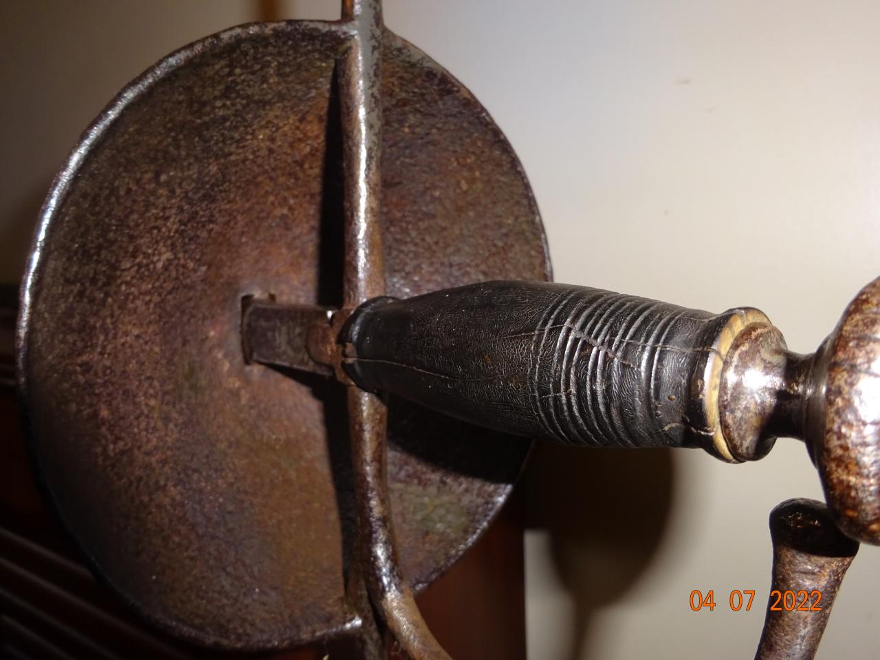

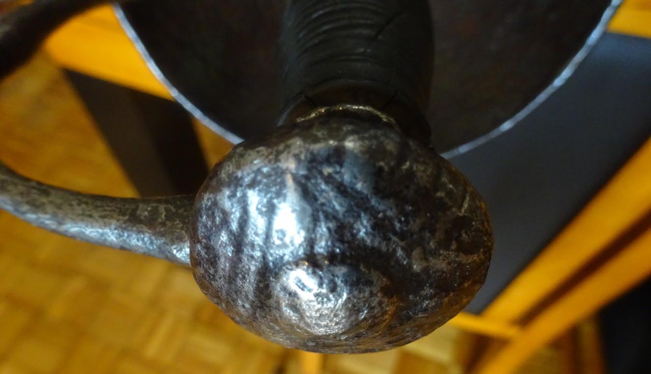

The grip in dark wood, with some turning lines.The pommel with traces of decorative engravings, almost gone with time. Peening looks untouched.
Anyone care to comment on this piece ? I would be glad..

That had to an awkward one to carry for a man of average height for the time (67", 2.04m). Do you think the serpentine shape was original to the blade? Is that flattened pear pommel a typical characteristic for Spanish rapiers?

This example could well be Portuguese, not Spanish; firstly because it was acquired in Portugal and secondly due to the system to secure hilt/quillons by welding them to the cup bowl, as (more) favoured by the Portuguese, and not with a pair of arch wings screwed inside the cup bowl bottom.
The fact that long rapiers were not practical to carry around didn't prevent those more prone to engage in (street) duels to commission the so called off mark (ilegal) swords. I am looking at a (Portuguese) book where i see off mark rapiers reaching 1.465 m, called in the period 'seven span' swords. We are also aware that rapiers were not carried verticaly but almost horizontaly, by means of a proper 'frog' and the laying of the owner's hand pressuring down the hilt. Ultimately the welthy nobles would have it carried the attendant page .
As the author of this book says; not discreet to carry in the waist, nor so easy to unsheath, not to mention the difficulty to handle such long swords in a fight, but they at the distance the most brave adversary.
Yes, pommels of this type are seen, a luxury detail to distinguish them from more humble ones.
And yes, undulated blades, whether made by means of hand filing or forged by the smith, are both original. Noting again the book i have been mentioning; i can see three examples with a undulated blade in it.

I had always assumed the undulations worked like a steak knife for push and draw cuts, as well as discouraging grabbing the blade to control it. I'm sure there were some students of Fabris still floating around I have always wondered how useful their left arms were after surviving a few fights deflecting blades with the left hand.

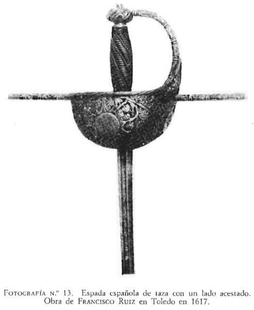

You may go further back a little, Jim . The earliest cuphilt detected with its date inscribed on the blade, is a splendid example signed by HORTUÑO DE AGUIRRE (Toledo) in 1604. It is kept in the Armería Real de Madrid and was property of King Felipe III.

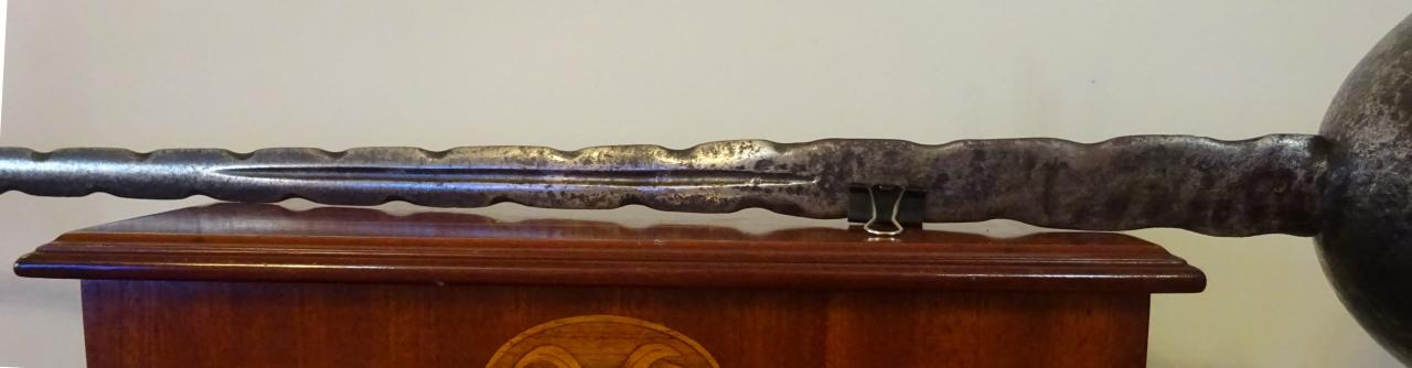

The author of (again) the mentiond book considers it has a multiple cutting area, as it would happen with electric knives; a little back and forth move would inflict a quick and deep cut. I don't know if i get his idea !

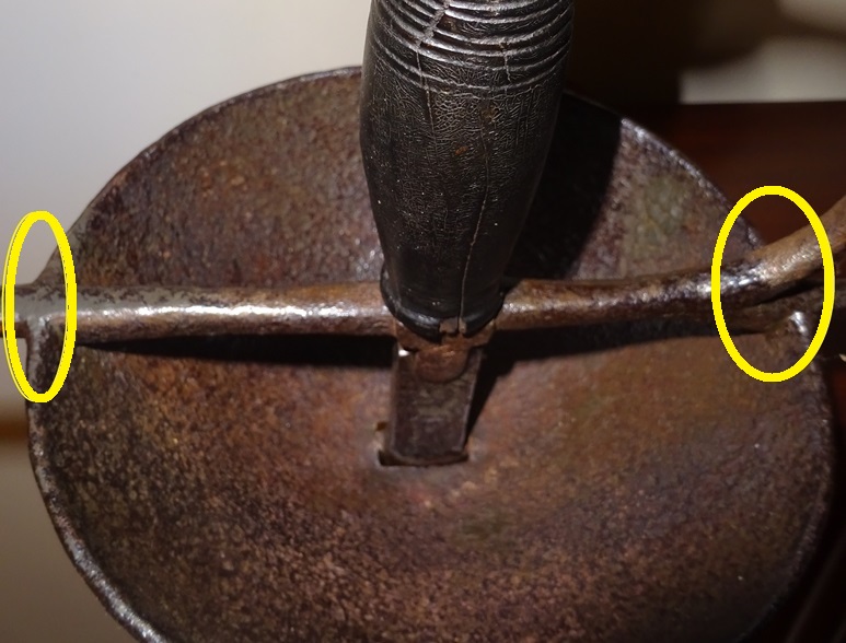

In XVIIth century Spanish language, the half rings of the pas d'ane are called "orejas" (ears).
So I like to classify cup hilts as full ears, half ears and no ears. I believe than rather than to nationality, this is a question of evolution in time and purchasing power.
So closer to 1650, we have mostly full ears, closer to 1680, we have many half ears. And closer to 1700 and beyond we get often no ears.
No ears are cheaper because they do not have to add workmanship to screws, or ricasso plates. They can be sturdier and therefore rather military than civilian. the main disadvantage is that the blade has to fit better. And usually the same types of blades are found with these hilts. There is not the variation that is found with full ears or half ears. For example, as a military weapon, fewer no ears have a thin rapier blade. One of the types usually found is a flambergue. About how this blade works, IIRC Richard Burton has a chapter on it in his book on Swords.

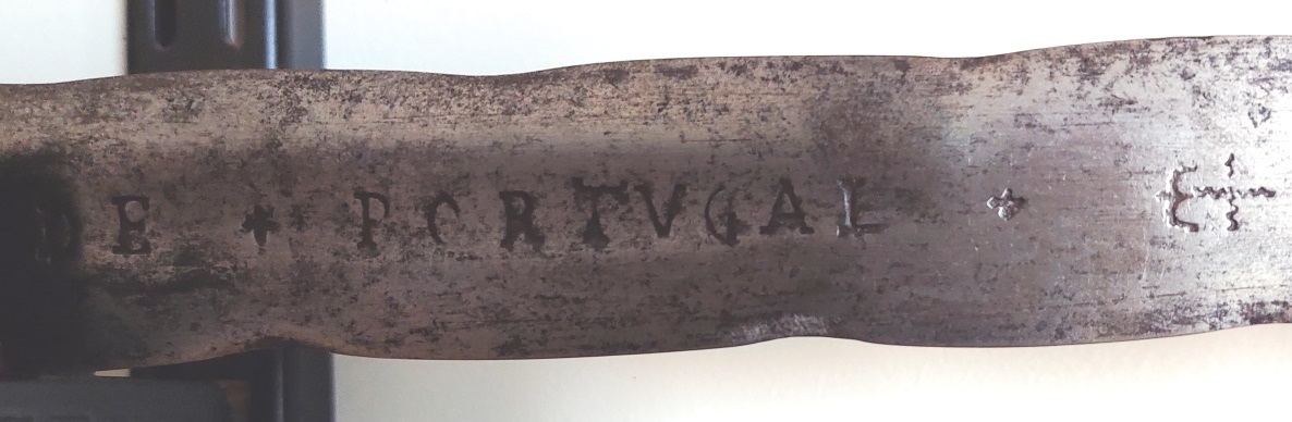

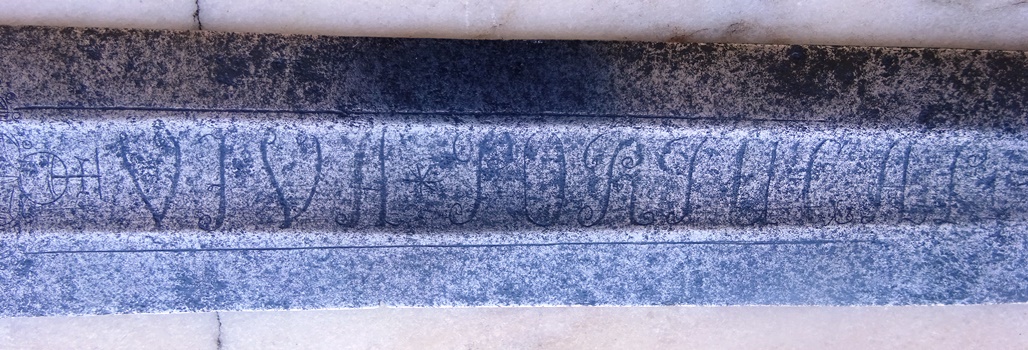

These swords present often associations with Portugal, like the one with the inscription "VIVA O NOSO REI DOM IOSE O PRº DE PORTVGAL" (straight position). There are also exceptions to the ammunition grade, with even a guardapolvo (I own that one).

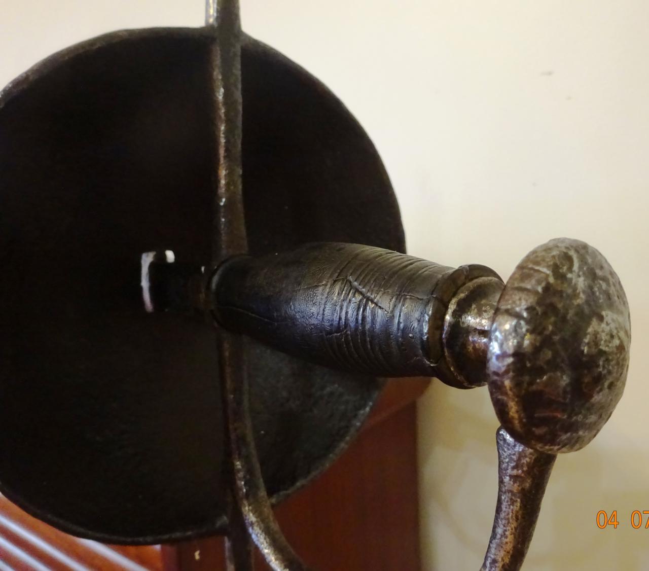

Congratulations on your new cup hilt Fernando, I like it because unlike most it has the Flamberge blade type and is a long one for this type of cup hilt.
Considering most rapiers of that period had a length around 120 cm or more im not that surprized to see this one with such a long blade, but yours is actualy wide to for a long blade, a very nice one!

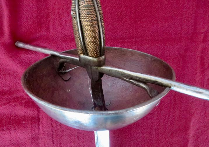

As i previously noted, i had signs that Portuguese favoured 'more' the welding system. One thing i know is that certain authors, not willing to be compromised with risking to determine whether a (cup hilt) sword is Portuguese or Spanish, simply call them ... Iberian. Having a Portuguese inscription may not be enough to define their origin; i have a cup hilt rapier that i bought from a well known Spanish dealer, with the typical VIVA EL REY DE PORTVGAL and his firm opinion, this sword is Spanish. It is so possible that, due to the two countries proximity, you could order a sword from Spain and later have its blade engraved in Portugal.

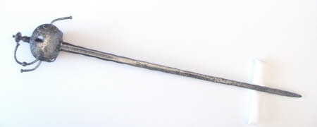

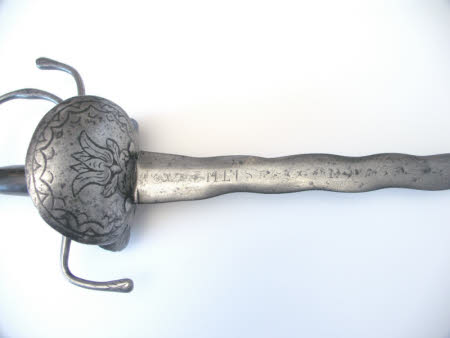

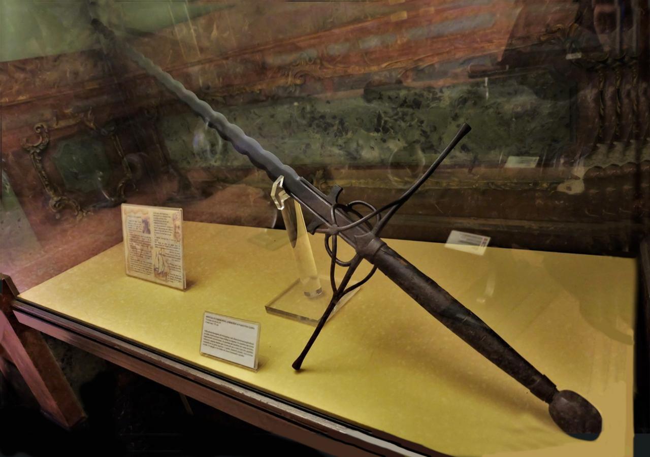

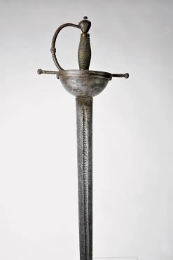

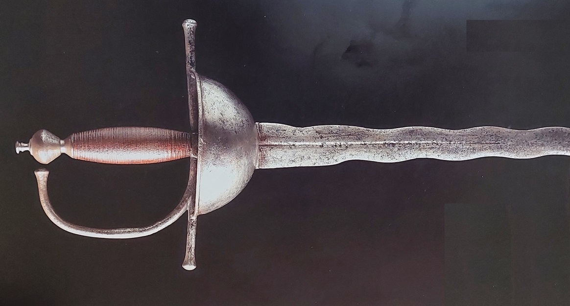

I thought it looked familiar; I photographed this in the Lisbon Armoury Museum back in 2019. Don't know if it is of interest here but... anyway:
Thank you so much for that, Keith. Excelent call. This sword has been brought to attention in a previous thread a while back. Glad you have visited a museum in my neck of the woods.

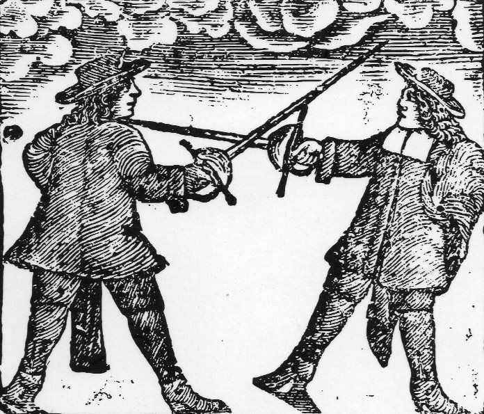

Attached ... and just for fun; fencers in the training floor (1685).

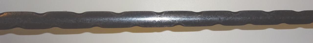

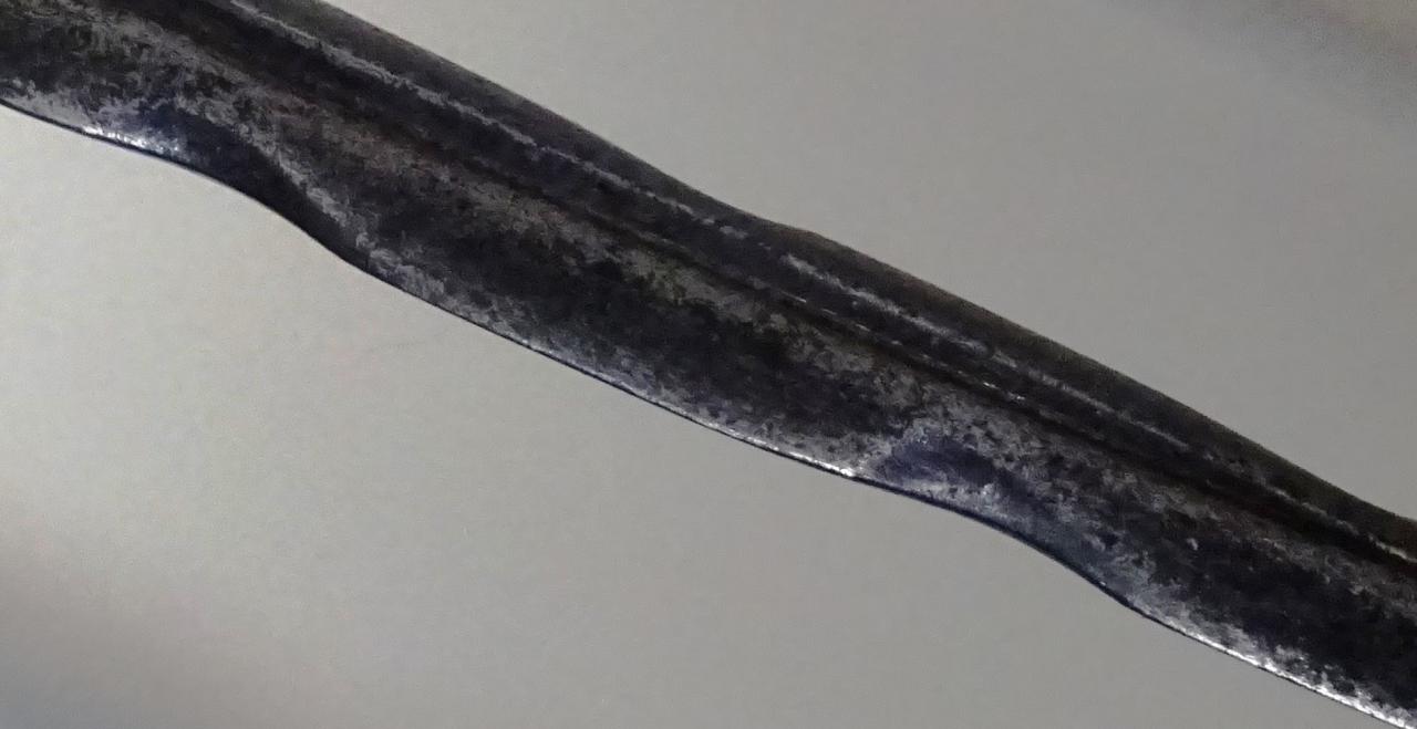

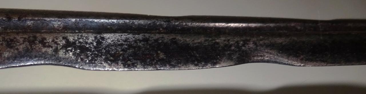

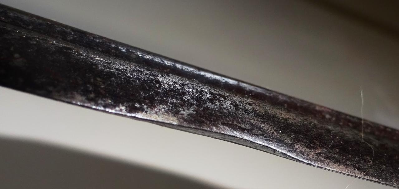

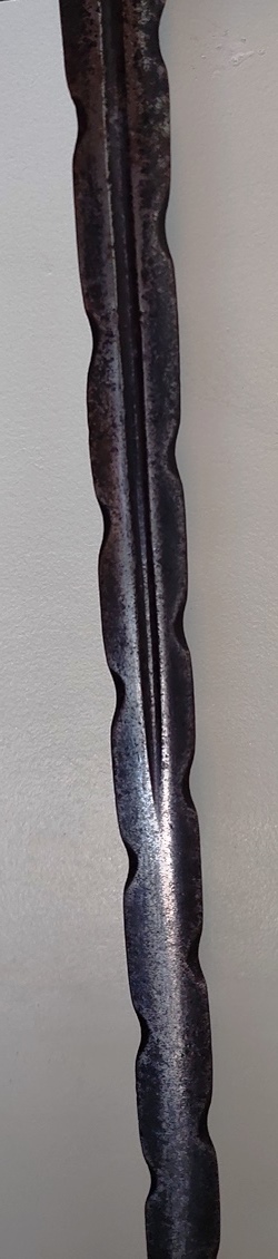

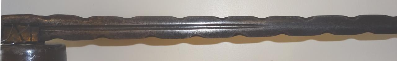

Are the wavy parts of the blade sharp at all?? If not, they are clearly not for cutting. Looks to me like its decorational for ceremonial use.

It depends on whether you see it in pictures or with the naked eye. In the example in discussion, both 'upper' edges and identations are sharpened, with different techniques, so i notice; the sharpness on the lower parts appears more acute. I wonder if the pictures i took are elucidative ... not easy with my humble abilities.
This thing of (any) blades being operational or decorative depending on them being or not sharpen/ed, may not be a black or white issue ... i guess. There is a montante (two handed sword) in Lisbon military Museum, dated circa 1500, attributed to navigator Vasco da Gama, which the photographer (i guess also the caption) defines as being 'almost' decorative, judging by the XVI century period, and i read in period chronicles that the nobility in India, the social class that marched on the front of troops, used such montantes to open way among the opponents. Whether those were not sharpened, would that be a pertinent question ?

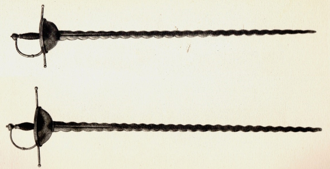

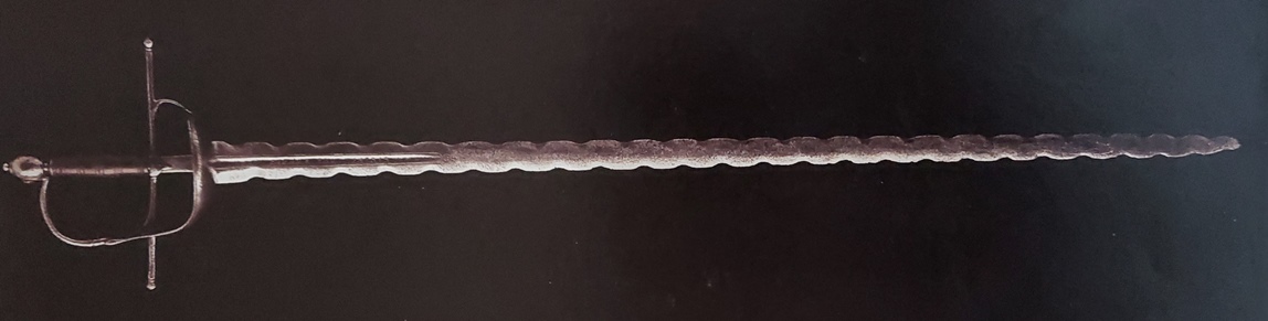

Swords with undulated blades from the Pindela Manor; a collection amassed by the 2nd. Viscount of Pindela (1852-1922). After he died, the widow has deaccessed the collection, which is now exhibited in the State owned Palace of the Dukes of Bragança.

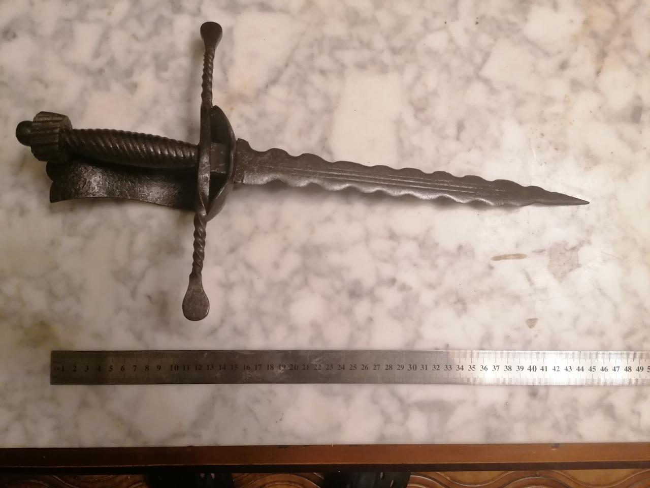

I have a heavy Main Gauche with a wavy blade, I will check it later maybe its blade comes from a sword as one of the above.
PS. Now I notice. In the drawing of the two fencers fom Thomas Luis, they do not put any finger over the cross (you also do not on the first post). I find taking a cavalry 1728 without passing two fingers over the cross as problematic.

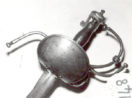

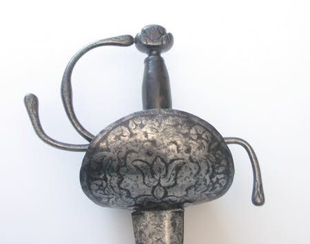

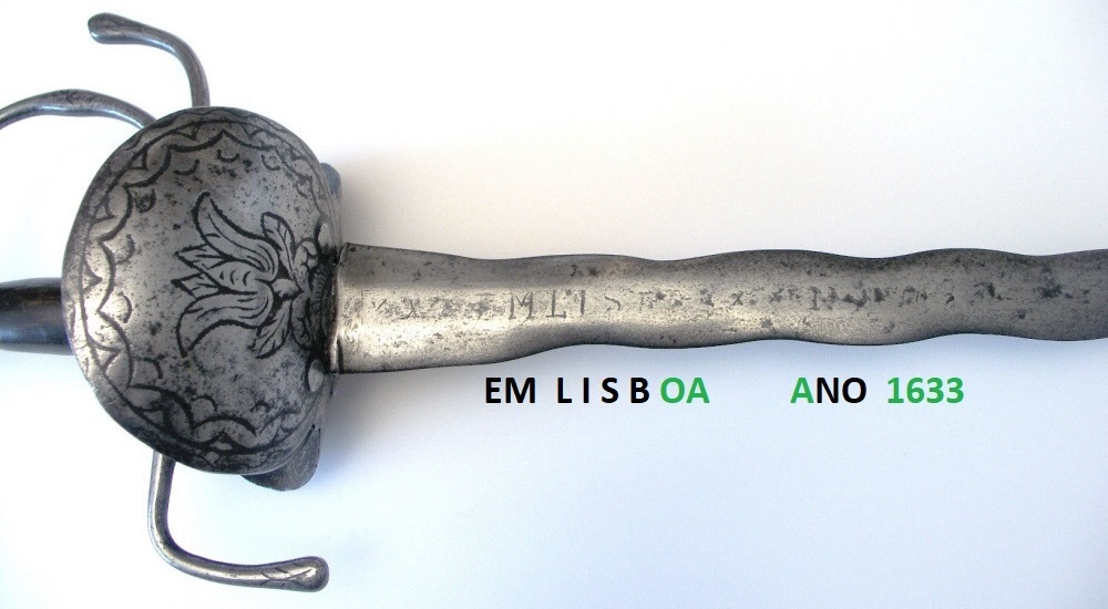

I found another couple of Portugese wavy swords. IIRC from a Brazilian collection.

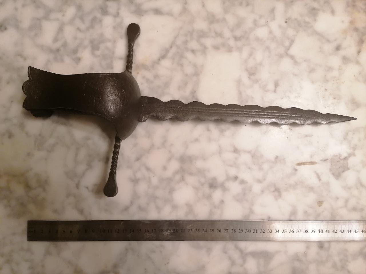

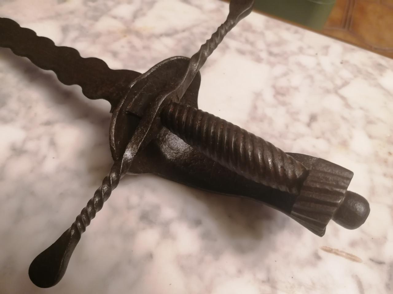

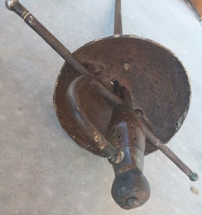

Next is my navy dagger with a wavy blade, posibly recycled from a sword.

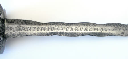

I happen to have a copy of TRATADO DAS LIÇÕES DA ESPADA PRETA; most interesting.
That sword signed by ANTONIO CARVALHO is a rarity. This smith is listed in a precious two volume work by SOUSA VITERBO "A ARMARIA EM PORTUGAL" (1907). The sword shown here had in the other side of the blade EM LISBOA no 1633 and could well be the one present in a Spanish/Portuguese exhibition that took place in Lisbon in 1882 (catalogue Item 313 Page 235).
Old 22nd July 2022, 04:00 PM   #25
Originally Posted by midelburgo View Post
... Next is my navy dagger with a wavy blade, posibly recycled from a sword...
Looks like a rather "different" dagger indeed... and an old one. I wouldn't mind having it
Old 22nd July 2022, 04:23 PM   #26
midelburgo
Join Date: Jun 2005
Posts: 299
It weights 850grams for some 45cm. The grip is solid iron and the sail is quite thick so it could be used for punching.
It is tinned. And on the tin it was covered in black paint, possibly made with coal dust and boiled hooves (as navy iron guns). The grip was covered in red paint.
I bought it as a theater something. When I got it it was a ball of rust, you could not see the grooves on the blade, much less the designs on the shell. In order to preserve the tin I decided to use electrolysis. That destroyed most of the paint by electrophoresis, the protein moved to the + electrode and the coal was freed in the buffer. It was a confusing mess until I realized what was happening.

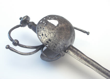

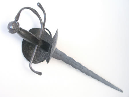

The swords above are in Cornwall, in a Manor called Cotehele, not in Brazil.
https://www.nationaltrustcollections...cotehele+sword
https://www.museumsincornwall.org.uk...nwall-Museums/

Old 22nd July 2022, 06:43 PM   #28
As i said, i wouldn't mind having it
...The swords above are in Cornwall, in a Manor called Cotehele, not in Brazil.
Now i don't think it is the same as the one staying in Portugal; which is described as a cup hilted version.That makes two examples by this smith, which doesn't prevent them from being rather rare swords.
