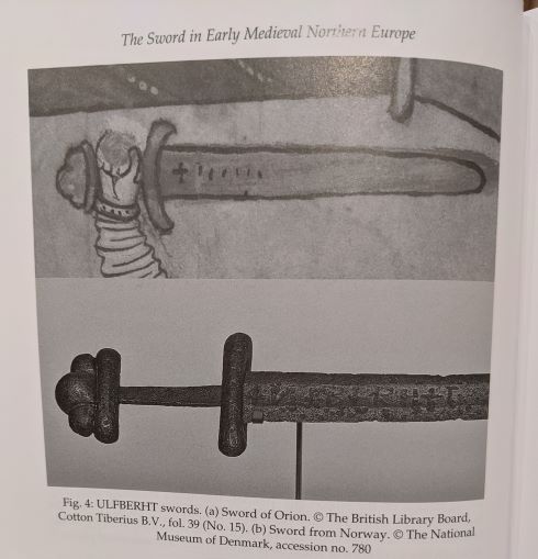

In "The Vlfberht sword blade reevaluated," from 2008, noted sword scholar Anne Stalsberg says that the high count on documented Ingelrii's is 37 by Geibig. Of those 37, she accepts 32.
For reference, Stalsberg examined 166 Ulfberht's in her study. But she says that there is really no good way to estimate how many there are for a couple of reasons. First, there are a lot in private hands. Second, given the way inlays can deteriorate or be obscured over time, determining which swords are Ulfberhts through close analysis, delicate cleaning, and CT scan is a monumental task because of the volume of swords. There are over 2,500 swords in Norway alone that still have to be examined.
There are a lot of nice sword finds in Finland, and there is some evidence that Finnish smiths had advanced techniques that weren't practiced in western Scandinavia. But the weight of the scholarship at this time is that Ingelrii is linguistically Frankish, and most likely the name of a person because of the finds of inlays with "me fecit" (made me) following "Ingelrii."

Vilhelmsson, this is a fascinating topic which has intrigued and obsessed me through most of the many years I have studied arms. Makers marks and blade inscriptions have been a field which has really needed far more investigation in the broader scope of arms, however the Ulfberht and Ingelrii inscribed blades have been one of the exceptions.
Some years ago as I was researching the 'Passau wolf' mark, I began to wonder if perhaps this was a kind of pictographic representation which would recall the 'berserks' of Scandinavian and of course Viking fame. I thought that with little literacy, that such a device representing 'feared warriors' would have a place on the blades of swords in Passau, a sort of center for mercenary soldiers. In the well known convention of quality or 'trademark' type symbolism this would recall the also well heralded exploits of these much earlier warriors.
It was the that I began thinking of the very swords the Vikings used, the 'Ulfberht' bladed swords, and that perhaps the word itself meant something akin to 'wolf man'. With this possibly the word was used as a kind of metaphor in a religious sense to protect the warrior in battle and imbue him via the sword, the power he needed to prevail.
In the past couple of days, trying to research more so I could better reply here, I found the article "Ulfberht Blades: New Answers to Old Questions" in 'History of Antique Arms: researches 2016'...by Anne Feuerbach and Thomas Henley.
In these, that very idea was posed in a compelling study which reflects the remarkable research which Ms. Feuerbach has always presented in her well known work on the metallurgy of sword blades, well supported by her co author Mr. Henley.
In this article (2017) it is revealed that most of the Ulfbert blades of the 10th century, many of which were found in English regions, were likely commissioned by Haakon the Good, the Norse ruler who was situated in England in those times. What is unique on these early examples is that the blades were forged using crucible steel from Central Asia traded with Scandinavia, and this trade is well supported in the material. The other apparently later examples of Europe were of high quality smelted steel.
It would seem that perhaps the early examples (of Haakon? 10th c.) of crucible steel ingots may have been the initiation of the Ulfberht 'hallmark' which was carried forth in the Frankish production. Naturally where these were produced is still inconclusive, but possibly this was the case.
It is noted that in these times literacy was virtually non existent, and paganism and the use of runes were of course common. While Christianity was becoming well spread, it was a transitional period with regard to language and the methods of conveying it. The use of alphabetic characters was not notable until the 11th century.
Here it is suggested that Haakon the Good, who is believed to have commissioned these early Ulfberht blades may well have used the 'word' (in Carolingian letters and with the Cross Potent or Greek cross) to appease both the Pagan and Christian elements of his forces. The 'wolf' metaphor was of course recognizable to both (cited, "Wulf min wulf: An Eclectic Analysis of the Wolf Man" by S. Danielli, ' Neophilogus, 91, (3), 505-24, 2007).
The Greek crosses would have had a certain 'runic' appeal as well as the Christian symbolism , and the 'word' would be seen as a recognizable one which could be read by the literate in its metaphoric sense.
What puzzles me (as a non linguist) is that the 'T' is separated by a cross rather than being included in the word. Is this some sort of diacritic (?) or superscript type of abbreviation?

Stalsberg writes that Ulfberht, and, especially, the consistency of the spelling of the Ulfberht swords she examined over the mid-8th through late-11th century is linguistically Scandinavian. Scandinavians had dropped the ‘W’ around 800, to when the Ulfberhts are first dated. Whereas, variations on Ulfberht were more common in the Frankish realms until the end of the 11th century, including Wolfbert, Wolfbertus, Uolfberht, Uolfbernt, Uolfbernus, etc. So maybe the word on the blades, as argued by Feuerbach, had a Scandinavian source rather than a Frankish source.
However, Stalsberg also writes that the inlay is written in Latin/Carolingian characters which suggests that it was a Frank who was inlaying, or directing the inlaying of, the blades.
Stalsberg does not look at the Greek cross as a symbol of Christianity. She also seems to take it for granted that Ulfberht is someone’s name, which could be a mistake. Instead, she asks who was literate and signed their name preceded by a cross? Abbots and bishops. And these bishops and abbots employed a lot of slaves who would be doing the actual smithing. She also suspects that the second cross may indicate a second person, likely the overseer or “swordmaster,” who either had the same name as Ulfberht, or was just represented by the second cross (E.g., Ulfberht & Ulfberht, or Ulfberht & Son(s)). She is careful to write that she can’t conclude that it is the signature of an abbot or bishop because no contemporary abbots or bishops with that name have yet been found.
Ulfberhts are traditionally (What can I say? I’m an American; 100 years makes something “traditional”) believed to have come from the Lower Rhine due to the finding of the name Wulfberti in the bequest of a villa to the abbey St. Gallen in 802 AD. But Stalsberg writes that there is a need for an academic analysis of the Confraternity books of the abbeys of the Lower Rhine to find out whether there were abbots or bishops or other people named Ulfberht associated with abbeys to draw a more conclusive connection between the Ulfberht blades and abbeys of the Lower Rhine.
Stalsberg’s maps show that most of the early and mid-Viking Age Ulfberhts have been found in Norway and not in the Frankish realms. Ulfberhts from the late Viking Age are more evenly found across Northern Europe. It is unlikely that a Frankish smith could be commissioned to make the blades for Haakon or that they could have been traded for, as analyzed by both Stalsberg and Feuerbach. Frankish sword blades were not for traders; they were to be paid as tax to the king/emperor or to be used to arm the Bishops’s levies in service of the king/emperor. Feuerbach and Williams write that they could have been forged by Baltic smiths at the terminus of the central Asian trade, which was certainly robust as that time. Stalsberg suggests that they likely arrived as either loot or as a ransom payment for bishops and abbots, but that we just don’t know yet.
If Haakon indeed existed, then he had a long reign for a Norwegian king! This supports the idea that he could have been alive long enough for the mass production of a blade with a specific signature. But, again, Ulfberhts pre-date Haakon.
Preserved Viking Age Scandinavian art is mostly in the form of metal work which is not delicate enough to reveal blade decorations. European Viking Age art is not really interested in swords. Anglo-Saxons weren’t very interested in portraying swords in art until the later Viking Age, and there are very few, if any, other than the following, examples portraying blade decorations. However, there is one piece of Anglo-Saxon art in a miscellaneous manuscript that could be an Ulfberht sword, and I attached a photo here.
This appearance in a manuscript suggests that there could have been general knowledge about what a fine inlay like this meant in regards to the quality of both the sword and the man who wielded it. But it is also, again, a limited sample size. I wanted to write that it meant we could draw the conclusion that the Ulfberht symbol was at least widely regarded amongst the warrior and authority classes as a symbol of quality and prestige, but I think we can only draw the conclusion that maybe it was regarded as such.

To continue on INGELRII, I found the following article in the spring 2005 Park Lane Arms Fair journal,
"INGELRII: A Continuing Tradition in Early Medieval Swordsmithing"
by Michael R. Gorman
On p.30, it notes;
"..with the advent of the Ulfberht blades, we perceive a moment of technological innovation in sword smithing , which the original smith(we presume his name was Ulfberht) chose to proclaim by an additionally novel way of inscribing his mark/tradename. It seems that this tradition continues with the rise of the INGEL group of inlays, which are morphologically very similar to the ULFBERHT inlays, and carry forward without perceptible interruption into the mid 11th c.".
It is suggested that the extended chronological range of these swords, surpassing the life span of one person, likely may have been a family firm or closely linked shops in a group.
Further, the much improved quality of these blades was superior to the older PATTERN WELDED blades, thus ULFBERHT became synonymous with high quality. Naturally copying of the inlaid inscriptions was inevitable.
At the end of the 'ULFBERHT' period (950AD +) emerged another group of morphologically inlaid blade inscriptions in form of the name Ingel, (usually INGELRII) but there appears to have been an overlap in transition. While the Ulfberht ceased, the INGELRII group carried into c. 1050AD.
One sword found in a river bed (River Nene, Ravens Willow, Cambridgeshire) actually had ULBERHT on one side and INGELRII on the other!!!
There seem to be variations in the INGEL group, such as INERIIGEMITT; INEERIIRIETI; INCELRII and others. With the original INGELRII, the grouping seems sometimes separate suggesting RII is a suffix, recalling the often separate 'T' in Ulfberht perhaps being of similar intent.
Whatever the case, these two 'names' became synonymous with quality for the apparently dramatic improvement in smithing techniques and production. The copying and spurious reproduction of the inlays of these groups of swords of course suggest that they are more a quality imbuement than makers name proper, and the origin of these names remain unclear.
With regard to the metallurgy of these early medieval blades, it is noted (p.35) that an INGELRII sword (presumed by the author to be last quarter 10th to early 11th c) when cleaned revealed the appearance of Damascus steel.
While this article predates the other works we have discussed, it is noted that the 'jury was still out' as far as whether authentically crucible steel or simply a makers effort to duplicate it. The author notes that Alan Williams was among those investigating this sword along with Peter Finer; the late Ian Peirce; the late Claude Blair and other notable figures.
Some Speculation Incorporating Feuerbach
I wonder if there was an early abbot named Ulfberht? Haakon, or someone similar, owned a sword, maybe a valued ancestral sword that was one of these Ulfberhts. His Ulfberht fascinated him because of its beautiful iron inlay, powerful magic from the runes and its history of having been wielded by powerful ancestors, and Ulfberht, as read to him by one his Frankish slaves, was a homonym with beasts important to Norse paganism, plus it had a cross, a powerful symbol of the southerners’ god who sacrificed himself to himself, similar to Odin.
He commissioned many Ulfberhts after he got rid of his brother. Some of the swords he gave to his sword host were made from crucible steel in the Baltics, some were partially made from crucible steel, some were made from bloomery steel, and some were older swords. The Ulfberht sword then proliferated across northern Europe in the late 10th and early 11th century as Scandinavians saw greater use as mercenaries and particularly with Cnut’s considerable empire.
