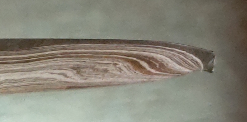

My keris tip is somehow damage by the courier company during inspection. The tip is no longer sharp but there is a small 'flat' tip. Anyone can advises should I leave it or try to fix it using a soft rubber hammer etc?

I straightened many kris blades damaged at the tip by means of small pliers first, then careful hammer blows on an anvil if required. I never faced any breakage of the tip but it can happpen....
The shape of your kris tip looks very rounded and the flat tip is very small?

That won't be easy to correct Anthony. If it was bent one way or another you might be able to straighten that out; but with it flattened like it is that will be a real challenge.
You would have to cold forge a new tip from the flattened area then dress it to a point with a file of some sort.

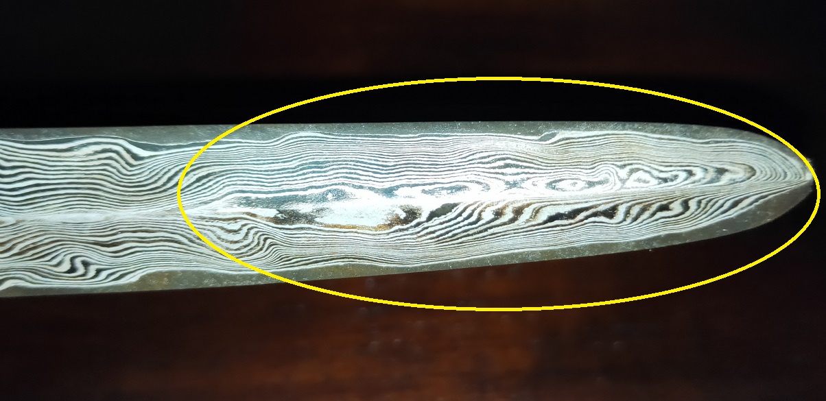

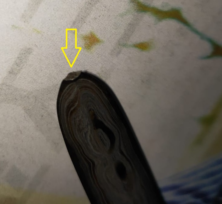

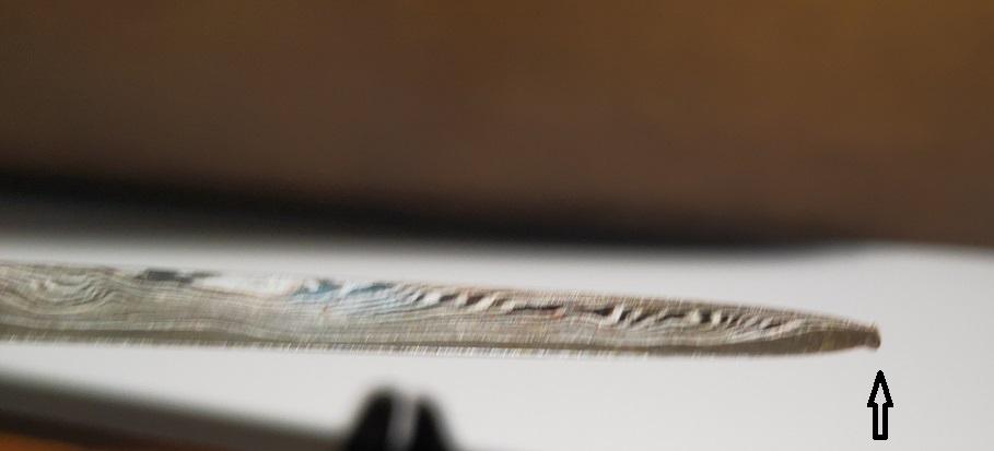

Hopefully these photo can tell more about the condition. The circled part has been heat treated.
