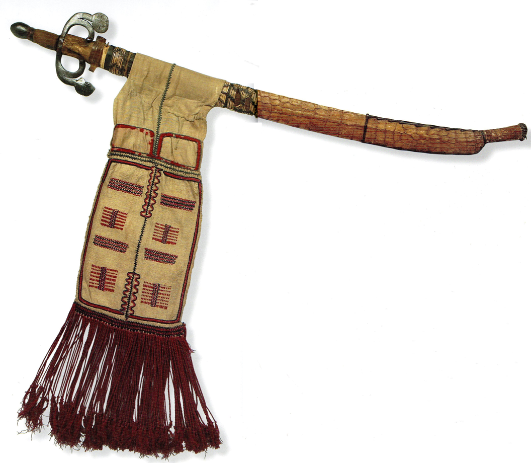

These are ( badly scanned ) pictures of some swords a la Portuguese, with the so called crab or colhonas ( testicles ) guards, a model used in the XV century discoveries period.
The first picture is of a peculiar Timorese specimen, with all parts remaining original, including the grip, which is very rare to find. The scabbard beltings are in sinew and vegetable fibres, and its shape is aledgely that of a crocodile, a Timorese symbol. It is adorned with a handwooven band, traditional of warriors and chiefs. The unsheathed blade is the first image in the second picture. Eventually its straight form was later fire bent, to fit in the slightly curved crocodile scabbard. The other two swords are crab specimens from the XVI-XVII century.
The Timorese set would be a XVI century blade and a XVIII century sheath.

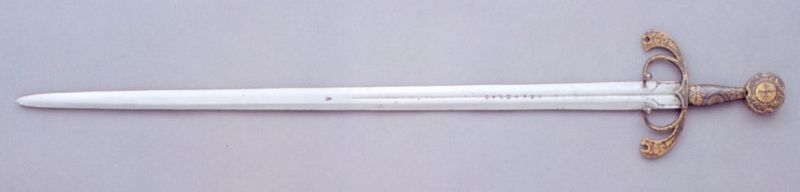

Well, the Portugese ones have these flat, circular quillion ends (hence the "colhoes" ), the Spanish ones tend to widen progressively. Cut-out designs there and in the pommels are not uncommon in both types. Also, the proportions guard - pas d'ane - grip - pommel are different between the Spanish and the Portugese models, as tends to be the typology of the blades.
There's also the exemplars so kindly made available in Antonio's page
Of course, there's a lot of variations and exemplars that stand in the blurry middle ground (that's the thing with the "mutual influences"...), but there's some ground for distinguishing them. But there's not THAT many surviving exemplars, that's why I jumped to the chance of getting this book. Now, if I could manage to get Daenhardt's in a better shape than the lousy photocopies I have now...
Here, pics of the ones Philip have mentioned plus a couple more. Up to down and left to right:
Fernando the Catholic King's (Granada), the so-called Fernando the Catholic King's in the Real Armería (Royal Armoury) in Madrid, the so-called Gran Capitan's also in the Real Armería in Madrid, and finally the so-called El Cid's Tizona, formerly in the Army Museum in Madrid.
