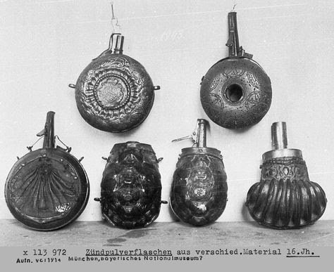

The info is however mainly about other shapes of flasks, such as Trapezoid & although Michael most tantalizingly showed a photo of an almost identical flask (see 2nd photo) in a collection (his I assume) I have been unable to locate any discussion about it. I would like to learn what country of origin is most likely & also if for military as opposed to sporting use & any narrowing of the date range would be very nice.

Until some years ago I had in my collection this powderflask which probably is very similar to the piece shown. The number "2887" says that it was in earlier times an item of the Austrian "Landeszeughaus" of Graz.

Thank you for posting that, all three examples are indeed very similar.

A very interesting and rare flask! It has to be from the same area and time as that of Michael and Corrado. Wonderful piece of history!
It is so similar that I think we can say identical, so very likely from the same 'home'.
I think somewhere I saw some of these posted by Michael.

This flask in one of Michael's threads (below) has the same small pouch arrangement, but is slightly later.
http://www.vikingsword.com/vb/showth...t=Bullet+pouch
However, in the engraving of the wall display, we see three depictions of flask with pouches Very similar to yours!
I thought these were for balls, but Michael thought them too flimsy, and more likely for wadding or cleaning material, (tow I suppose) and for small tools, worms and scrapers etc.
