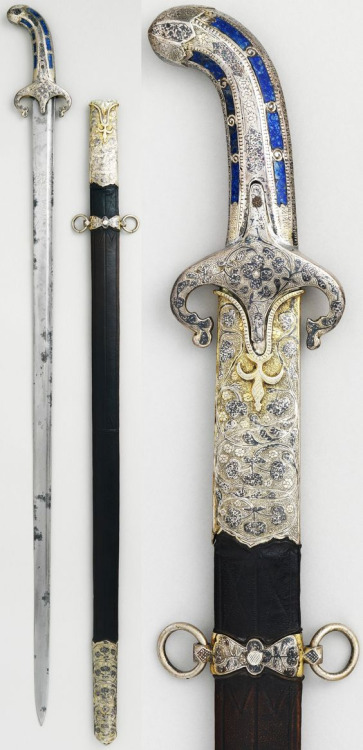

I just bought in an auction this interesting sword:
said to be turkish ( arabic stamps ) with niello and silver(?) hilt and scabbard mounts.
European blade with Pro honor et patria written ( Romanian motto ? ).
What do you think ?

looks like this ottoman sword model I found on internet ( sadly without all the precious stones !!).

Clever man!
and you got it for a very good price!
I think it's a kind of Hungarian palash clearly with an Ottoman influence as you said.
Congrats
Kubur

I think we are in accord Kubur, I just answered on the concurrent post on this on European.

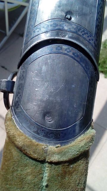

It's not Hungarian. Appears from the images to be Caucasian; please post closeups of the niello work on each mount and an example of the silver marks and we'll be able to nail it down

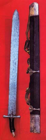

Does anyone know why some Ottoman and Balkan swords have their rings set in parallel on either side of the scabbard, rather than alongside each other at different lengths of the scabbard?? It seems a curious practice.
Old 8th May 2017, 01:14 PM   #9
Because they used baldricks.
Old 8th May 2017, 03:10 PM   #10
Victrix
Victrix's Avatar
Join Date: Apr 2017
Location: Sweden
Posts: 790
Like the Sipahi in the picture on the right? Looks an awkward way to carry a sword unless mounted?

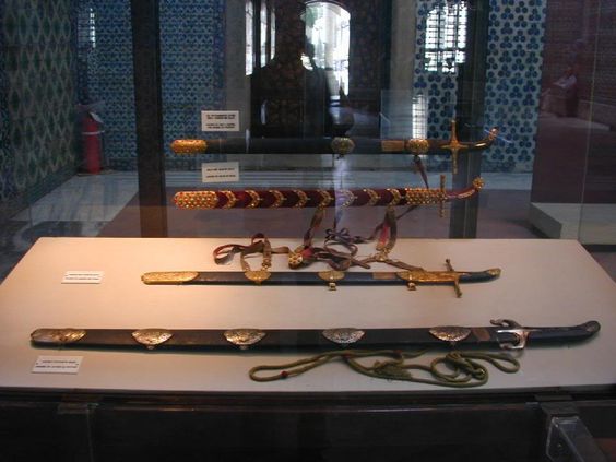

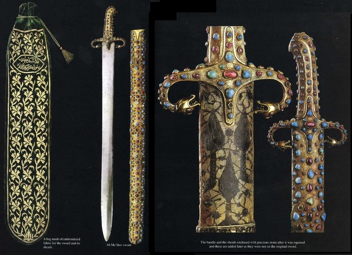

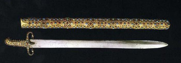

Waiting for the shipping, I was looking for this particular sword shape:
oriental hilt with ''snakes'' guard and straight blade on the net.
I found two wonderful swords with the ''same'' shape in two of the nine swords of the Prophet Muhammad
( now in the Topkapi Museum Istambul )
: Al-Mathur and Al-Rasub,
Do this model of particular hilt and straight blade still been made in 19th-20th century in Arabia ? ( sorry for my bad english )

Posts: 278
These swords which are housed in Topkapi sport 16th century Ottoman fittings, which replaced (unfortunately) their original hilts and scabbards. They are not Arab in from.
However, cross guards with upward facing quillons with snake/serpent heads seem to have appeared in the 12th Mamluk sphere of influence in the levant, and disappeared by the 16th century with the evolution of the swords of the region into sabers (early Turkish sabers)
EDIT: However the blades are original 7th century blades, wootz as well, most probably made in India and imported into the Arabian Peninsula
Cheers!

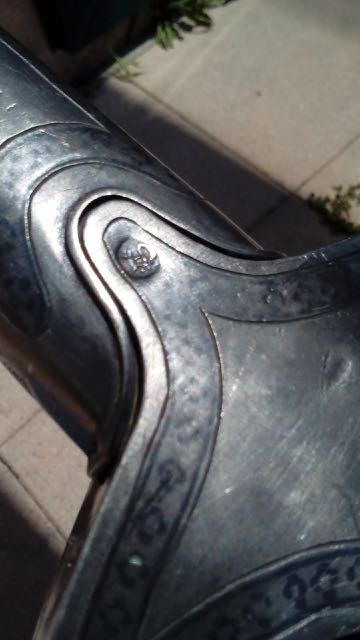

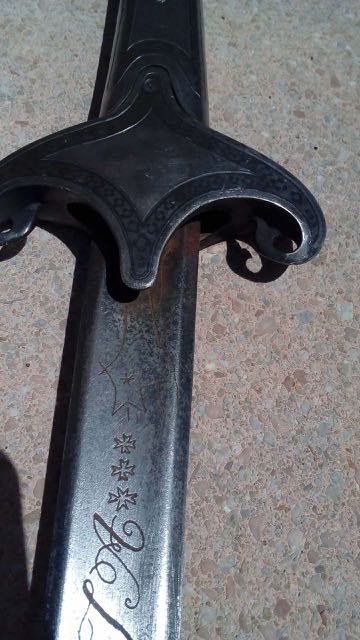

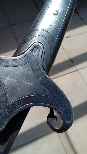

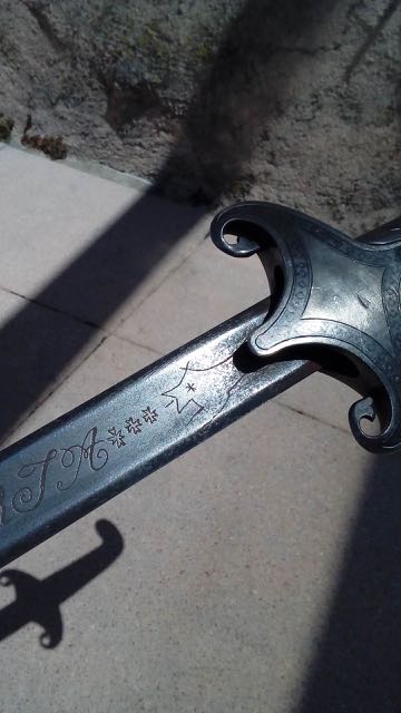

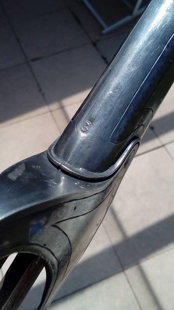

Hello everybody,
I finally received my sword !!!! Long way from home !!!
The hallmarks/tughras consolidate me about ottoman mounts on an old european blade.
Is anybody specialised in tughras ? 19th-early 20th ?
what about the age/origin of the blade ? An Old Austro-Hungarian blade ?
