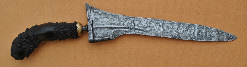

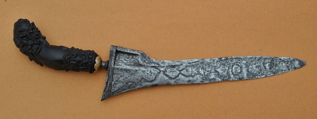

Alan, I am curious to know if you would consider this keris as pijit. The blade is very thin and flexible towards the point. You can see indentations on both sides.

A keris picit (pijit, pecit, whatever spelling ) is so-called based upon what appear to be impressions of finger tip in the blade. You say there are indentations on both sides of this blade, but honestly i cannot see them in these photographs. maybe Alan's eyes are better than mine.
Maybe you could try a different angle for your shot. The high-relief pamor pattern on this blade does not make it easy to assess indentations if they are there.

I know, it doesn't look like finger tips, but there are slight indentations, the blade is not flat. I would need to make a pic of the blade profile.

Sorry Dominique, from the pics I cannot tell whether I'm looking at a possible KP or not.
