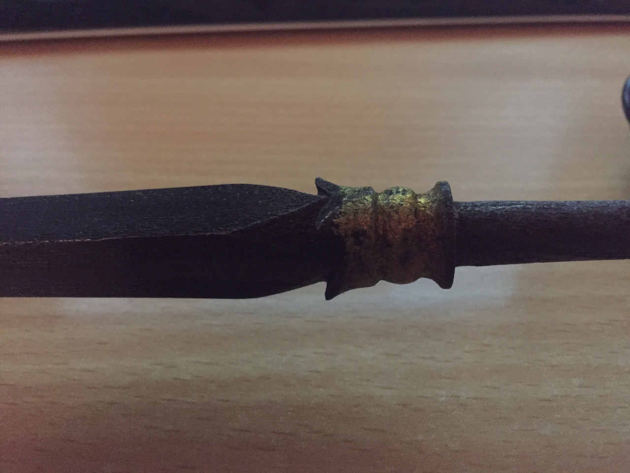

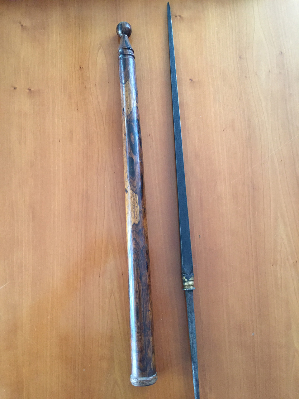

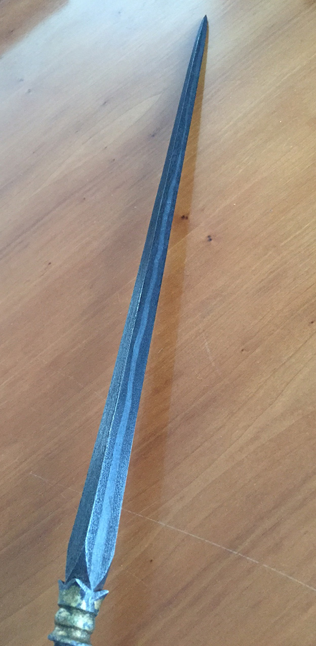

Could this be the tombak you mentioned?

Kulino, how many edges does this tombak have, 3, or 4?
3 I think
It is diamond shaped.

I think it is probably valid to call this a sajen ampel, but it is much finer than any I have handled.

Any idea about age?
What does the kinatah tell? As far as I can tell it is a kind of lotus. Nothing like an anggrek.

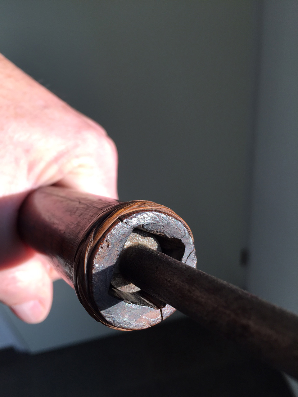

Please let me have a good, clear close-up of the base of the blade, taken at 90 degrees.
I may or may not be able to give an opinion.

Based upon what I can see in the photos, this is a North Coast Jawa tombak, probably classifiable as Tuban, quality is not as fine as I had thought from the previous photos, the factor that puts it into a lower class being that it is metuk iras.
I am not prepared to take any guesses at age, nor at the design factors.
