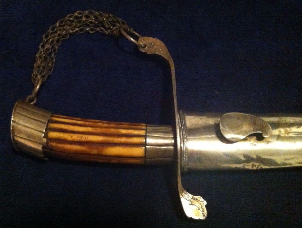

Hi Guy's
This sword i did get last week with some other items i placed also on the forum
but it is a mind crusher
IMO , it is a Javanese( or maybe Madurese) pedang with great European/ Dutch influence .
Nice antler hilt / wooden scabbard that is covered with 3 silver sleeves / Indonesian blade with pamor / just nice and complete .
But also impossible to find info about a similar one or maybe i'm looking at the wrong places.
Someone a opinion or idea's??
Danny

since nobody respond to your thread until now I will give it a try. It's a Javanese pedang IMVHO. Have a look here: http://www.vikingsword.com/vb/showth...ghlight=pedang

It is a Javanese pedang indeed. The european style pedang was worn by the guards of the kraton.

Hi Sajen en Henk,
Thanks for responding .
My opinion was also that is is a Javanese pedang worn by the guards similar like the wear a wedung , i did search for some pictures of wedung and some have the same shaped clip /ornament .
For myself i was looking for more reference or pictures from a similar pedang because the most pedang's of this type that we see is what Sajen posted in the link. With replacement scabbards or hilt's and most of the time a worn old blade.
This pedang has a blade in good condition , no chips etc..and the scabbard and hilt are different and also in a better condition than what we see usual, so i was and i'm still looking for some more pictures or info to compare.

Hello Danny,
Sorry, forgot to answer!
Yup, congrats obtaining this really nice pedang - I believe this example is more likely to be worn by nobility!
I can't offer a perfect match; IMHO it fits well with the variants encountered on Jawa though (the last 2 with variant blade types, too):
http://www.vikingsword.com/vb/showthread.php?t=22023
http://www.vikingsword.com/vb/showthread.php?t=17706
http://www.vikingsword.com/vb/showthread.php?t=19936
http://www.vikingsword.com/vb/showthread.php?t=21612
http://www.vikingsword.com/vb/showthread.php?t=21824
Nice antler hilt
Have a close look - might as well be ivory.
BTW, what are the chains made from?
Good call: The decoration on some wedung scabbards really looks like the clip on your pedang scabbard! Thus, this may point to an origin in central Jawa.

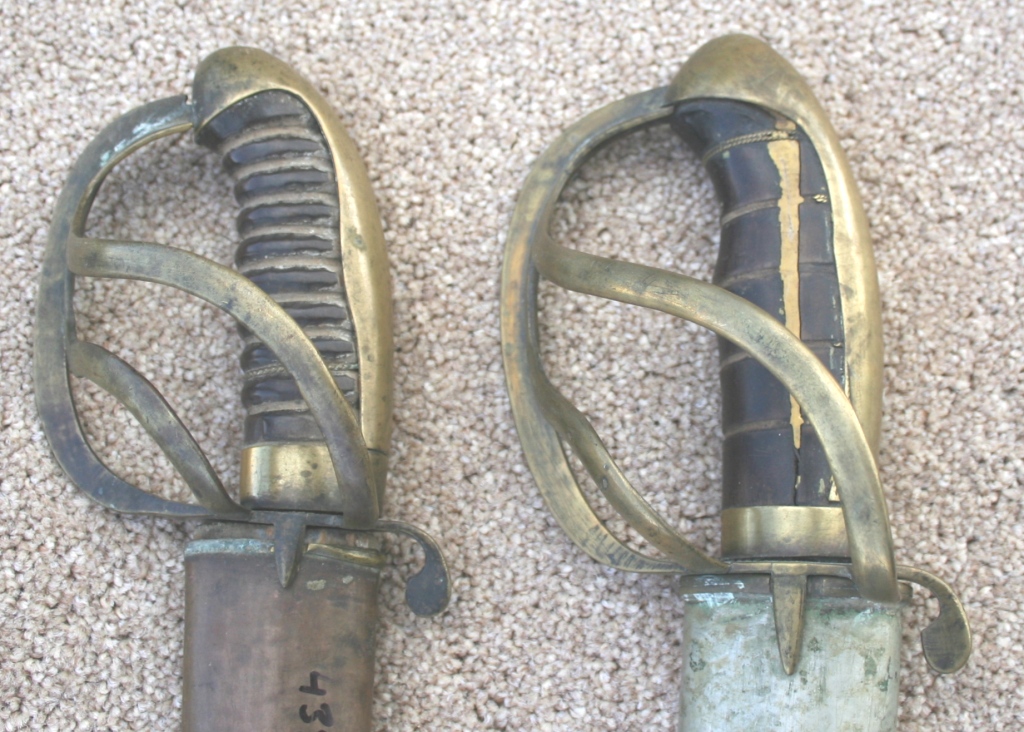

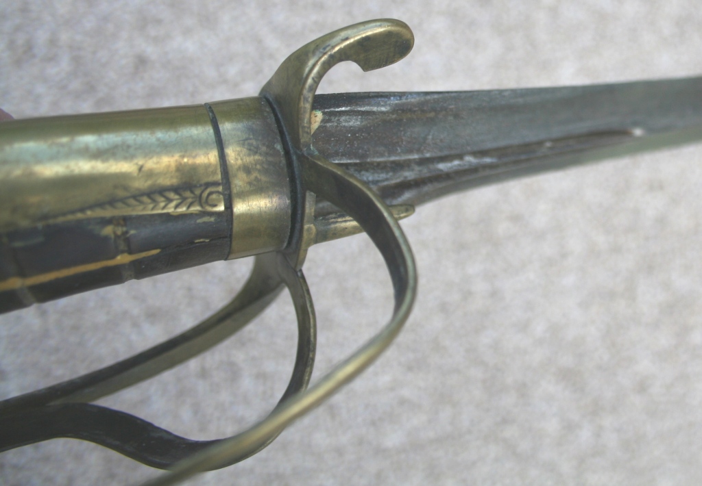

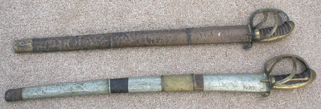

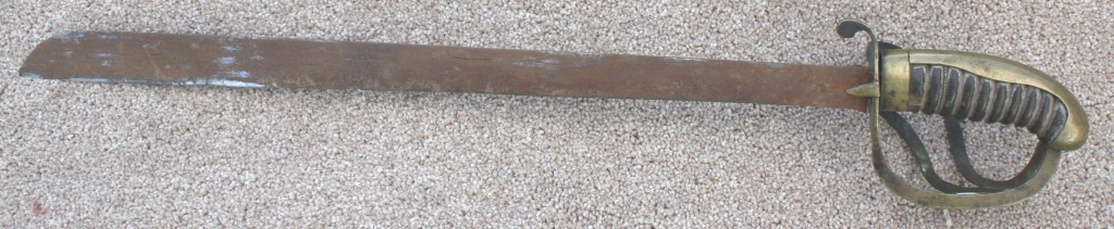

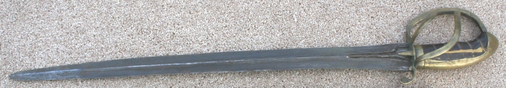

A couple more. Old ( poor quality ) stock photos of two that I have had for years.
Pre -cleaning photos, but they do show that one has a local made pamur blade and the other a plain monosteel.
I have always thought that these were Javanese but obviously with European influence.
Cheers
Roy

Hai Kai ,
I did not test or clean the chains yet but i suspect that the are from silver also .
Royston , thanks for the photo's .
Nice swords ! The have even more European influence as we can see on the hand guard.
