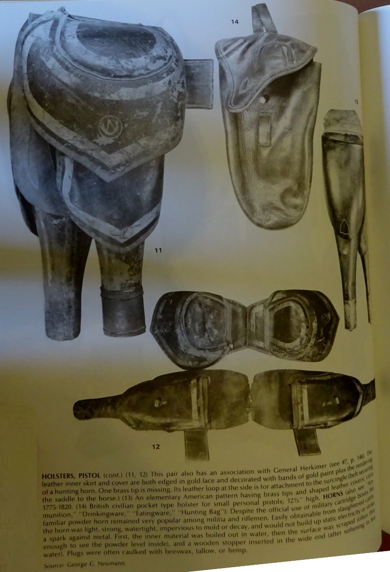

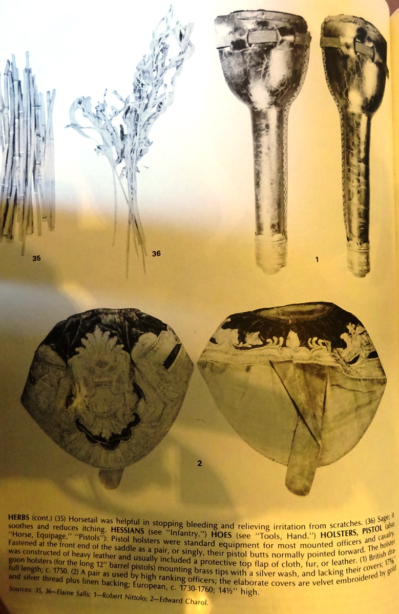

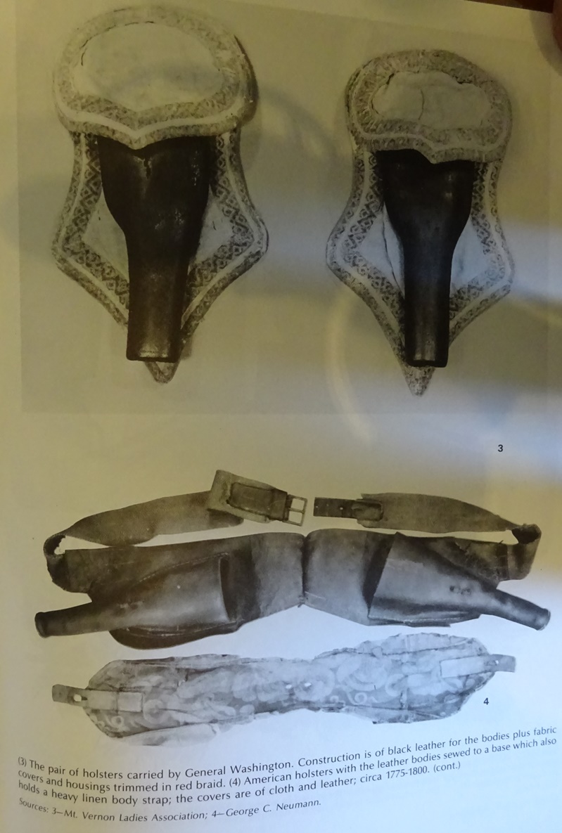

Yes, this one must have belonged in a pair.
Here are some lousy pictures taken with a camera from the "Collector's Illustrated Encyclopedia of the American Revolution", by George C. Neuman.
The book binding is too tight and the page margins are narrow; not possible to do it with the scanner.
