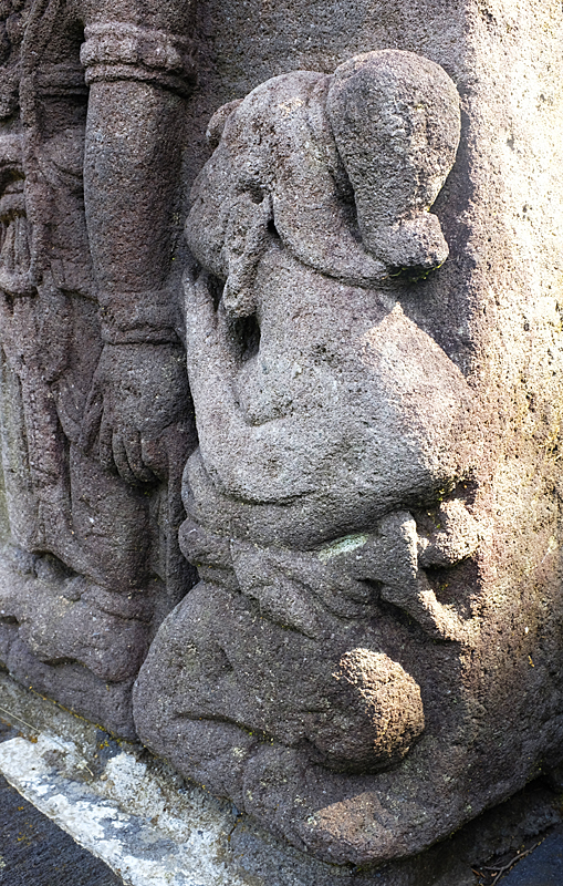

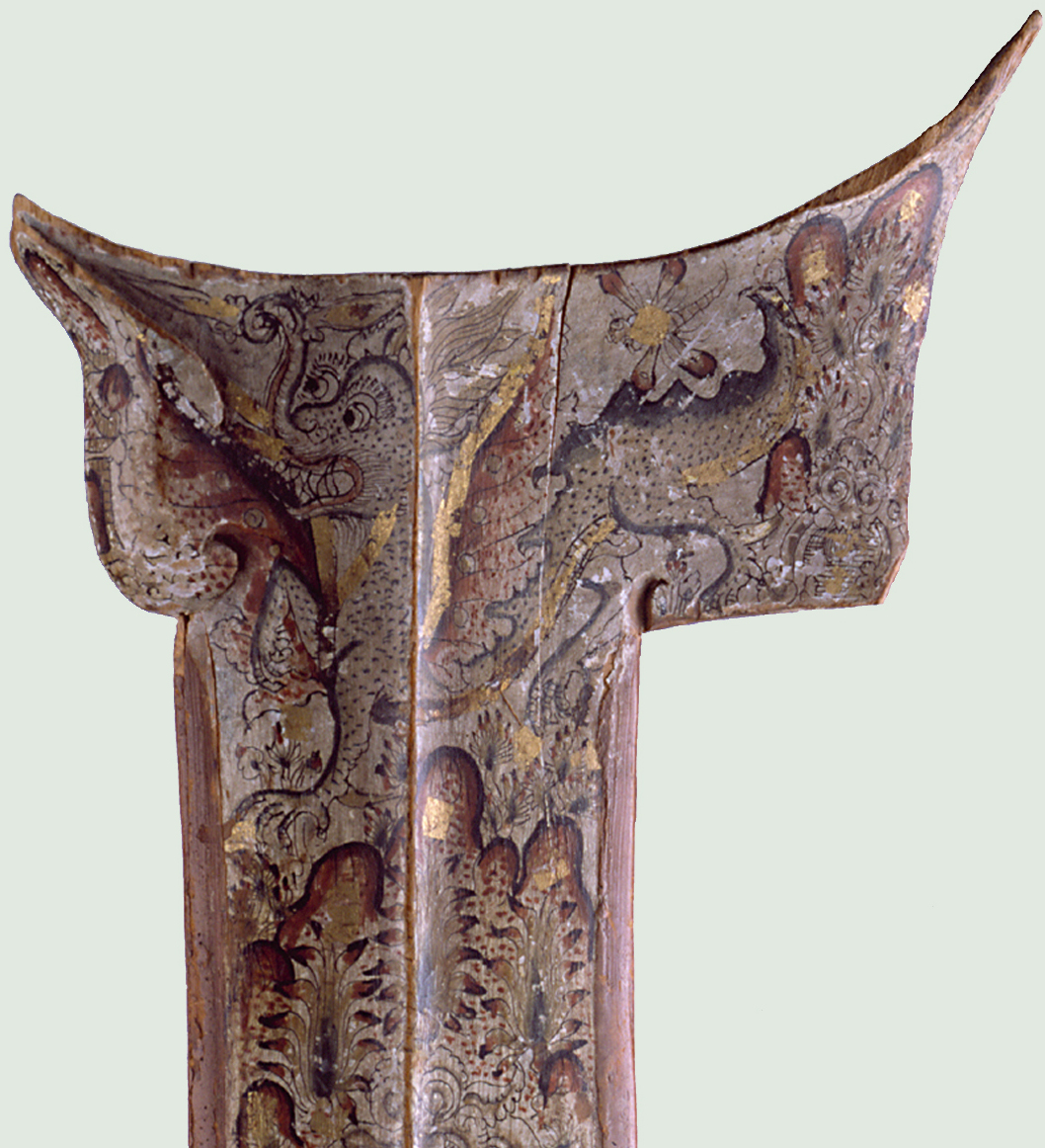

The first image is from the Candi Sukuh site.
Candi Sukuh is a 15th century sacred site that has been reliably dated to around 1437AD.
"Gapura buta mangan wong", the accepted reading of the chronogram giving the related date is 9531 = 1359 Saka or 1437AD.

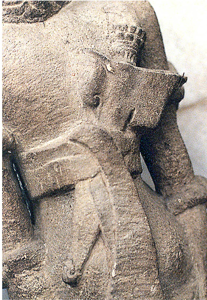

The second image is from Candi Penataran, an East Javanese temple complex constructed between the 12th and 15th century, with one reliable date of 1369AD. Candi Penataran was visited regularly by the Majapahit ruling hierarchy.
The Kingdom of Majapahit was established in 1293 by Raden Wijaya. It began to decline following the death of Hayam Wuruk in 1389; the Kingdom finally collapsed some time between 1478 and 1525.
The Kingdom of Majapahit lasted for about 200 years.
Both Candi Sukuh and Candi Penataran were active sacred sites during the Majapahit era.
Please take note of the keris scabbards shown in the carvings below.

Thanks Alan. I would say that the sheath in the first image, if the order hasn't reversed on my screen, has many attributes of a ladrang form.

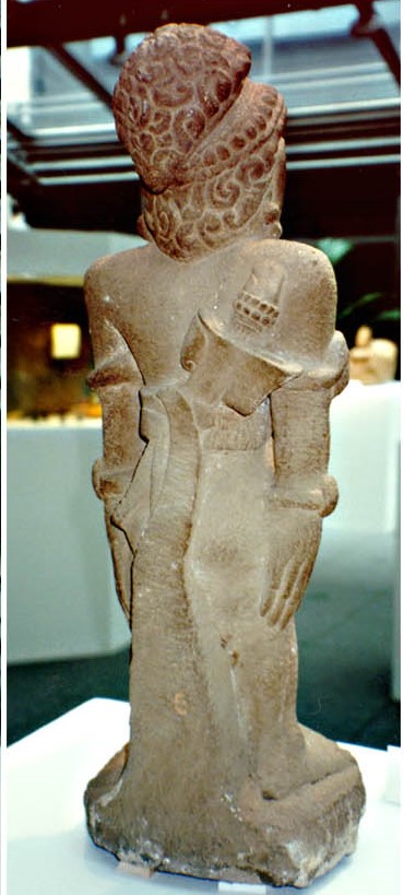

I cannot really tell as much from the second image except to say it does not look like walikat to my eyes.

The second image is pretty poor, it is an old 35mm photo that I digitised. What struck me about it when I saw the carving is that it is to all intents and purposes what we would now recognise as a Bugis keris.
The Candi Sukuh wrongko has been copied in recent wronkos a number of times, but it does definitely look like a ladrangan form. In the photo its not all that clear, but when you look closely at the actual carving, the hilt seems to closely resemble a Bugis style rather than any Javanese style.
We do tend to think of Solo and Jogja styles when we think of gayaman or ladrangan, but it is as well to bear in mind that other areas also have their own formal and non-formal styles.

Thanks for the clarifications Alan. Yes, my first impression of the second photo was that it reminded me of the Bugis form, but i didn't want to comment on an image that i found hard to decipher like that.

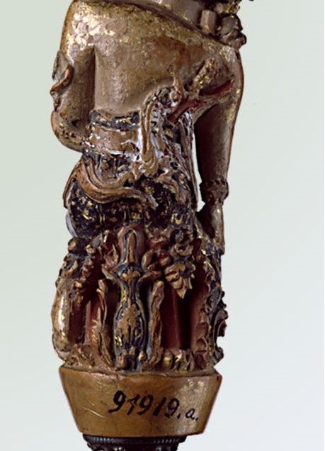

The oldest sheath with provenance is the other one from Vienna, first mentioned in 1607.
The hilt figure of this ensemble has a Keris at the waist, a clearly pronounced Ladrangan, as flamboyant as one from PBX era. It is of course no proof a Ladrangan like that existed in real life, as it is true for many elements in Wayang depictions. Yet the idea of Ladrangan was present.
(Try to carve a Ladrangan in wood and then in Andesite. You will experience the artistic limits of the material.)
Stylistically the carving of the figure shows a strong Majapahit influence or even could be Majapahit.
A good comparison to the Gambar of this sheath is Keris, depicted at the back of a Bhima-Kertolo statue from Museum Nasional, 15th cent. The point of Gandar of the sheath shows an embellishment at the same place where Keris Nr. EDb 24 from Kopenhagen (Jensen's book, page 69) has a floral carving. This Keris, blade and sheath, could perhaps be one of the oldest preserved.
As a conclusion - we absolutely can't rule out a possibility to still have a Majapahit sheath around somewhere.
