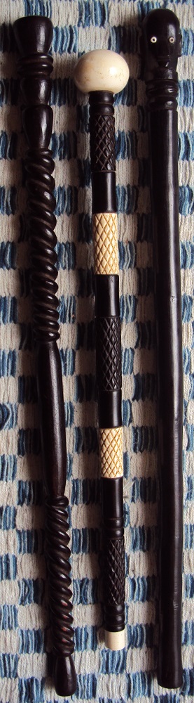

Question Zulu or further north?
I purchased this today from a Zulu material collector. He states this piece as Zulu. To me it looks more like work from further north like pieces from what is today Malawi or even up to the Ilemi triangle? I wonder what others might think? The item is heavy, the wood and ivory are built up on a metal rod most likely iron. The ivory does not have matrix of lines as in elephant ivory so I presueme it to be hippo ivory.

Posts: 363
I think it's from further north, as the carving and the manner it was executed do not look right to be Zulu, at least in the numerous pieces I've seen and handled over the last thirty years.
The metal rod is not typical of any of their clubs. I've seen North African and Indian walking sticks that are carved and constructed like this, but never a knobkerrie/iwisa.
The ivory ball is way too big and solid to be hippo. It appears to be 2 1/2" or larger in diameter. Have you tested it? From the photo, the color looks a little grey to me, possibly fossilized bone? If it's not elephant or bone, I don't know what else is out there that grows solid teeth or tusks that large.

Posts: 6,032
Many thanks. I am now certain this is most probably from Nyasaland. I am not at home to show it with others. I am now able to give some measurements, just under 47 cm long and a knob diameter of just over 4 cm. So that could well come from a hippo incisor.

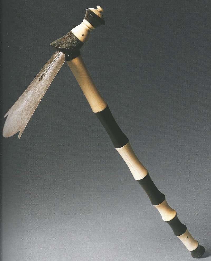

Posts: 6,032
This is the best example of the same style of artwork and construction I could find in my books. Although I put it further east, it is north and nowhere near Zulu. The work of Lozi people in what is today Zambi. The adze in the picture is 45cm long the same as my new stick. There is the same carved waist to the wood elements though not as pronounced. The picture is from "The Art Of Southern Africa. The Terence Pethica Colletion, 5continents 2007"

Posts: 6,032
Under the right light it is clearly elephant ivory. Looks like I might be stuck with this one. That hurts so much .
