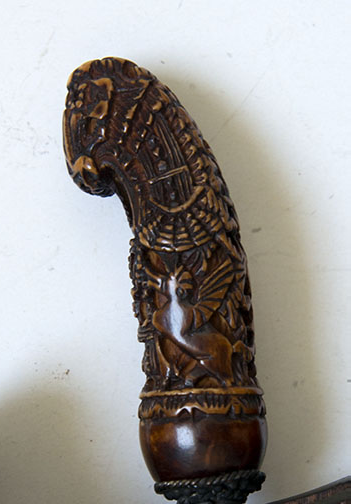

#1 |
Posts: 791
The Keris has an ivory Ukiran and a twisted core blade and Gonjo. I believe it is quite old and from Sumatra. Is it an Aceh Keris? Any comments are welcome.
#2 |
Hello Tatjana,
only the hilt and pendokok is from Sumatra, blade and scabbard are from Java, the tilam upih blade is indeed very nice, scabbard is sadang walikat style. The hilt don't belong to this blade. I would put the very nice ivory hilt on a stand and would look for a proper hilt and mendak for the ensemble. Can you show a picture how the blade fit inside the scabbard? Regards, Detlef |

The scabbard is in sandang walikat style from East Java, the ivory Jawa demam hilt from Sumatra, and the blade looks Javanese to me but I am not sure.
Regards PS: I agree with Detlef, and the pamor pattern on the sor-soran appears to be Lar Gangsir?

The blade is actually Madura Sepuh (old Madura), which of course makes it East Javanese, as is the wrongko.
Blade and wrongko are correct, just get an appropriate hilt for it, East Jawa planar would look good. |
#5 |
Posts: 791
Thank you all for your help!
The scabbard is original to the blade. I have an old Madura hilt which I can use for the Keris. Would it be OK? Alas, I do not have any East Java planar hilts available... |
#6 |
Posts: 7,229
Provided the size is in proportion it would certainly be much better than what is on it, but I would advise that you put a distinctly East Javanese hilt on your wants list.
