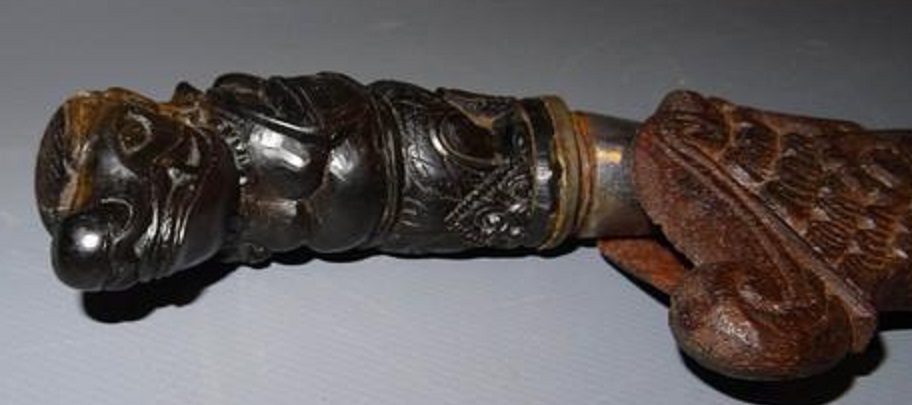

Certainly Sumatra, the hulu is that of Knives from the region too, see below.

Thanks for this comparison hilt. I was having trouble making it out from that one photo. Looks like it might be a makara then.
Hi Gavin and David,
The pics of the hilts are not very clear but I am not sure that they depict the same figure, the one from Gavin with the protruding nose depicts a popular hero from Bali/ Lombok area? but I forgot his name.
Best regards
Jean

Originally Posted by Jean
Hi Gavin and David,
Best regards
Jean
I believe this hilt depicts the character Umarmaya. As far as I know, this is a panakawan character in Lombok. On this site (German), he's listed as a character in the repertoire of Wayang Sasak (ethnic group on Lombok).
Thanks for your imput. Given the placement of this item it would seem strange to have a culturally mixed ensemble like that, but who knows. I would love to see some better images of this hilt.

I believe that when we get a profile photo of this hilt it will be found that it is derived from a wayang character, and that it has a big nose. In fact, we can just about see this now, but nothing more.
All kasar (rough, crude) characters in the wayang have big noses.
If we are to try to specifically identify the character shown in this hilt we need at the very least a clear profile photo.
Thank you Yuuzan.
Yes, although the pic is not very clear I believe that the hilt shown by Gavin depicts Umarmaya or Umar Maye as he has very distinctive features. He seems to be a very popular character in Lombok but very little is published about him. We already discussed it in September 2008 without much success.
Gavin, are you sure that your dagger is from Sumatra?

In fact the photo doesn't show much. From what we can see, the scabbard seems Madurese and the hilt could be Cirebon. A photo of the blade would help.
